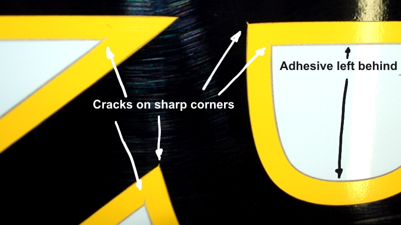

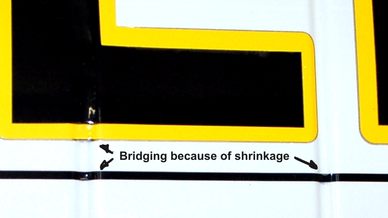

The pictures below are a prime example of why not to use calendard vinyl for vehicle graphics.
We removed these so I have no clue what grade or manufactures vinyl was used, but it was calendard.
(But we use premium cast vinyl)
The difference in actual cost of materials between the most expensive vinyl and the cheapest. is .75 per square foot. That saves you about $5 for a set of 2 color truck doors.
My 2 cents.

how old is that vinyl??? exposure to HEAT....from sun & temp range? the bridging you call it, is not from shrinkage but POOR INSTALLATION..... and back to temps.....black absorbs more heat then yellow.....so you will experiance some wrinkling or corner cracking.

looks like a good call on the calendered vinyl.
And it looks like some shrinkage caused some tenting too. OP may be right about the install. But, even if the installer did not stretch the vinyl when he installed it,, it will tent up over time on just about any ridge or valley.
I once saw a truck with tents over very single rivet. I also watched the installer use a heat gun to make his fits when he applied it on the truck.. After about 6 months they tented anyway and we razed that installer every chance we got for using cheap vinyl..

OP, I've been doing this long enough that I don't need a lable to tell me the difference between cast and calendard. Thickness was the first clue and the dirt ring around the graphics was the second.
It could have been installed poorly, but I doubt it would have made a difference. The yellow shrunk a 1/16th of an inch.
The point of the thread was to point out the pitfalls of using calendard vinyl for vehicle graphics.
