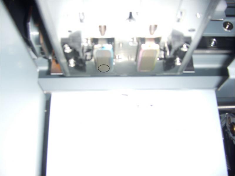

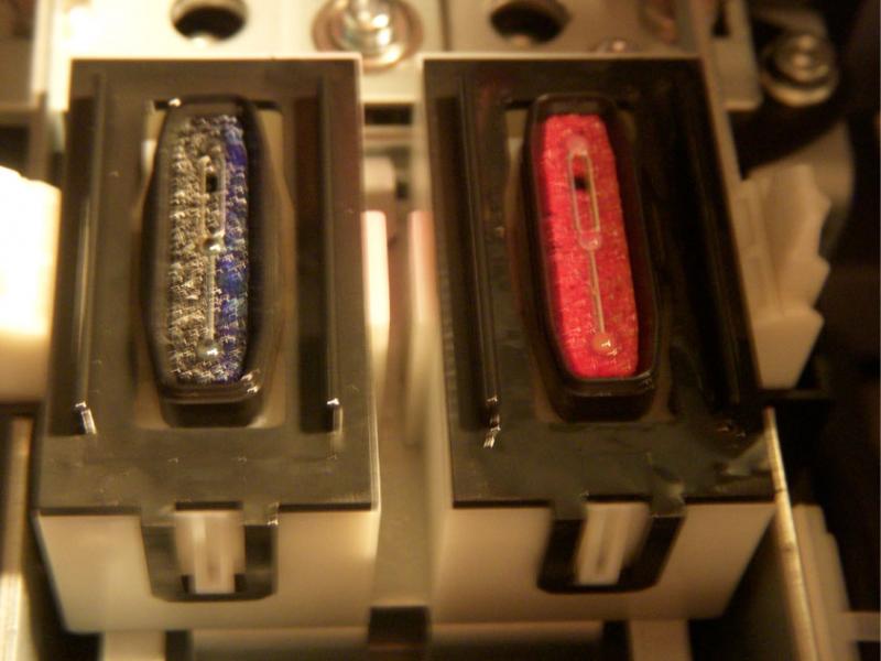

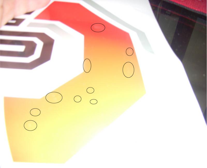

So i just got a this new sp300v last week . Everything has been fine... Went to start printing out a few different things and im getting a white"ish" color specs,dots,splatter, whatever you want to call it. I did a test print everything looks good, cleaned it like it said too but nothing... I tried to take acouple pics...Oh and i looked at the heads and they is a grayish spot on the one, i circled it in the pics...Can anyone help me? Please call me at 614-588-3054 Thanks

Either wrong profile, or on the head where you are saying, you may want to take a swab, soak it in cleaining fluid, and just hold it on there for about a minute, see if that helps. Maybe clogged, but it does look very clean!

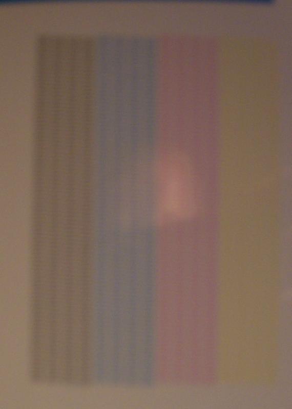

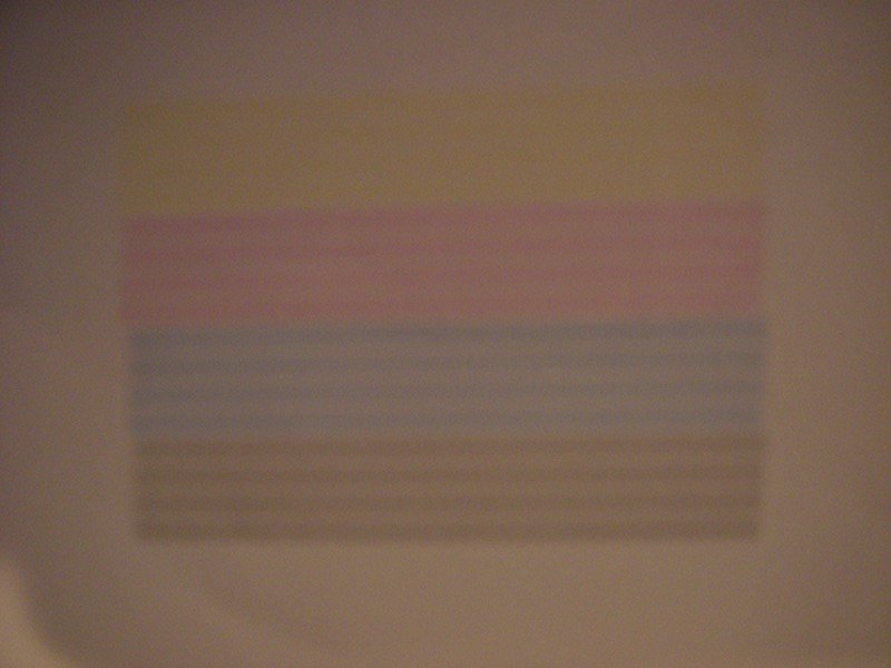

Can you post a photo of the test print? Does it look like all the nozzles are firing?
James605
Cant see to clearly cause the camera has auto focus that broken but looks almost perfect....

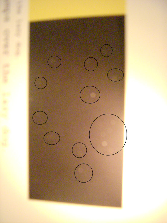

i printed 10ft of thesse logos and everyone of them has the spots.... and the test print from versaworks..the fours blocks at the top 1 each color. all look good but the BLACK there is spots everywhere in it...

Styletech maybe your issue. I think it's that along with a correct profile. Many think it's an issue with the machine, but a lot of times bloches are profile problems. Just my .02 cents.

As for the profile... the spots are random they are not in the same place, i printed 20 of them all dots are "random" throughout, could the head be messed up even though firing?

What I see are splotches (small areas that appear to be faded or appear to have less ink coverage). I encountered this only one time on my Roland SP-300V and it was a "contaminated media problem" caused by "cheap azz media" (Solvex). I have never had this problem using Oracal's vinyl medias.
