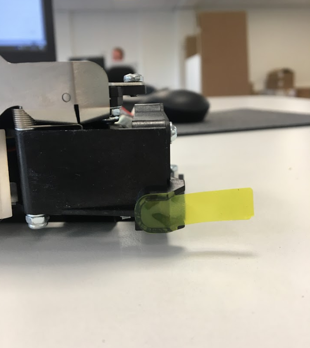

DrunknMonk
have you tried the trick with yellow translucent vinyl ? I tried it, it was better, but still a pain
