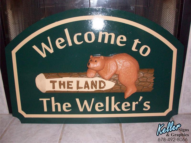

The panel is 1/2" MDO painted with One Shot enamel. I carved the bear and limb from 15 LB. Sign Foam. The paint on the bear and limb are flat latex paint. The overal sign is 2' X 3'. The bear and limb are aprox. 3" thick at max depth.

Nice job. It could use more air space at the bottom between the bottom copy and boarder. The bear looks good, nice colors too!

Now that you point that out, I agree. I should have used the negative space created by the lower case letters from the top line of copy as a guide for the bottom line. Instead I centered the copy in the panel.
I guess I just got in one of those "can't see the forest for the trees" places.:doh:
