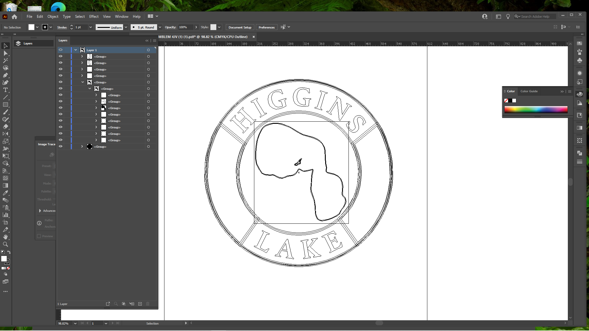

wow, that is a mess! your getting this from your "art" department?

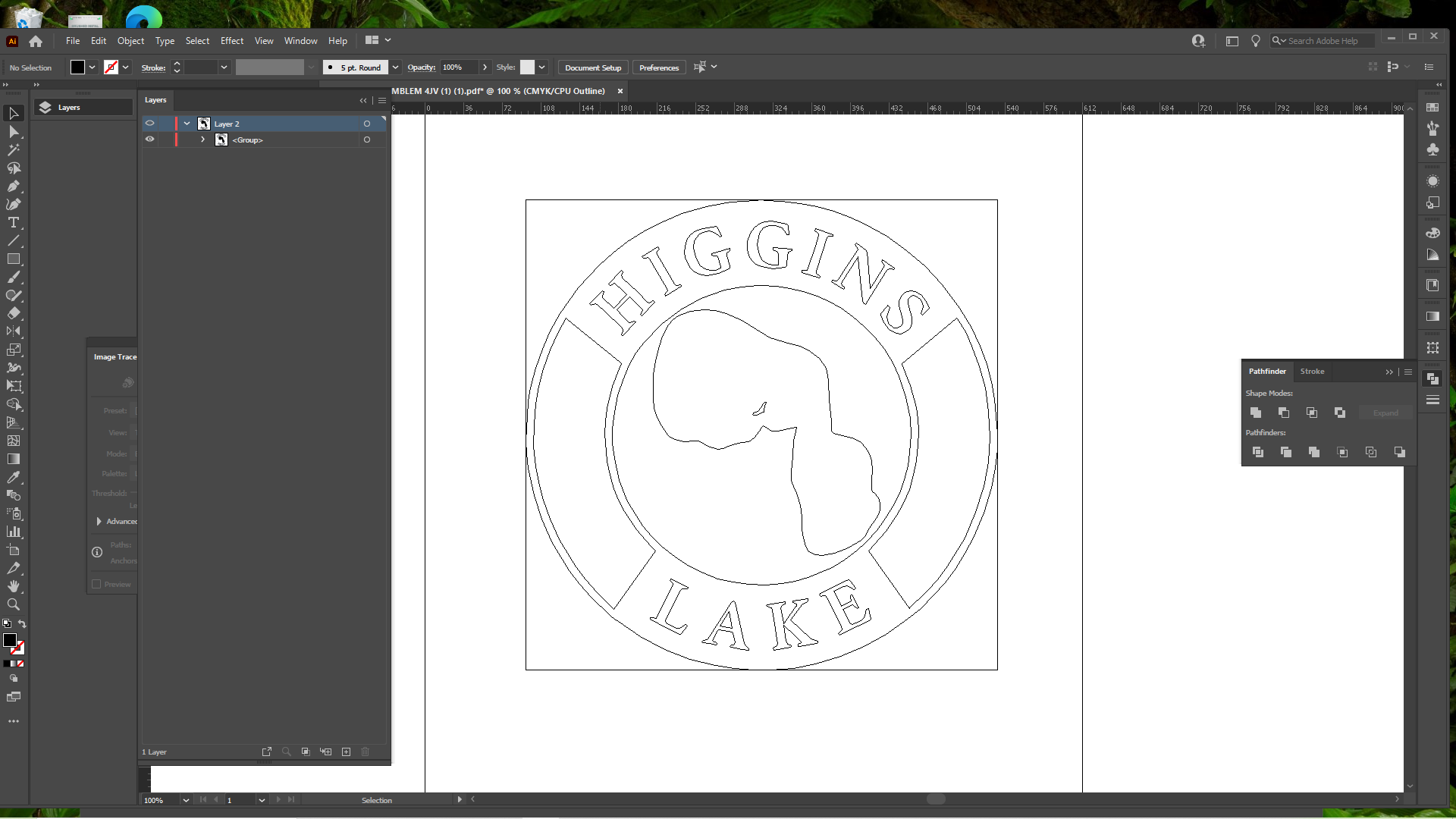

I opened it in AI, this is the outline view
So, I rasterized it, then I traced it, this is the outline view now:
I'm not sure what to say about getting better art from your art department. Other than get a new art department.
Good thinking, But I prefer to delete or weld objects. When you vectorize, should use the silhouette preset not the 2 colour one. that cace have white and black object on your artwork. check the layer manager. Saving PDF without page frame saves time for production too.
