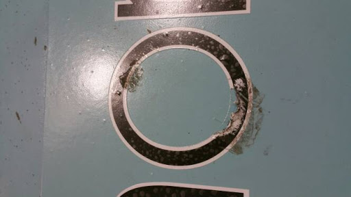

I did a laminated floor sticker along with some black calendered vinyl a while back. Then applied clear epoxy. After a few days the pieces with laminate bubbled up all over the place but the black calendered vinyl was perfect.

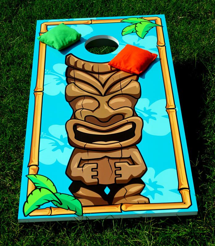

We made these with drops from 3/4" PVC. Ended up being a little slicker than a painted plywood board, so it ups the difficulty level, but you can leave them outside at the beach house and not worry about them rotting.

Yes I had actually let them gas out for 3 days before laminating. Just the epoxy itself would not bond to the laminate and the result was tons of bubbles. Here is a photo. Ignore the scuff marks that came from a Hi Lo running it over.
What kind of laminate do you use?

Oh ok, I assuming in was gloss too? Just wondering if a matte laminate would help the epoxy adhere... or maybe even scuffing the gloss laminate with some sandpaper before applying the epoxy?
getcustomized
Hmm IDK thats a great question. Yes this was glossy laminate. The matte may make a big difference. Also scuffing might do the trick. Either way, let it sit for at least 3 days to check for bubbling.
