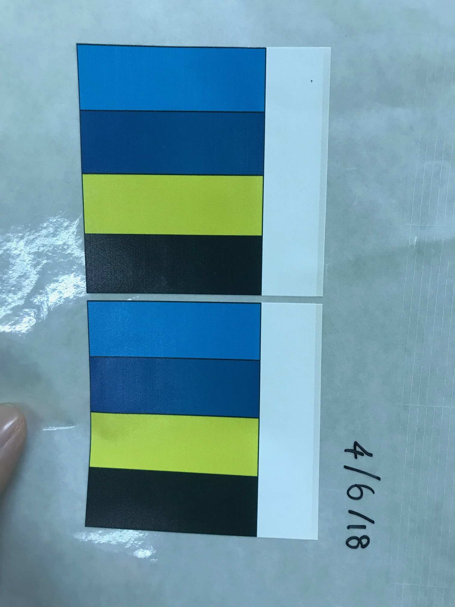

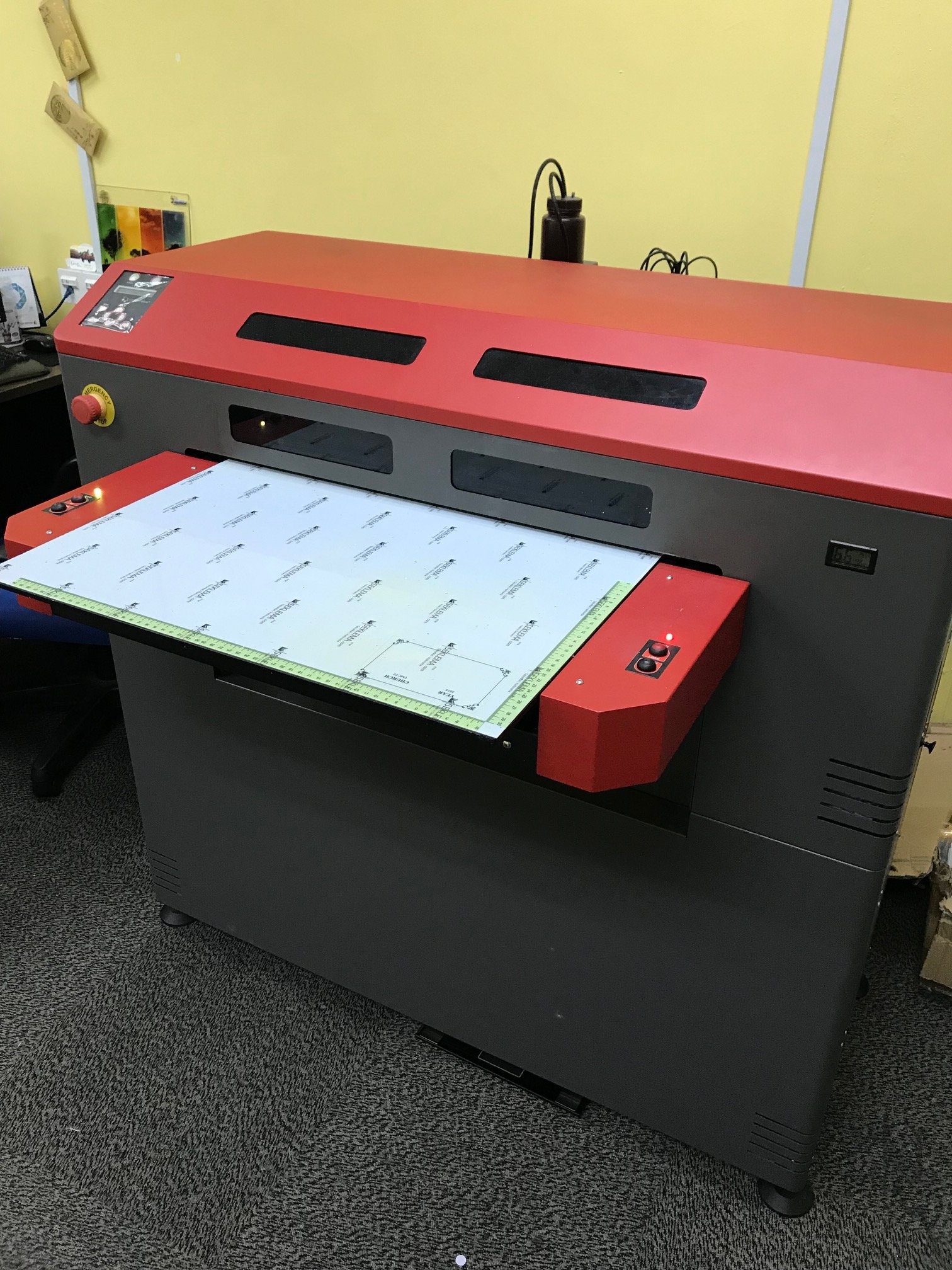

I am owner of Compress IUV 600s , i am based in Malaysia. My advise to all the printers that need to buy UV flatbed printer, DO NOT PURCHASE the COMPRESS IUV 600 or 1200. It is highly unstable, high maintenance cost and totally not worth at all. My dealer in Malaysia (TRUF Sdn Bhd) doesnt even know how to fix the machines. Just got my printhead replace 3 month ago , and print for a while, then the magenta print out Cyan . They tell me need to change the printhead, it was like just 3 month and the printhead have no warranty at all. I totally not recommended this machine. It better to go for Roland or Mutoh for better stability and low maintenance cost. I already send Compress.net messages regarding all these problem. They choose to remain silent about this. The machine in my office now is like white elephant.
