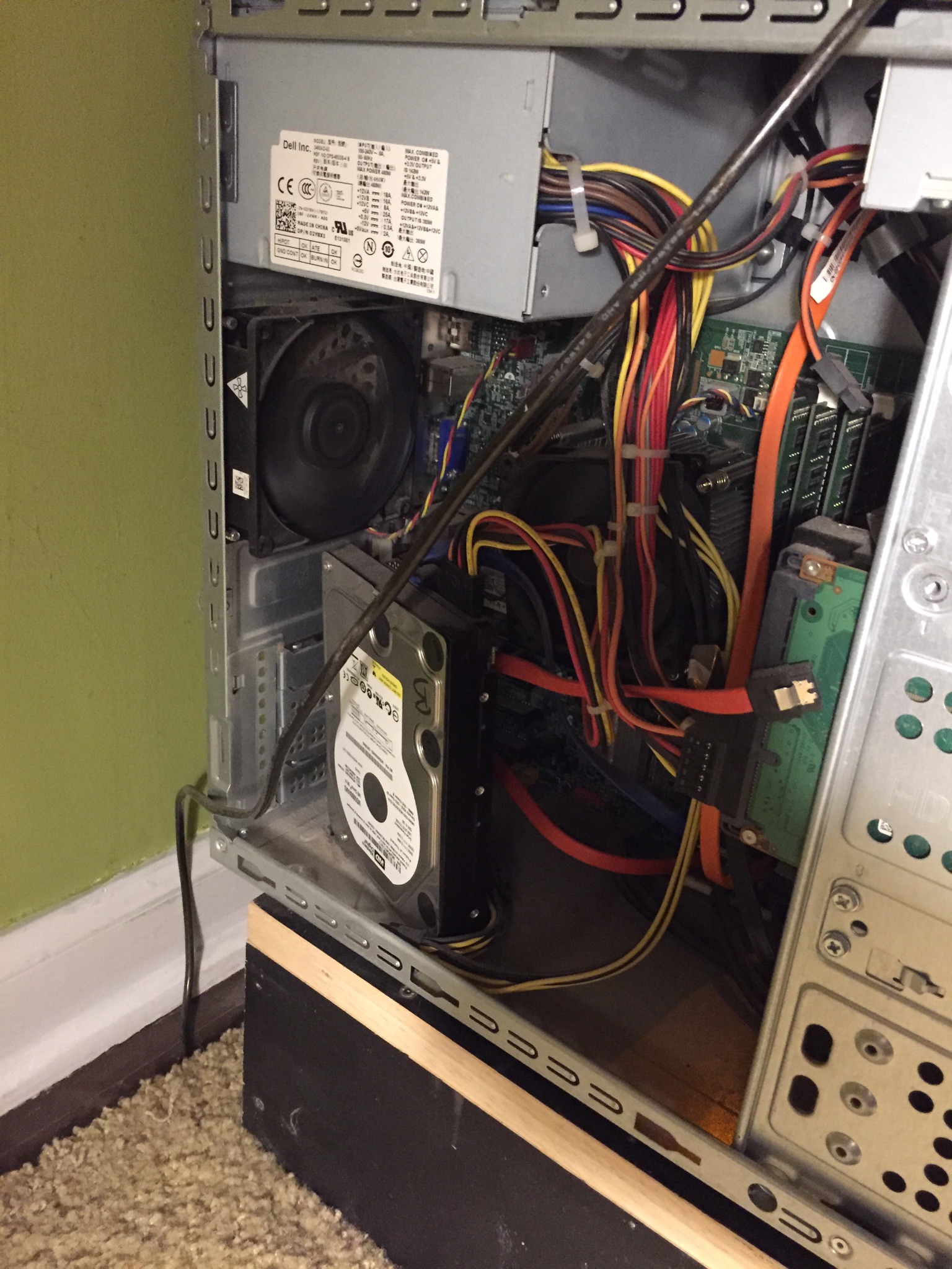

visual800
Sounds like you have a nice backup drive! youre gonna need it anyway. Matter of fact I would back up to 2 or 3 more hardrives just in case
