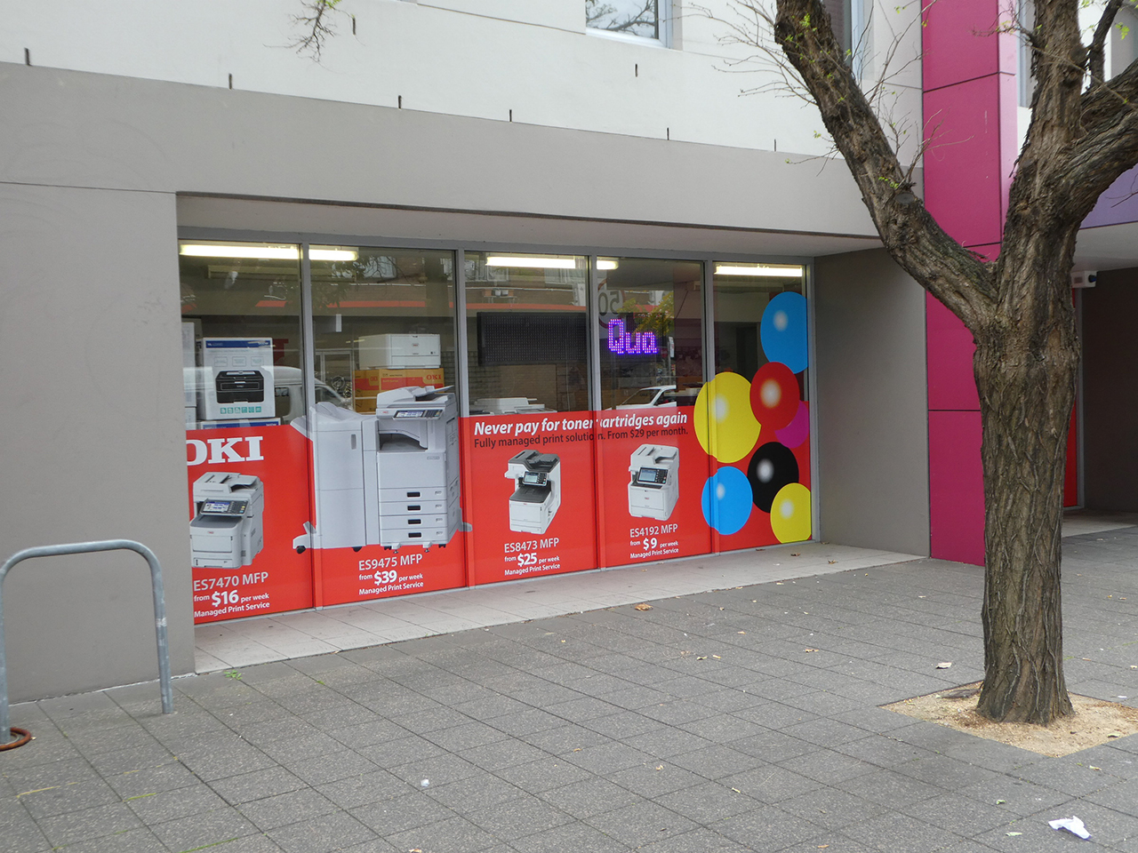

We've done it a few times.
Of course it's a lot of extra work but can look tidy if done properly.

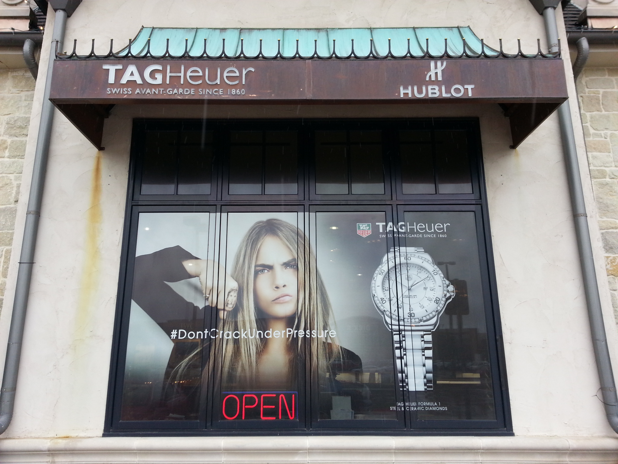

It's not particularly difficult and in a lot of cases it makes it look pretty good. I've done it a few times - below is one example. The mullions on these particular windows are pretty shallow, but even with deeper ones, it provides a more 'complete' look in many cases.
