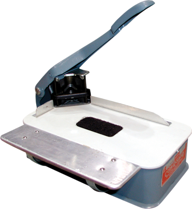

I use this too, Even makes clean cuts after I mount the adhesive, then I nip off the sharp corner with a corner rounder.
what kind of corner rounder? I be to afraid to try mine.
mpn
You can use that corner rounder if you want, no problem.
1/2 inch die in mine
gabagoo
yea I tried not only cutting the composite but the corner rounder too....sweet.... save a lot of time and no more imitation rat poop all over
