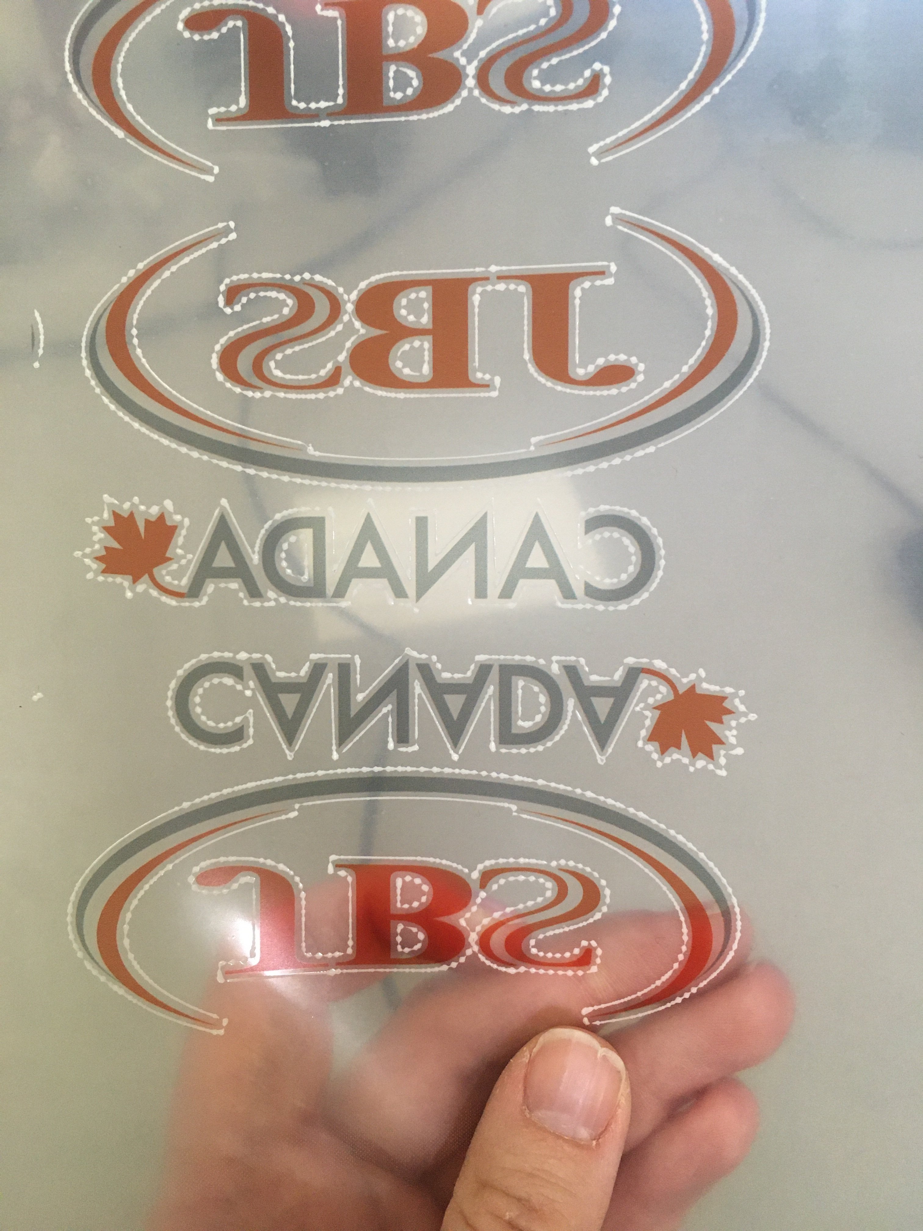

I have a few questions regarding the cut lines when cutting on the material in the title.
I use a Versacamm SP300i with a 60 degree cutting blade. On SuperTEK clear, I get cut lines that are perforated and although it's not impossible to weed, it's a little aggravating when before, I could get smooth cut lines but I don't know what I'm doing wrong.
To make it weedable, I cut with 110 gf of pressure (at 30 speed) but I do remember doing it at about 90 gf with nice cut lines. I'll attached pictures to show what I mean.
It's worth noting that it's only this material that does it, everything else is fine.
