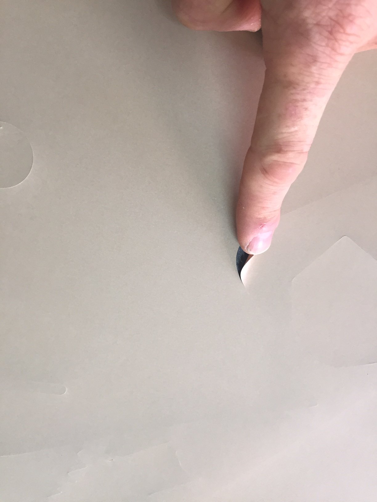

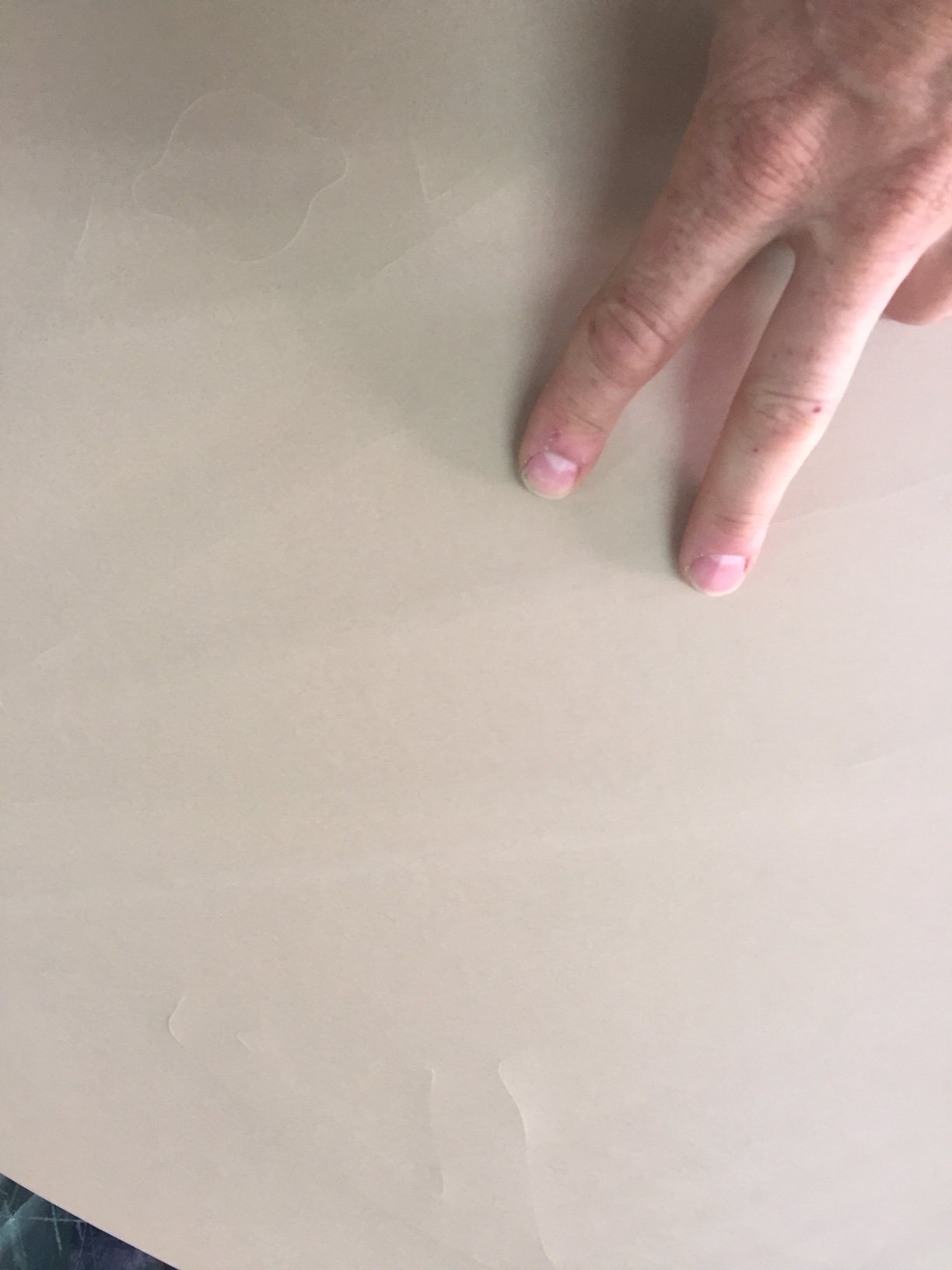

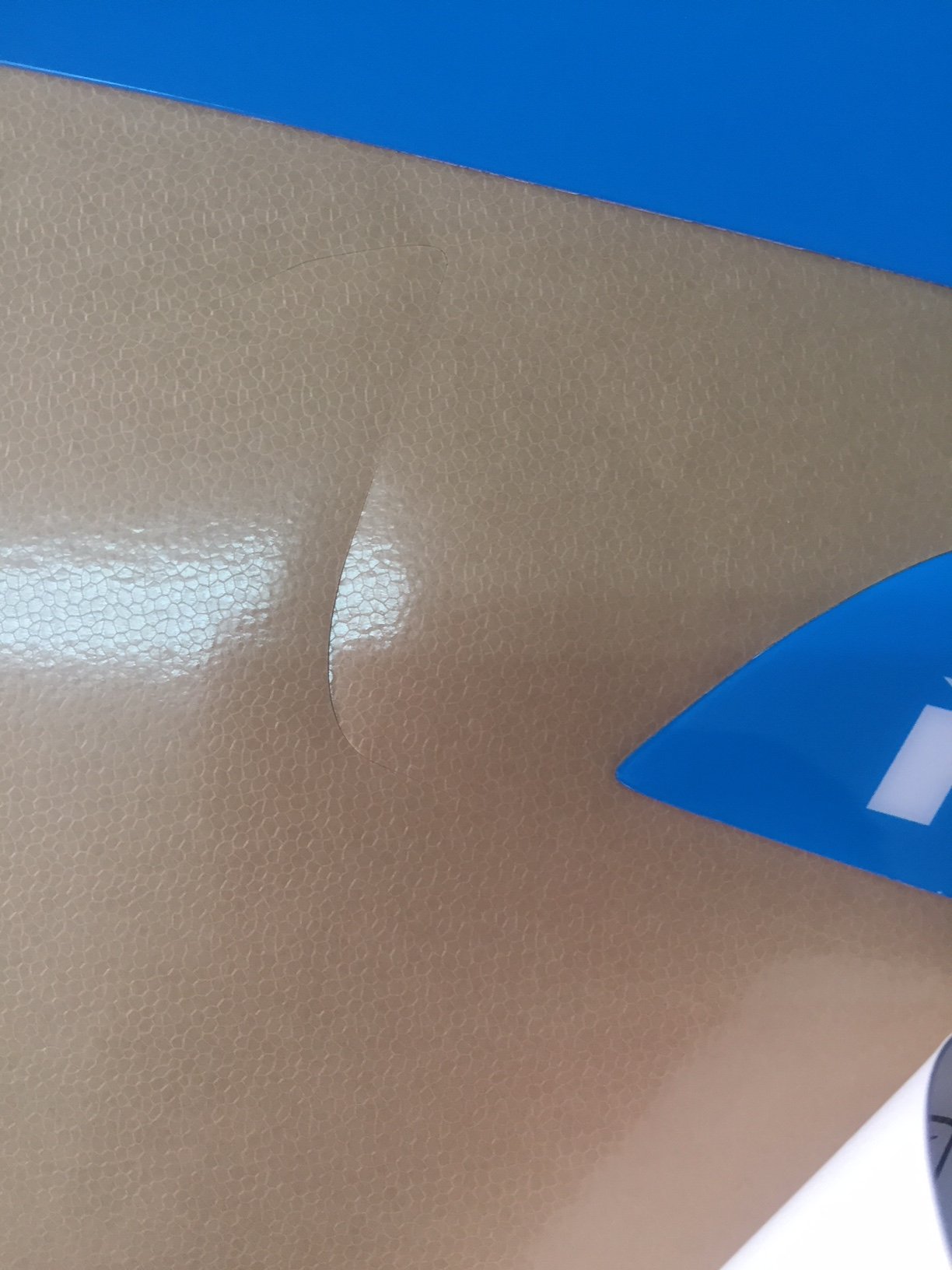

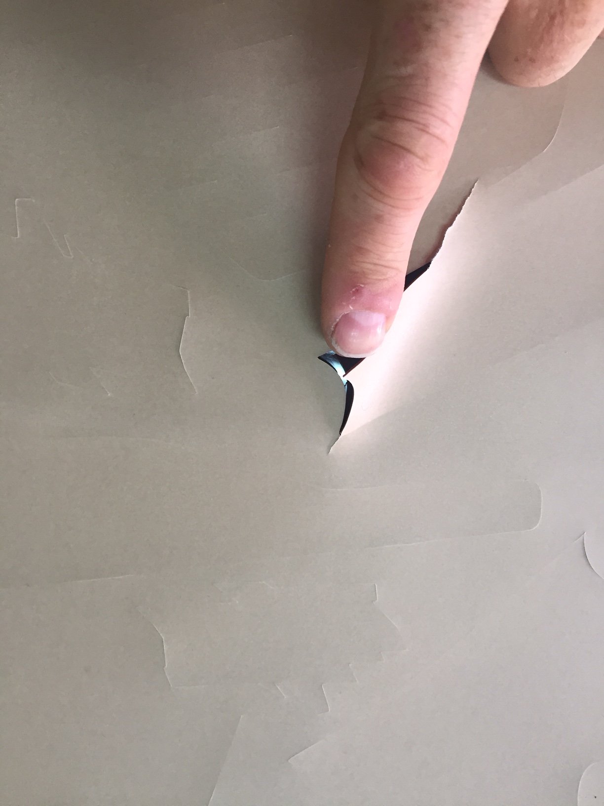

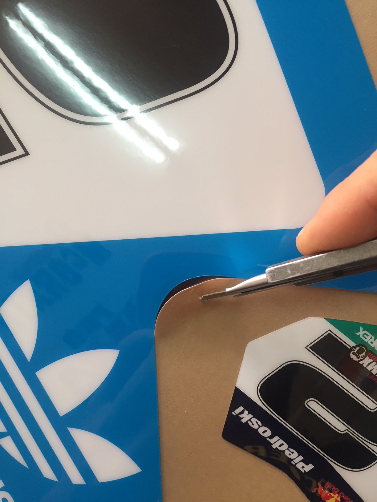

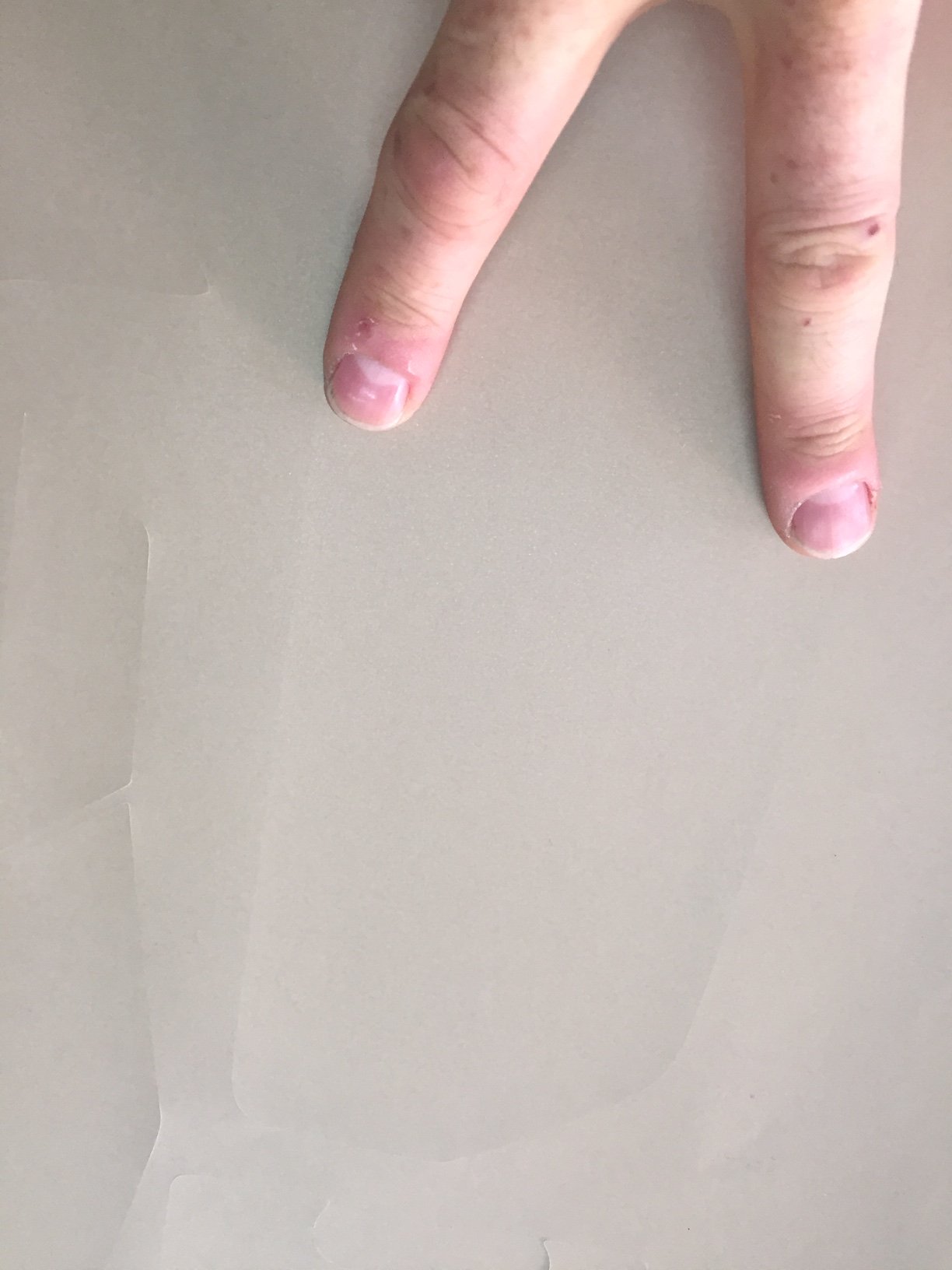

Hello
I have problems when calibrating the cut length of my summa S CLASS TANGENTIAL.
When I cut thick MX material, there are areas that the cut deepens more than others.
The slow, curved zones, with the same pressure and speed and in the same file, cuts them much more, cutting even the rear liner. Whenever the tangential cut rises and falls, does it use the same force ???? Use more force in the slow zones than in the fast ones ??? Use 450 of force and a speed of 300 with blade of 60 degrees. It is necessary that the wheels of the nose when making the cut, touch on the vinyl ???
Thank you :)

You have to reduce the knife depth. The knife must extend out of the nosepiece the minimum necessary to cut the material (slightly more than the thickness of the vinyl).
In this way you can increase the pressure as you need without the risk to cut through the backing of the vinyl
AF
If the above doesn’t work, replace the blade with a new one and test. If that doesn’t work, you may need a new cutting strip.

The blade will cut deeper in the slower zones simply because it spends more time on the material than it does on the faster areas. You might try to lighten the force a little and see if you can't find a middle ground where it will still cut through the material in the fast areas without cutting all the way through the backing in the slow areas.
AF
I have run into vinyl that was not the same thickness across the width of the roll which made finding the best pressure impossible. Thin areas would cut into the liner and thick areas would not cut deep enough. If the machine checks out, it could be the material.

WOW! What kind of material are you cutting that you have to change the blade 3 times a week. We cut anywhere from 10k to 50k labels and decals a week and go months between blade changes. The blade should only stick out about the width of a credit card. The force you set it to will determine the depth it cuts.
