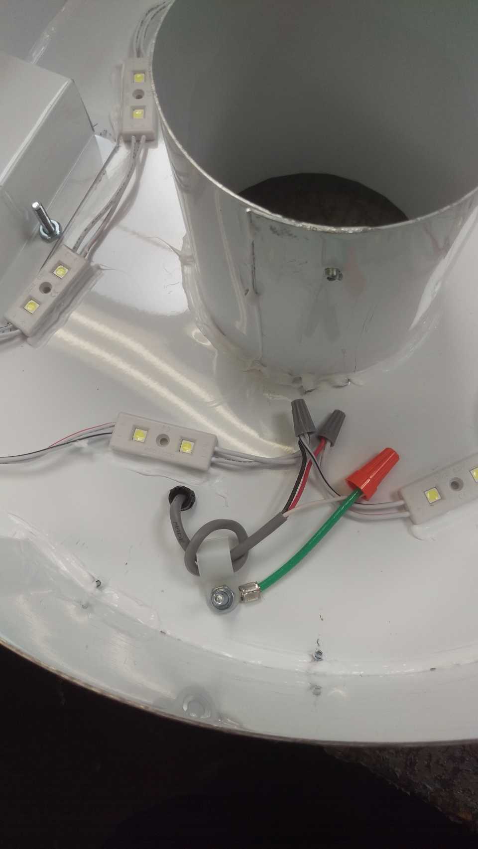

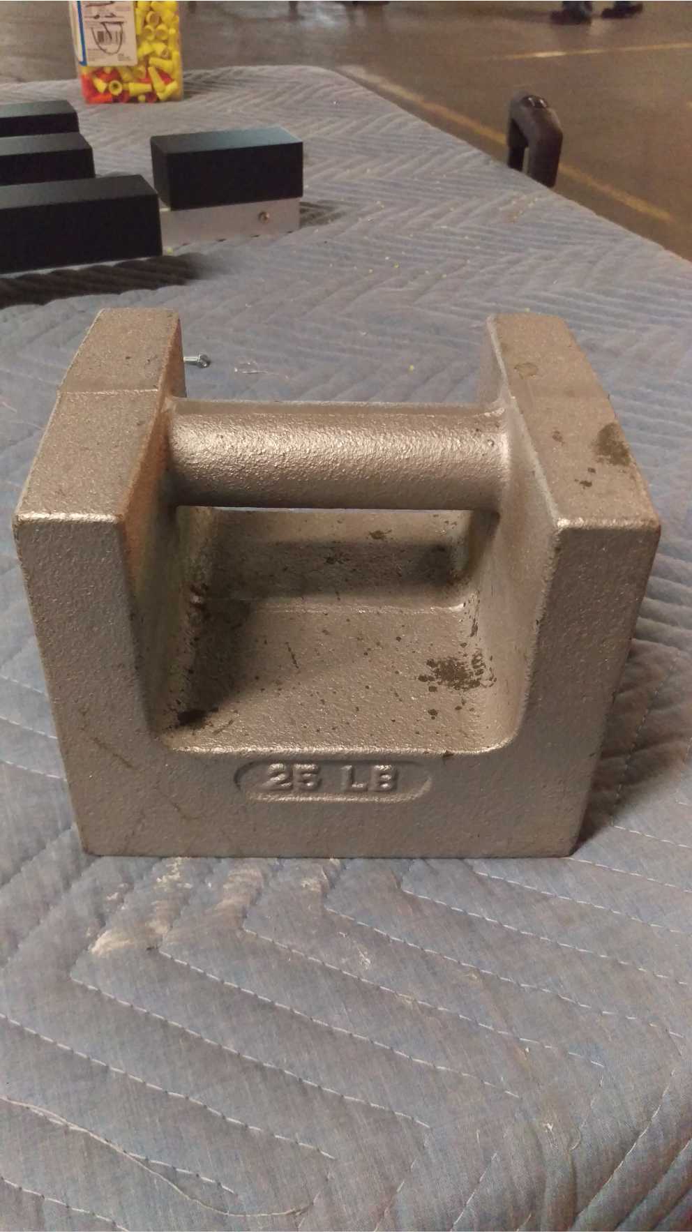

Hello SignsPros, the problem is these inspectors took the same online course you did and that's all they know and probably can't explain what the procedure is. Here are some pics to help you out a bit. I'M sure you can Google all the information you need to get your self going.

Hi Sign Pros. In my experience you basically tie a knot in the wiring in side the letter or cabinet and leave enough wire between the know and the connection to eliminate any strain on the connection when you attach the weight. You don't have to test every letter or cabinet but you need to have a process that if tested will pass. The certification of the weights is a simple thing. There are companies in most area that do this. Here is the link to the company that we used in my former life - J.A. King Greensboro, North Carolina Calibration Laboratory
