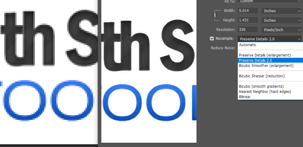

Also when all else fails take it into Photoshop, flatten it if it's got transparency, make sure there's a little white space around the logo (Image/Canvas Size) and then Image/Image Size. Resize it using Preserve Details 2.0. For things like sponsor signs that people aren't right up against it's practically magic -
Usually if I'm doing say golf sponsor signs I can get over half of the otherwise unusable logos good enough to use in about 30 seconds per logo.

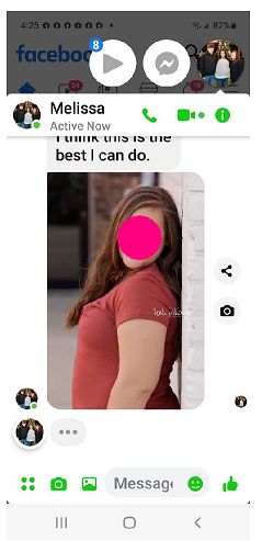

Here's a screenshot from someone's phone from a few minutes ago. I should blow this up for a 2'x4' banner and remove the watermark. NOT.
Boudica ...here's your screenshot, she literally sent me this as a screenshot from her messages, didn't even bother to save the photo and send it. I cropped it and sent her a screenshot of it actual size. I said it's very pixelated and I cannot remove the watermark. I told her to ask the photographer, they are pretty good about sending me jpegs for senior banners. On the phone I gave her my email and told her I needed an original jpeg emailed, not texted. She acted like I didn't know what I was talking about LOL
