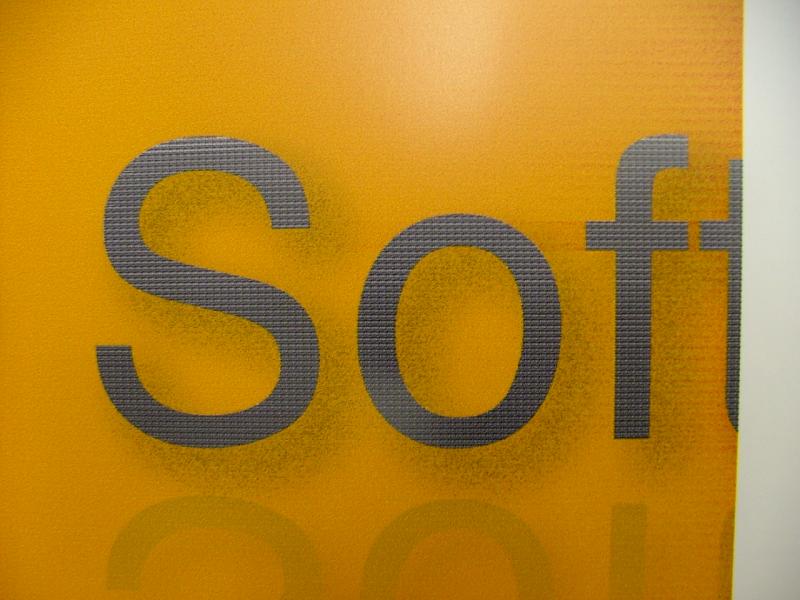

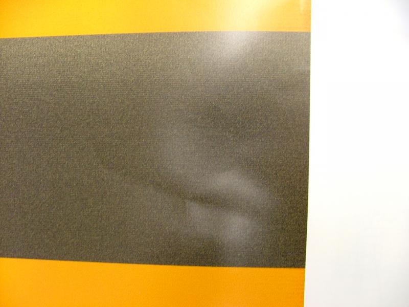

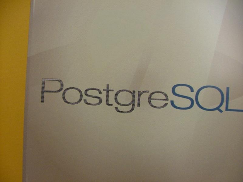

The issue occurs when running a drop (2.4 mt) with only a small area of black, this patch being say just half way down the print, the cartridge takes a few swipes to get going, but even then it never properly puts down the full density of black, on prints where the black areas are more distributed this issue does not occur.

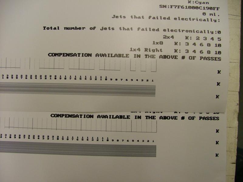

Images attached show, on 'more black text,jpg' that text should be black, you can see the first few swipes have even less density. The prime is before and after a 2.4mt drop. The second image 'Soft' should also be black text.
The jets are'nt blocked or failed, as you can pause the printer, dab a moist lint free pad on the carts jet plate, and away it goes fine, until it has a long interval in printing any black - then the problem returns.
