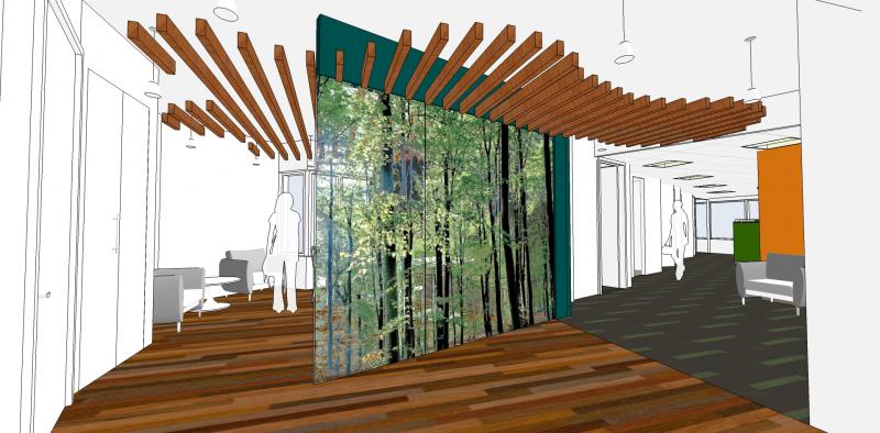

That is what I was afraid of. Yes some of the image is cropped out based on the architects rendering, which looks great on paper......I have never experienced printing anything this large from something that small. Even if they purchase a photo from a site that sells royalty free images, a Extra large image at 300 DPI would still be not acceptable. is that correct? How are you guys printing large pictures at acceptable quality. We are a Tinting firm that does a lot of decorative frost and films , many are custom cut designs. If you have every tried to cut window film, it can be a nightmare.....3m dusted crystal & Frosted Cyrstal and Avery etch are a breeze to cut compared to some of the other products out there, we also do a fair amount of architectural di-noc. anyways got off topic. We have done quite a bit of custom printed glass and wall wraps since I have been here, but this is the first project we have come across that needs such a large image, no text or design to it at all. I attached the rendering.

Does it have to be that photograph or can it be any image of trees? You could search stock photo sites and find a image with a better resolution that is very close to that one.
