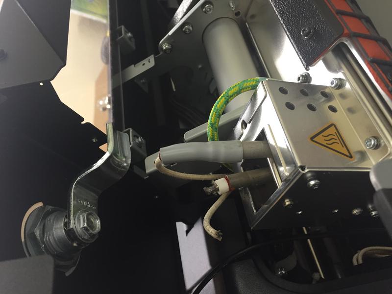

I just had to deal with this also. Turned out, one of the electrical leads going into the heating element broke. (See picture) I pulled the heater out of the printer, took a small drill bit and drilled down into the heating tube, tinned the wire with solder, stuck them in the hole I drilled and soldered it all back together. Just got it back up and running. I'm not sure how long the fix will last, but it's already running longer than it did before I took it apart. We'll see...

I had the 14.10 and 15.10 errors a few weeks ago, eventually it was coming on during printer start-up. One of the element wires pulled out of the sheath with a tug, so I cut back the white sheath (I did it to both wires at both ends so I could check all wires) and re-crimped. I also removed the p-clamp at the left end where all the wires exit, as it seemed to pull the element wire into a fairly sharp bend. Also cleaned the temp sensor at the same time.
A few weeks on and the errors haven't returned, touch wood.

Had this issue on our L26500. Yes, the electrical lead to the heater pulled out of the connector. Re-crimped, lasted a week and happened again. Tried soldering the wire in place, that lasted an hour....apparently that gets so hot it melts solder. So we found Hi-temp crimp connectors, stripped back more wire and reconnected. Has held since then. Really great quality control there, HP.
