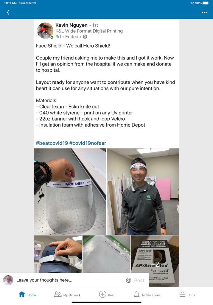

I'm including an example of what I am talking about. Please send along any input you have and please remember that this is not at all what we are set up to do, so bear with me on my lack of experience.

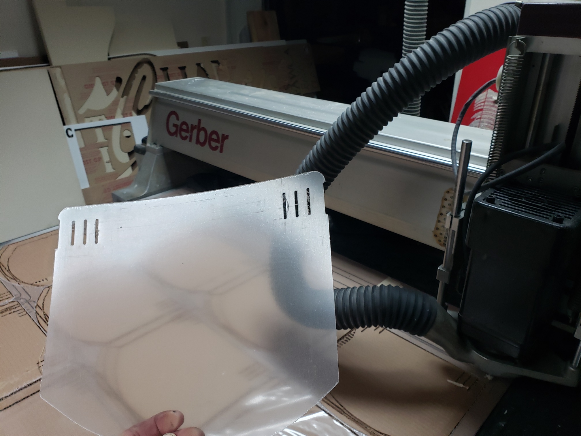

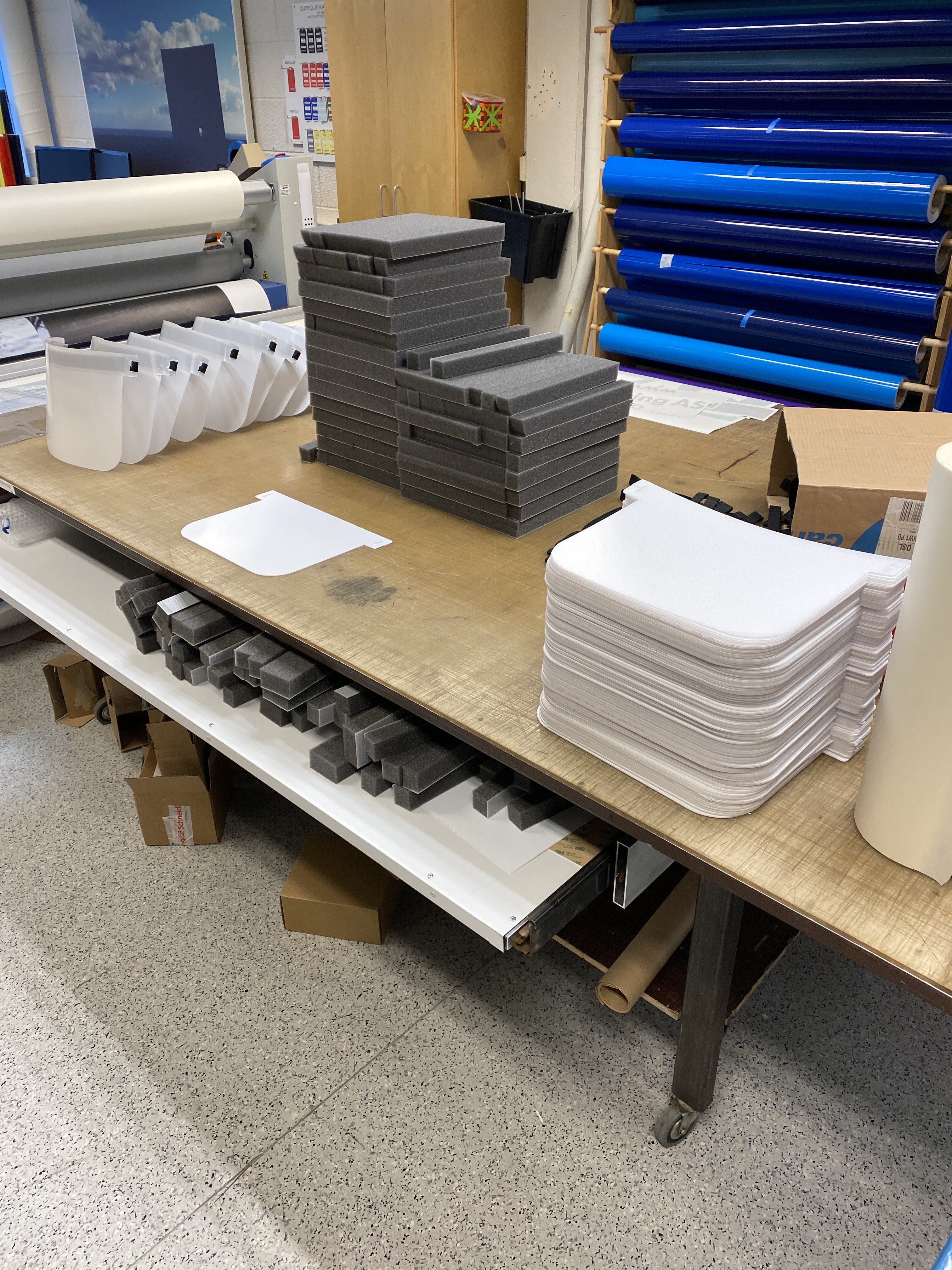

Our local Makers Space has actually developed this one. But they need to get their hands on PET 0.020”. Any ideas?

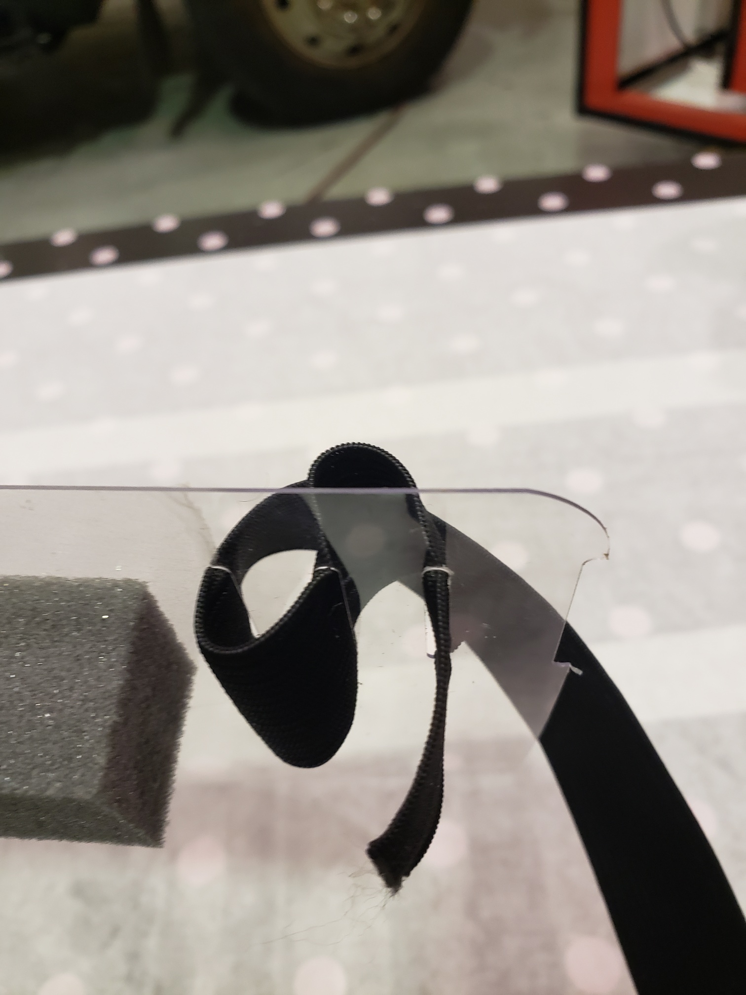

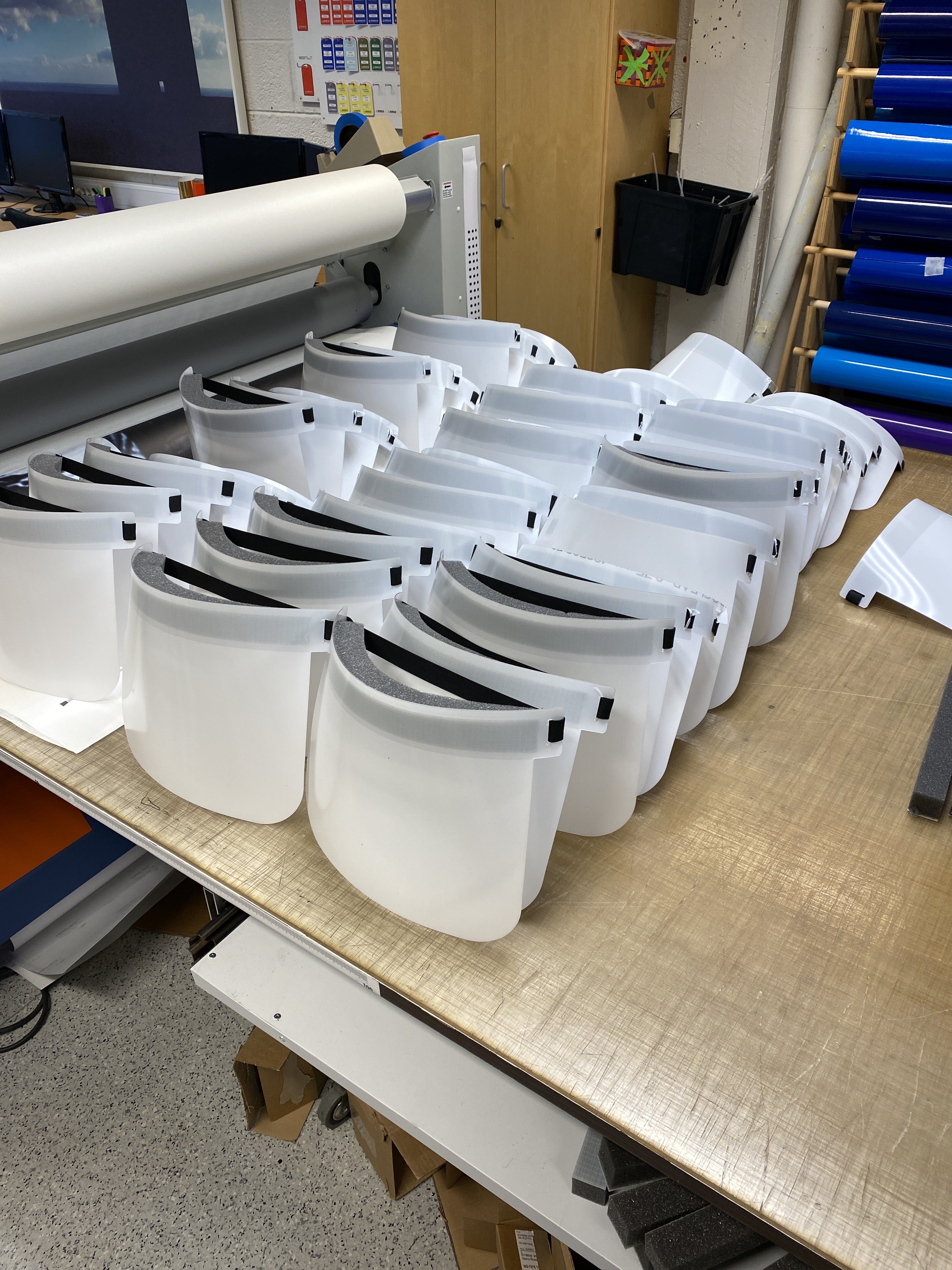

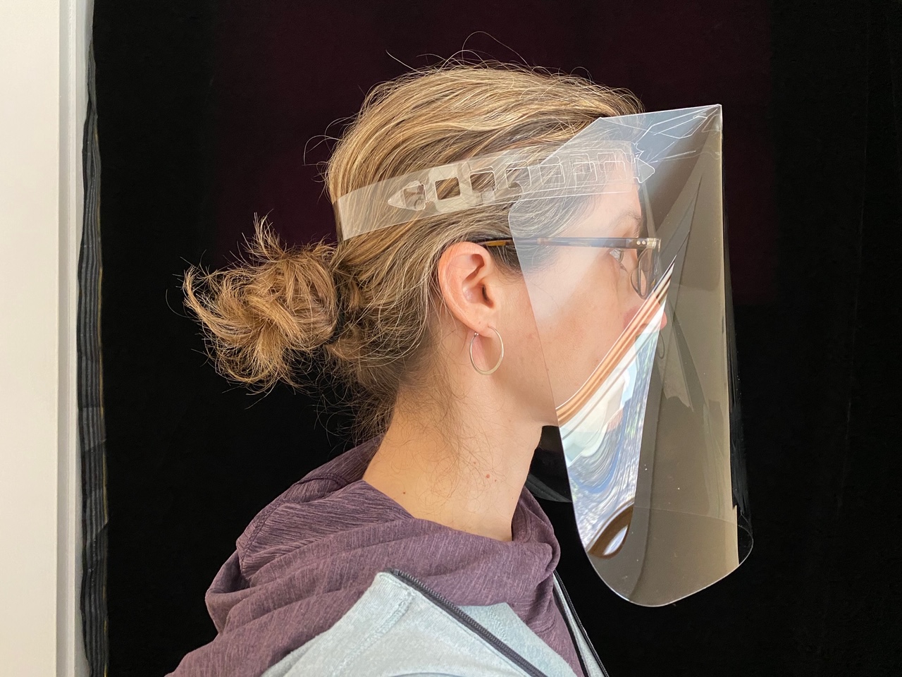

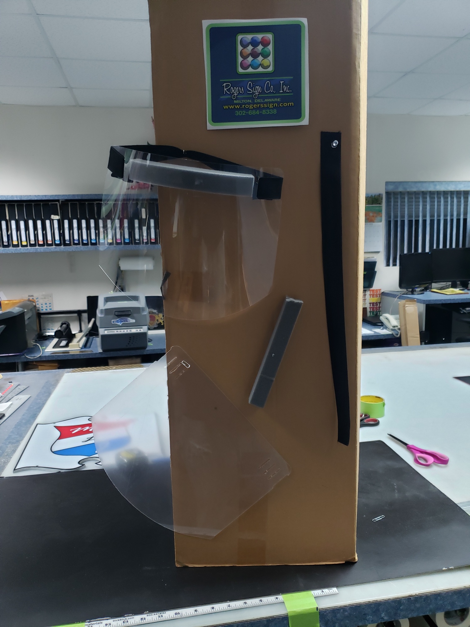

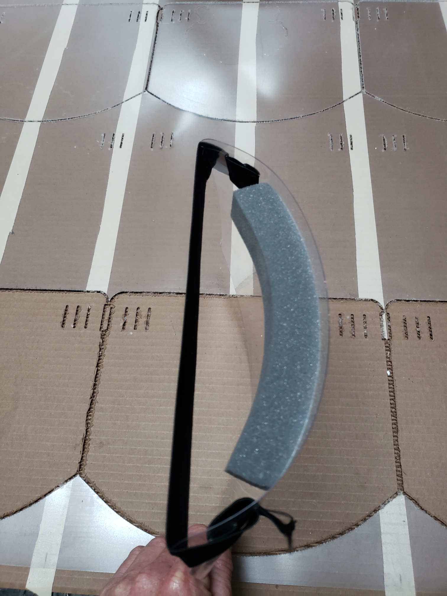

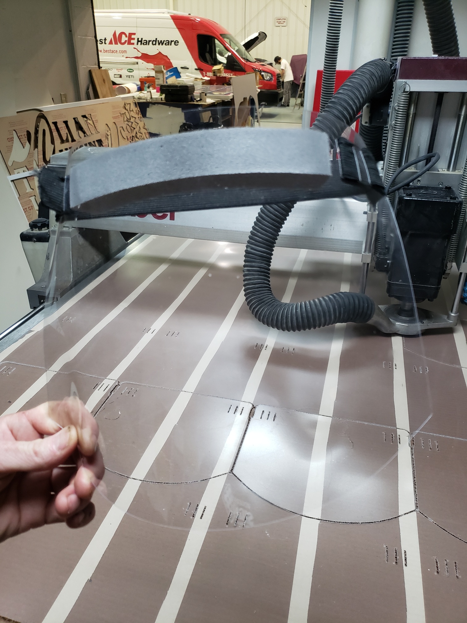

here is one I came up with pretty simple 3 pieces of material , .020 clear lexan, 1 1/4 elastic, 1inch upholstery foam, 3m77 spray glue I did a few prototypes and this is what I came up with, it takes my router about 30sec to cut one, 1min to install the elastic and 1min to glue the foam
We are ready to pump out 1000s of these, but can't track down 0.020" clear plastics. Anyone with any viable sources, please let me know. We want to give these away to medical and public safety workers, but can't make them without the plastic.

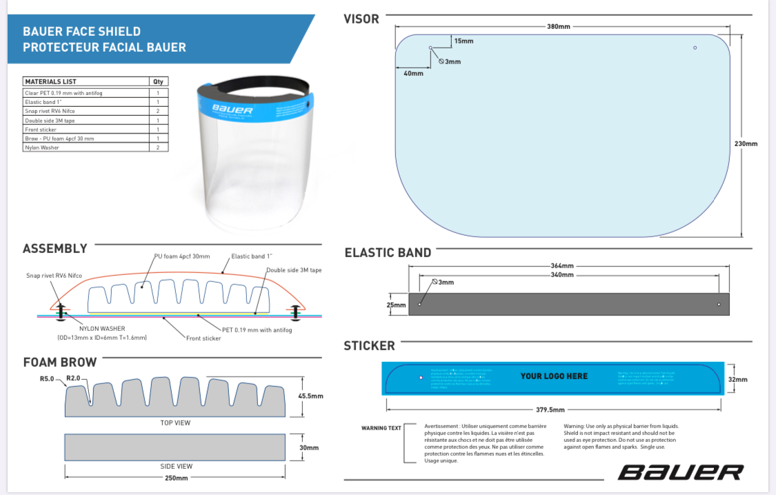

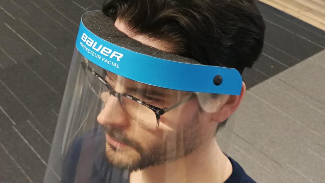

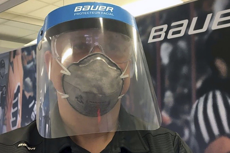

CCM-Bauer here in Blainville QC has stopped it's hockey equipment production to manufacture such shields that have been approved by the Safety and Health department in Canada. They already have 1 million of these in order and are basically selling them at near cost price. They have made their design free of use. They can be contacted to obtain the electronic files.

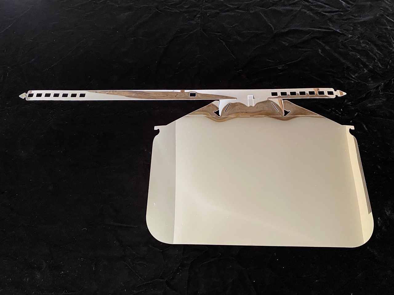

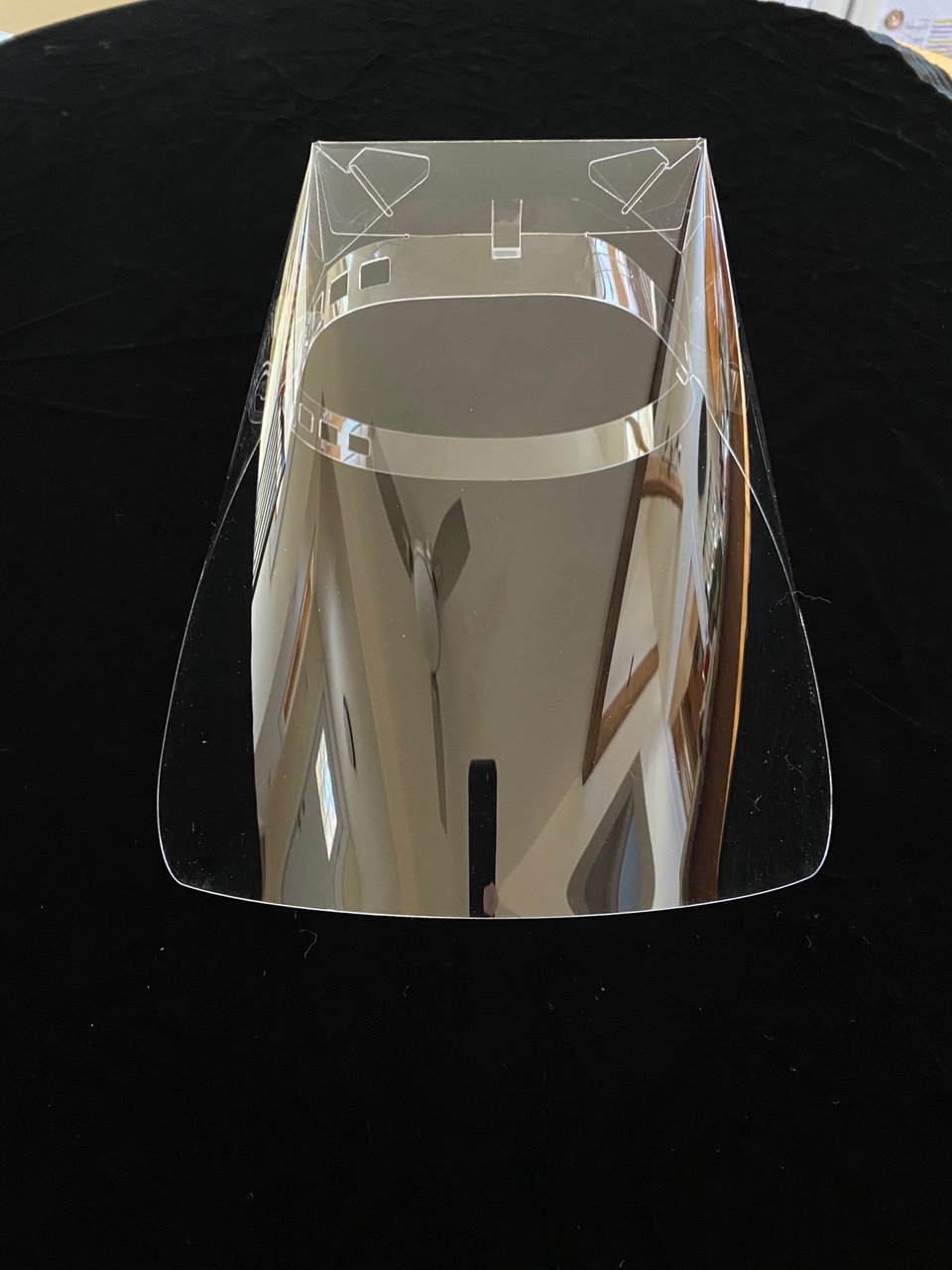

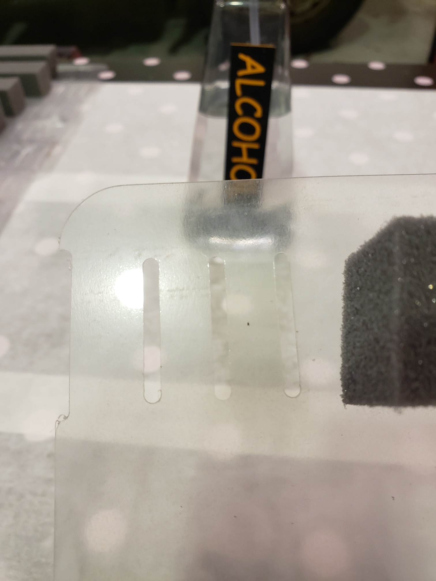

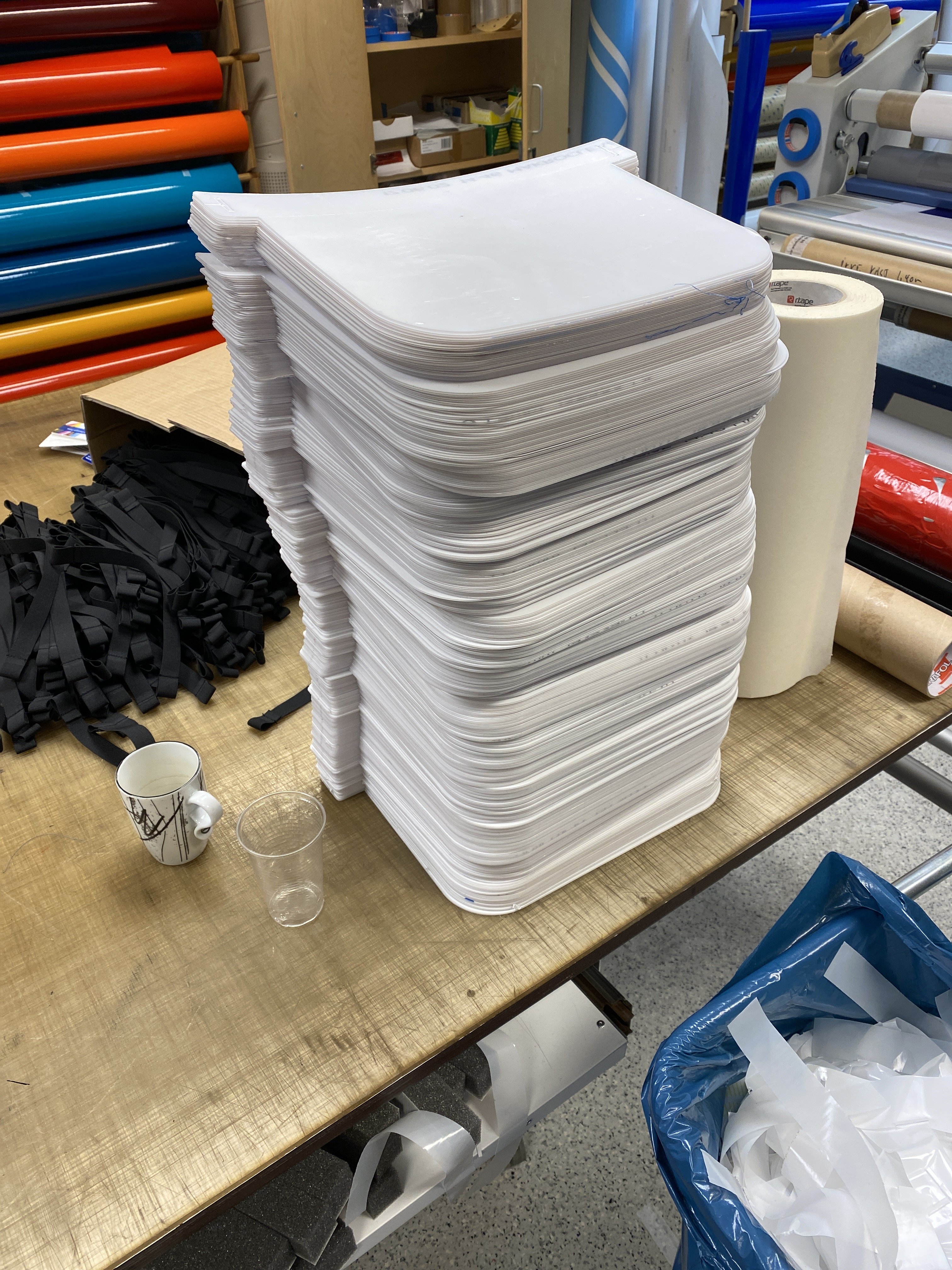

We cut them on the Zund with a knife (not routing). Can do about 300 masks cut per hour with on and offloading.
But its polycarbonate, not the thin PET stuff. We cloud probably produce alot faster with PET, but its a much more robust and better product with the polycarbonate.
