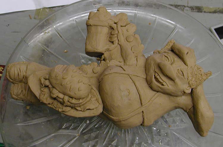

Here are some In Progress Photos of Fat freddie for a Sanfords we are working on. Kinda a Step by Step.. We will be submitting this to one of the Magazines once its all Complete in January.. This is just 1 part of a whole restraunt Project we are working on.

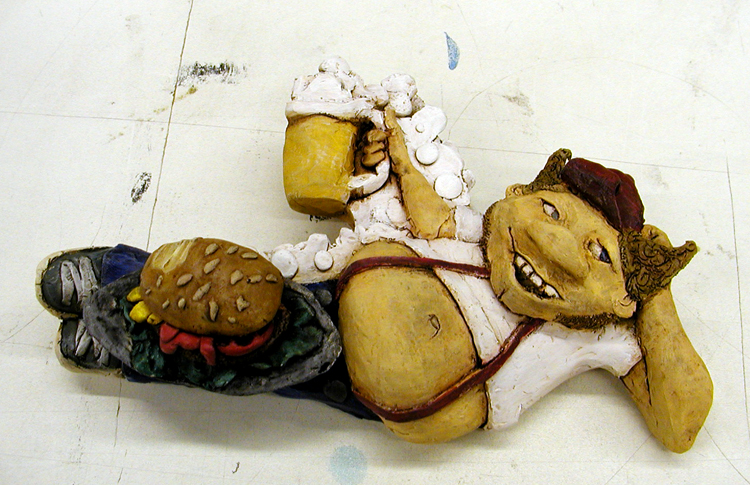

First we made a Clay Mock up.
Then we made a Mold and Cast him up in Resin.. This was a Quick Painted version we made.

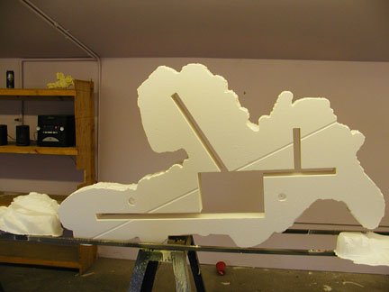

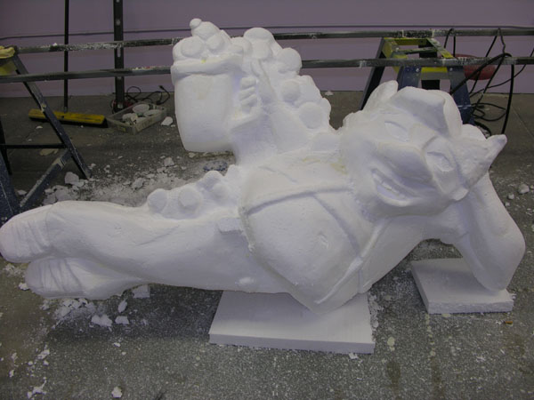

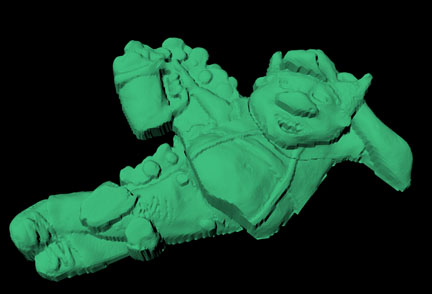

Then we Scanned him into the Computer. An routed him out in Layers
The cutouts are for a steel frame so we can attache everything together and a stiffener.

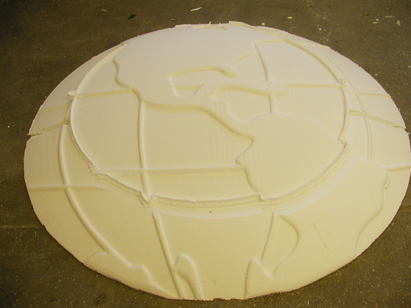

The Background that will have brushe aluminum Outline and this hold the whole sign together.

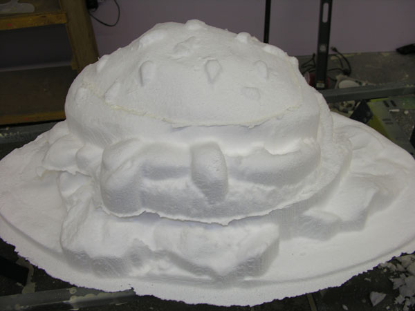

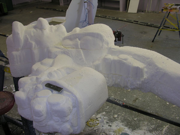

The Burger roughed in.
Shaping in and epoxy together.

Currently I am using an old PICZA Probe Scanner. But I will be ordering a New NEXTGEN 3D Laser scanner in January (Don't need anymore Tax writes offs this year) as the Picza takes too long to scan..(Litteraly Days) That will give us a Full 3D Model that we can work from instead of the 2 1/2 now. Should save us time on the Shaping.
