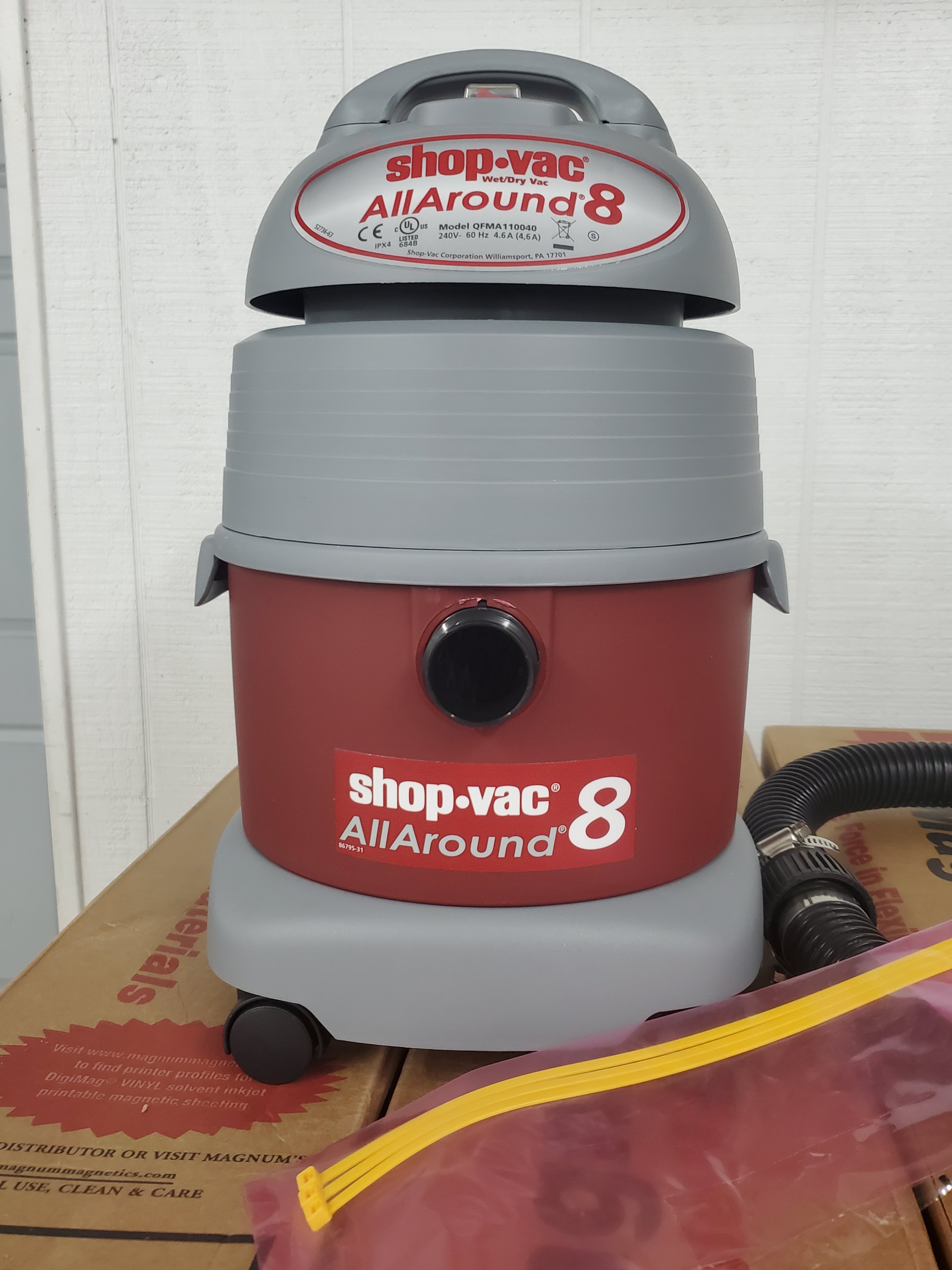

Received the shop vac replacement for the FB500 today. Wonder why HP used a 240 volt vac and not 110?

Is the user end / PC part not 120v? Fairly certain the electronic part is 120v... But I could be wrong
No? Well I can only repeat myself... whole system is designed for 240v.
At least that how is seems in the manual that there is no 120v option.

I was in the office today. There is 2 plugs... One 240 volt for the ink system / shop vac.
The screen and PC is powered by a 20 amp 120v plug. I only remembered because we bought a 240v ups for it...and I was annoyed I couldn't plug both ends into it and had to buy a secondary ups.
But I can confirm it is using 120v for the whole PC / user end side.

Hello. Did you ever find a solution for the shop vac that would work with US 110 power so you don't have to purchase the $550 shop vac from HP? Thanks
ikarasu
Sadly no. I didn't know it was just a shop vac before I got it serviced.
You can buy a 220v to 110v stepdown converter for $50 on Amazon - then plug a 120v into that. I don't know if HP has any software detection to block that... But I doubt they would. Amazon has free returns too.... So doesn't hurt to buy one, hook up a normal vacuum or whatever vacuum you have around to it and see if it throws an error. Worst case you're paying $10 to ship it back to amazon

Thanks for the reply. That is what I came up with too. Didn't find any posts that anyone has done this successfully, but the tech I work with says he has another customer that does it, but he said he didn't know how. Seems like it should work. Can't seem to find a vac quite this small, but got the smallest Craftsman ($35) from Lowes and the step down off Amazon, so will try it out tomorrow!

I searched high and low for a 220v shopvac and I came up with nothing, until I stumbled upon a page from the Philippines, 220v is evidently their standard voltage. Couldn't even find a reference to the model number when digging through legacy products and replacement parts catalogue. I wonder how nefarious this is, or if it was some engineer's misunderstanding that was solved by shipping shopvacs from overseas.

I don't think it was nefarious, most of the parts inside the HP flatbed are Chinese. If I recall it even uses the 220 volt Chinese plug, it's not just wires.
I believe there is 120 volt on the machine in addition to the 240 volt, but the way the machine tells the vacuum to go on is by giving it power, it's an automatic on/off system not a manual one.so swapping it over likely won't work... Unless you get really fancy with the wiring.
I think the best bet is to buy a 220 to 110 step down for very cheap and to use that. The only unknown is if the flap it will complain about the suction being different or if it somehow measures the amperage/voltage to turn the vacuum power up and down

I have purged 4 times and so far with no errors. Also have tested a handful of times with the vacuum test on the machine. Got the 1000W step down on Amazon for $59 and used the Craftsman $35 2.5 gallon wet dry vac (smallest I could find) from Lowes since the original one was 8L. Had to wire the plug from the shop vac onto the step down to work with the end on the printer, they do sell the same plug at Lowes, but didn't see it till after I wired it. Wasn't any big deal since the shop vac was burnt up anyway.
