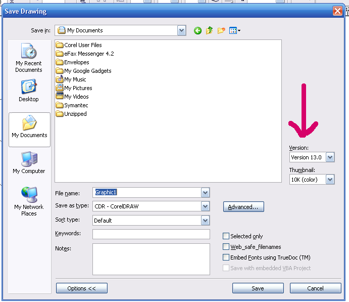

when you go to save, there is a "version" option on the right hand side
