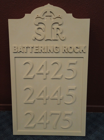

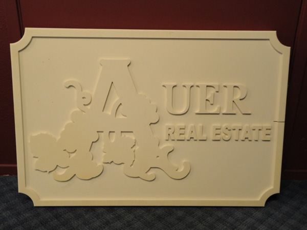

Thanks guys for the help and knowledge. I thought it might be benificial to see the size fo the products that i am doing. The small address sign is aprox 15" x 25" and the larger sign is a 24" x 36". Also i added a pic of whats getting painted on the larger side so you can invision what i am doing. If you look at the larger HDU sign i have going you'll notice that on the right side in the middle is a saw cut that isn't suposed to be there. What would you guys recommend on filling that saw cut? THanks again everyone!
