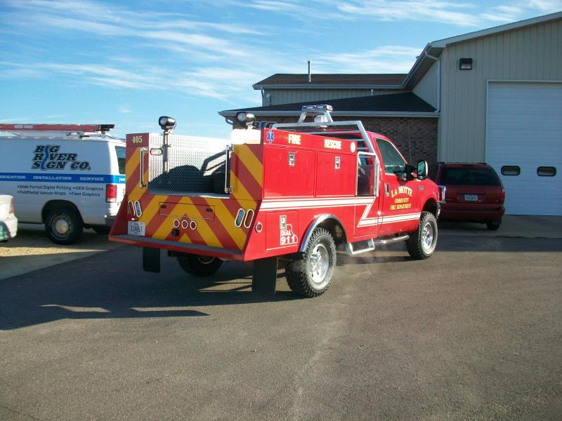

what do you guys recommend to put on the back of a fire truck;
[FONT=&quot]3M 680 Series Reflective[/FONT]
or
[FONT=&quot]Oralite Reflective O5700 [/FONT]
thanks for the help
Kevin
Malkin
Printed or just straight vinyl?
If printed, get the 680cr. It has the crosshatch air egress adhesive, be easier on the install.
mbarden
3M has red and yellow available in 6" rolls. I believe Fellers carries it. It is not listed in the catalog. All new Fire Equipment is required to have 6" refelctive striping at a 45 degree on the back of the vehicle. Make sure that you remove all of the hardware.

that's is with I am going to do on it. Yeah all hardware will be removed first. Is it best to overlap it or bump it together?
