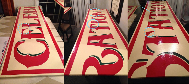

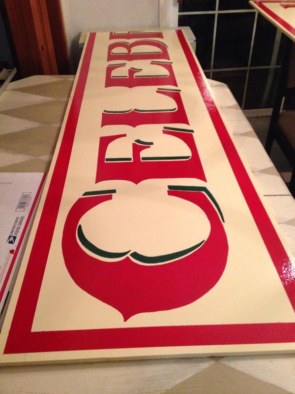

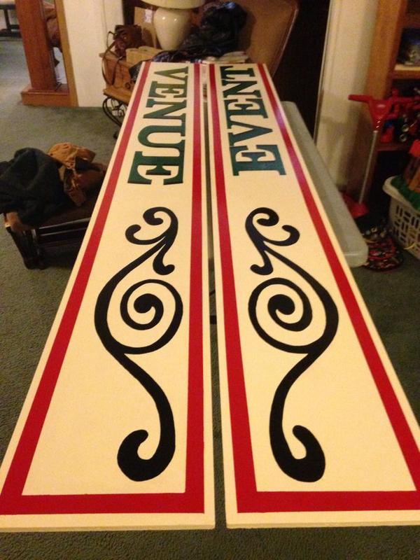

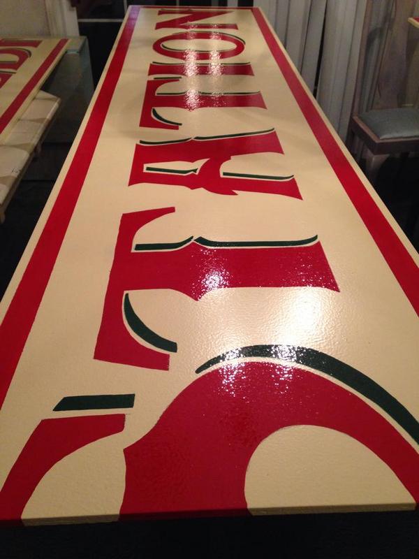

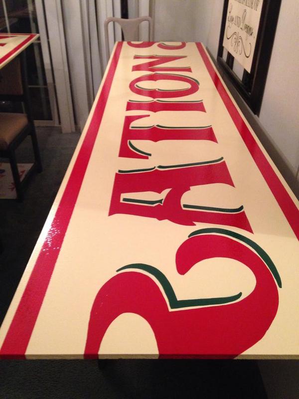

This is my very first sign project and I learned what I could from You Tube and reading some forums. I drew onto poster paper and pounced it to my signs. I primed with oil based primer and then painted the boards with oil based semi gloss paint. I used 1 Shot to hand letter thinned with Chromoflow.
I had a bit of a learning curve and early on, my plastic cup I mixed the paint in melted and it gummed up one of my letters and I tried to sand it smooth only to slightly ghost my backboard so then I had to remove the letter with mineral spirits and sand the board a little and go back over with my next coats of lettering enamel. Now I think the backboard looks a bit dull on that panel and I want to even out the sheen. I thought I could clear over but now I am freaked out thinking it may not be good to clear over because I did not add a hardener into the paint and I cannot get any response from 1 Shot tech yet about what to use but I was thinking of trying a Spar Varnish.
I read on her perhaps that I can use car wax to buff out the sheen. That would work for a while but how long does it take for exterior signage to get duller rather than glossy? Unsure about this possibility as well.
These signs will be exterior mounted to a building.
Also.....I have no idea what is a fair price for this work. One sign is 2 foot by 23 feet. One sign is 2 foot by 14 feet. One sign is 1 foot by 16 feet. I was 7 panels of MDO.
Is there someone here willing to advise me? Thank you so much in advance. Not the best photos but...this was taken with my cell phone before I put the 2nd coat of enamel into the borders.

First be prepared for some less than flattering though perhaps helpful advice
I'm not going to comment on pricing but waxing may help even out the sheen.

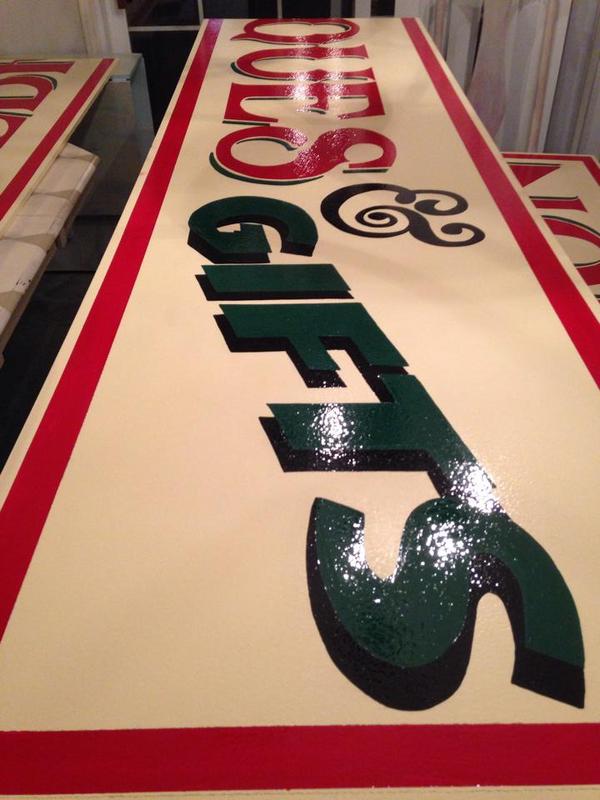

I think it looks pretty good for your first hand painted sign. My biggest criticism would be your color choices. Your shades are way too dark, better no shade than the wrong one. From a distance the two colors will create an illegible blob
player

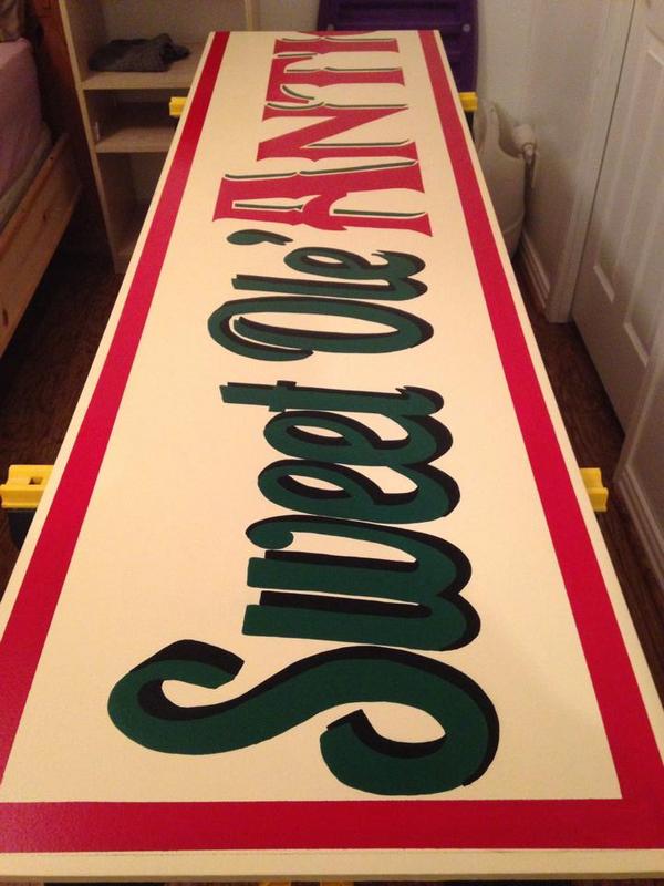

The red with the black spaced outline should be good, but the dark green with the black shadow will not be very legible.
Let the paint cure as long as possible before waxing. Try not to clear coat if possible.

I'd have to agree that the green with the black drop shadow is going to be hard to read from any distance.

Yes, outstanding for first hand-painted signs. As for the shadowing techniques lacking a good visual, don't worry about it. Light sources and color treatment are generally all learned by reading, being pointed out and just retaining a few basics. Post up a few more of these and within a week or two, you'll have all the pit-falls down pat.
Again, great job...... :rock-n-roll:

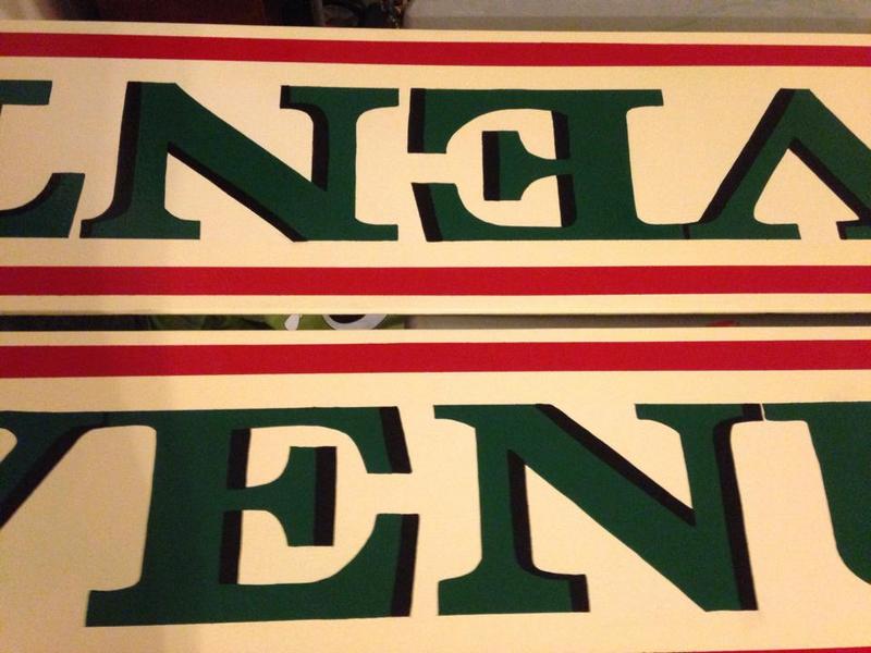

Agree with the same comments, one thing I noticed was your drop shadow... they are inconsistent (see pic)

I agree that this is awesome for a first time, and also agree that the green/black combo blurs together into illegible shapes, so I think you should consider fixing it. Maybe set it up where you can walk back 50' & see for yourself... then maybe you could just paint an ivory separation between the green and black (like on your red lettering) ..otherwise, a shadow trick I learned here is to be reminded that if a shadow fell on an ivory colored surface, a darkened shade of ivory is what you would get. If it's a simulated 3d extruded letter effect you are going for, then the letter sides can be whatever color you want, but for legibility it needs to be closer in value to the background, rather than the letter. Assuming you have good contrast between letter and background (like you do), this is a good rule of thumb.
This isn't really a protected area to discuss pricing, but iSigns's higher number is very close to what the signs are worth, had they had proper shadowing and prepping. As they are, about 1/2 that. Gotta live and learn.
As for learning the 'ins & outs' of shadowing, highlights and other fundamentals, perhaps you could start another thread asking about that sort of thing, rather than having people beat ya up on technicalities. :rock-n-roll:
