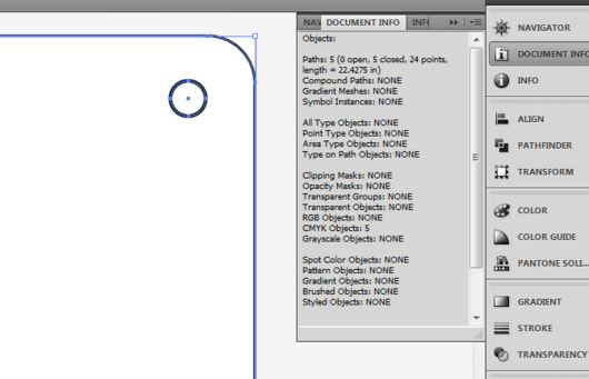

How do you setup your prepress files, what software are you using? Can your software determine the total number of inches that you will be processing? If so, you can charge a per inch rate to which you can add or incorporate time for setup, cleanup, etc. In your simple example you can determine the number of inches in the one 4.25x6 piece, multiplied by 500, multiplied by your rate to get the total estimate.
Here's an example of doing that in Illustrator for your 6x4.25 rectangle with .25 rounded corners and .1875 holes in 4 corners = 22.4275" total

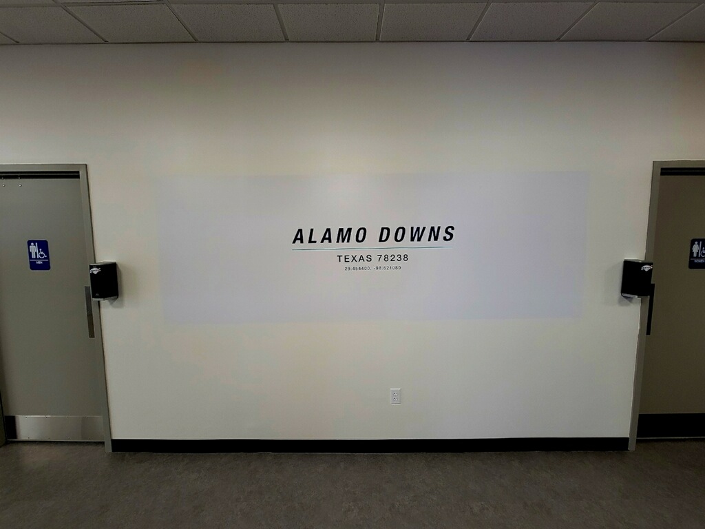

Most times we don’t have the cut file ahead of time. See the image below for example. I’ll receive this in email and say we need 112 cut contour from foam core at roughly 10x12”. There’s no cut file provided so what is my plan to help estimating get a price quickly?
Or in this example they want cut vinyl lettering instead of the rectangle. Is there a quick way to get a path length without having prepress process the file twice (once for quote and again IF we get the job?)

Most times we don’t have the cut file ahead of time. See the image below for example. I’ll receive this in email and say we need 112 cut contour from foam core at roughly 10x12”. There’s no cut file provided so what is my plan to help estimating get a price quickly? View attachment 159839 View attachment 159847
I'm not sure I understand your question here. But in effort to be helpful...
Go to the site. Bring a tape measure, and some marker tape. Take a picture that includes a measurement (s) reference for scale. And the decision maker on the client end. Measure the area the wanted graphic should fill. Mark it, photograph it.
Then, as the professional they are looking to hire, you give them some options.
Go back and create an at scale mock up. With the desired graphics at a real scale.
Show them mockups. Approved, production, install... If the installation is bad, it's bad. It has to be redone. That's between you and the installer. No client "sign off" will over take the initial contract/expectations. If you stand by your hopefully good reputation anyway.

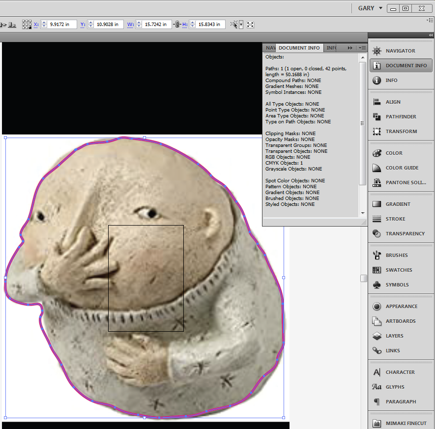

I think I muddied this post my adding the example image from my other thread. On this thread I’m trying to figure out best practices for estimating cut contour jobs without having to run a file through prepress or create a cut file for a job that we may not get. I posted the crooked install image as an example of “what if the client wanted us to quote cut vinyl letters in this instance; how do we figure path length so the estimator can do pricing quickly?
GB2
Old Member
So, I copied your image, pasted it in Illustrator at the original copied size, traced it roughly with the pencil tool and calculated the total linear length to be 50.1688". This is a simple example but it took me maybe...one minute. Certainly you can type out simple text too without much effort to get semi-accurate rough measurements. Not a perfect system, and I can imagine some jobs may be much more complicated, but it's just an example of another way to approach the problem.
