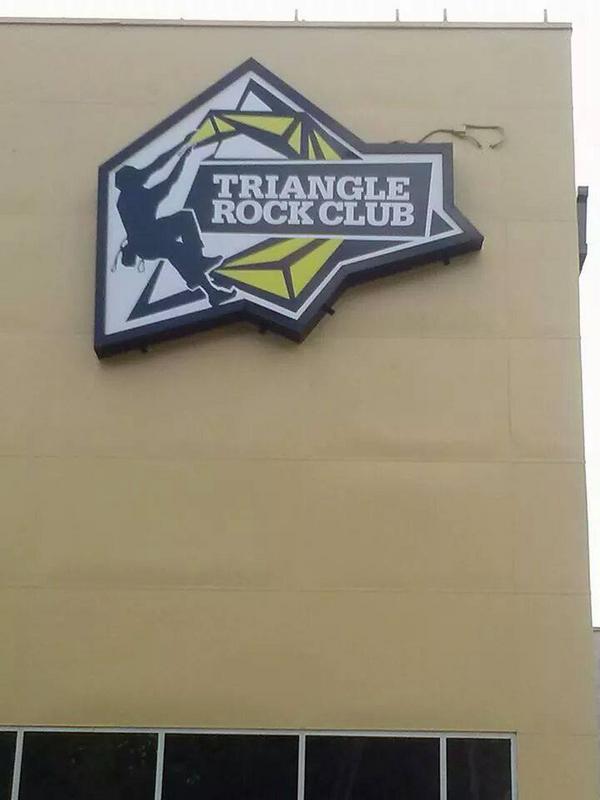

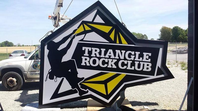

we've done a few, the most recent being last year in the summer. As others have said, there is a special mounting system that requires a larger trim bar than a normal cabinet, and it is a pita to stretch tight.
We did transluscent vinyl for the yellow and then just regular black. We had to go back over with green transparent to make the color right for the customer.
