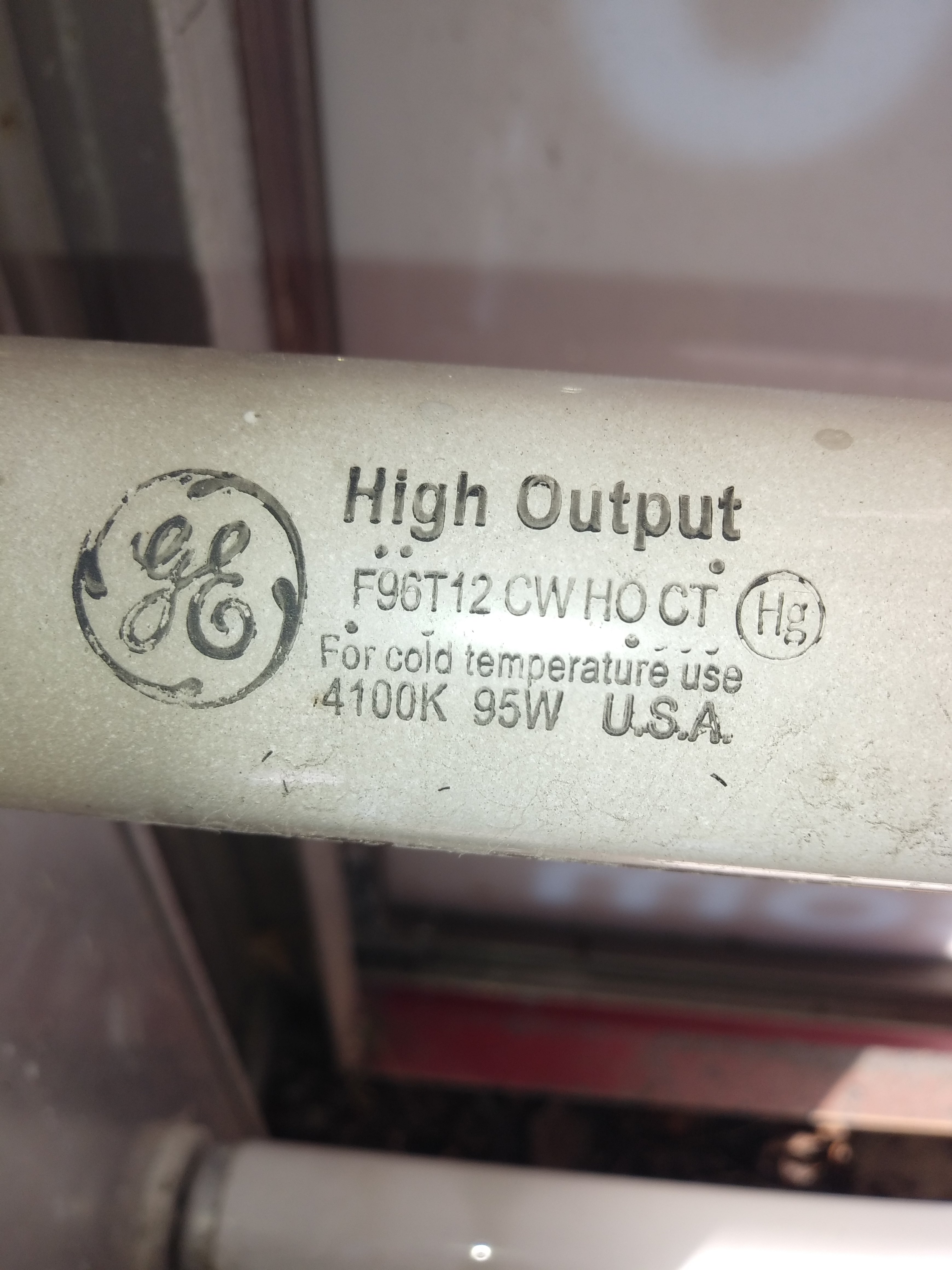

I had a customer call and wanted the bulbs replaced in their outdoor backlit sign. Took a picture of the bulb, ordered new ones and they don't fit. The new ones (exact same numbers) are slightly longer (1/4") and will not fit in the sign. Took old bulb to supplier and they said they cannot get that original length anymore. Any one else run into this before? Attached is the old bulb.

An old service man's trick is to turn off the power (unless you like high voltage shocks), put the lamp into the spring end. Then take a flat-head screwdriver and bring your bulb in as close as you can get. Use the screwdriver to wedge the bulb into place. The socket trap covers will give a little. I run into this from time to time when working on old signs. Have an extra lamp (or three) on hand just in case. After a few tries it becomes second nature.
Or if worst comes to worst, remove the socket trap cover (trim the length about 1/2-3/4" or even more) and slide it up a bit so that the lamp will fit on an angle. The lamps will be on a slight angle but should still properly illuminate the sign. Make sure to fill the gap you left in the cover. I've seen signs where the bulbs were on a 20 degree angle because the maker didn't know to oversize the cabinet in the direction of the bulbs. For an extrusion the rule of thumb is 1" longer in the direction of the lamps. I'll bet your sign is less than 97" wide.

Thanks for the info! Will give it a try.
Or.............. just replace the tombstone with a new one, position it properly and tell him the sign needed some service work.

it is more than likely an extruded alum. cabinet, not sure if the fixtures are tombstone or standard sockets. the alum that they are affixed to is probably .040. unscrew one side slide it vertically up or down,this will give you the room you need to put the lamps in place. once in place, slide the alum back and put your screws back in.
