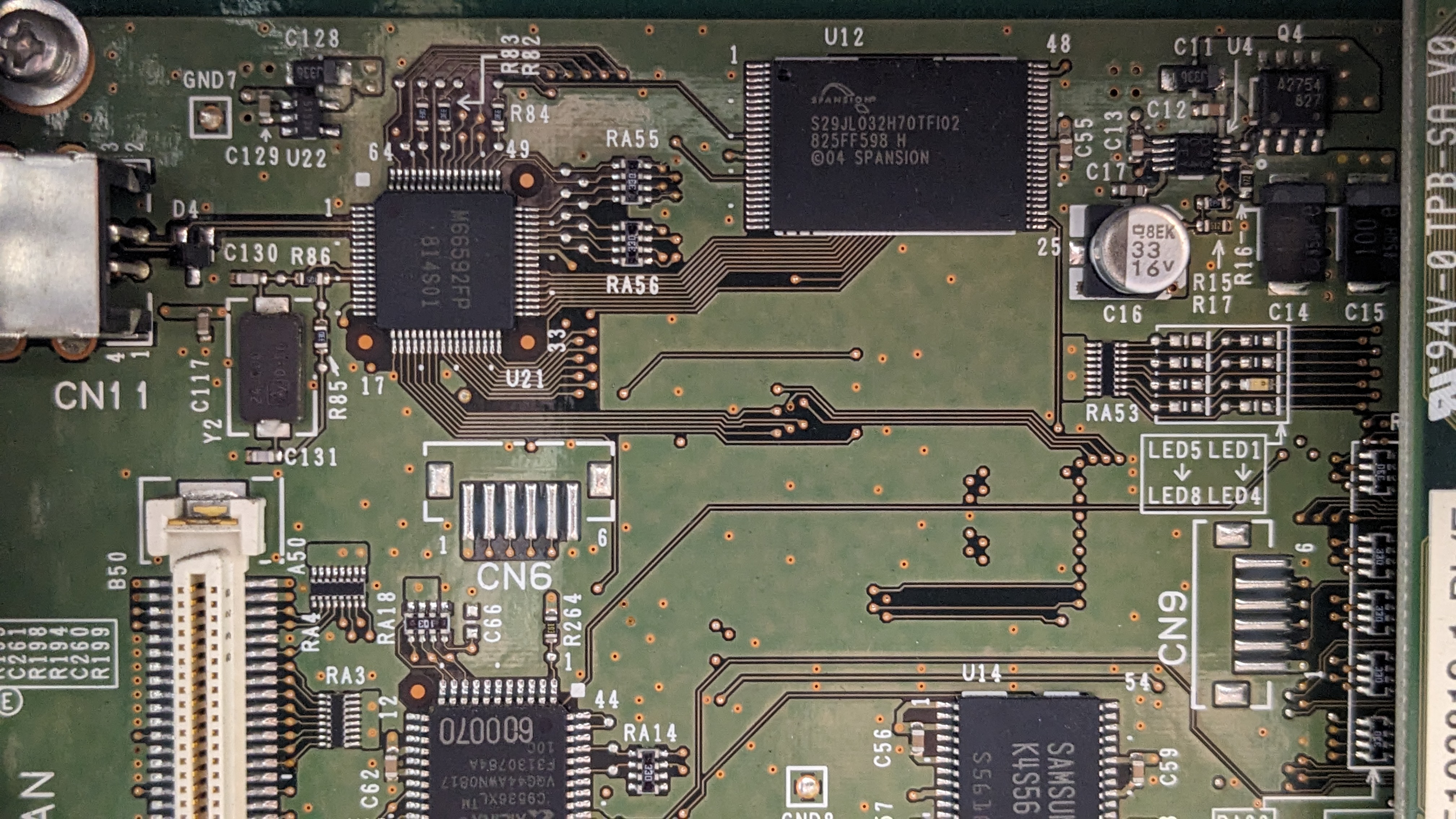

Smoke is on the right track. I used to do electronics repair. The attached has a chip that is commonly a flash chip circled. That would be my best bet.
Forty One
Smoke_Jaguar P/N is E105454-F
Yeah, thats a flash chip. And here I was looking for an 8pin.
Yet, that samsung chip is DRAM. Wouldn't the firmware be stored here?
And now will a CH340 cut the mustard on reading this (or the other) chip?

The U12 board mark chip made by Spansion, it's the flash memory. DRAM is volatile working memory, nothing useful there and everything dumps on power off. Digikey listing is for a different variant, but should put you in the right realm for pinouts. Best bet for dumping the chip would probably be an XGecu programmer, MIGHT require desoldering, or tapping the pins directly.
If you feel really daring, can probably find an old flash drive and transplant the chip to that if the controller is compatible. But the XGecu is like $50 and great for chip hacks.

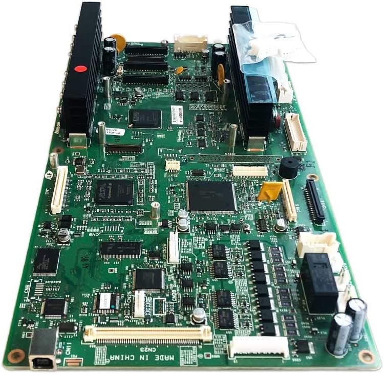

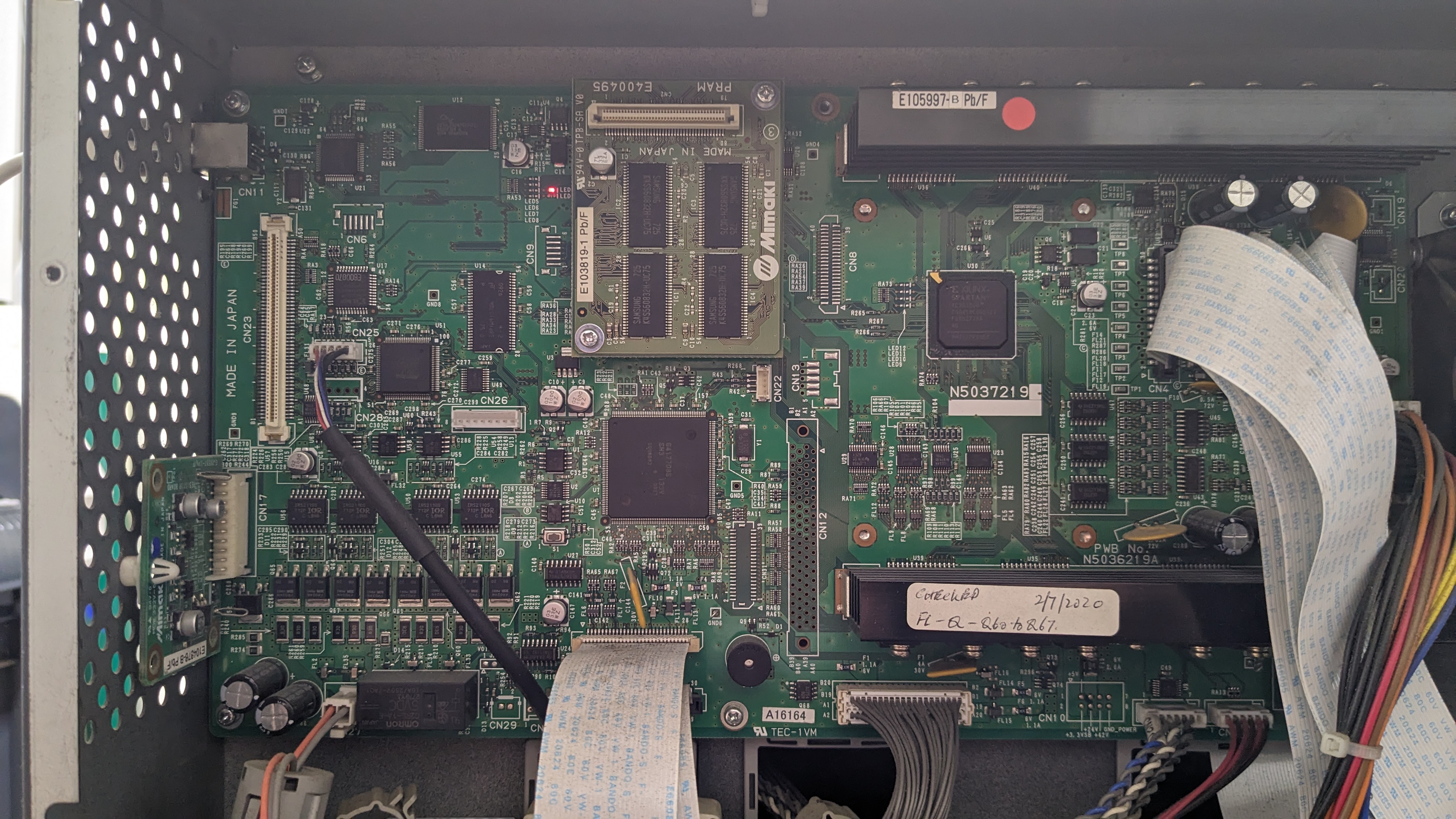

SO here's a pic of the JV33-130 board running ES3 inks.

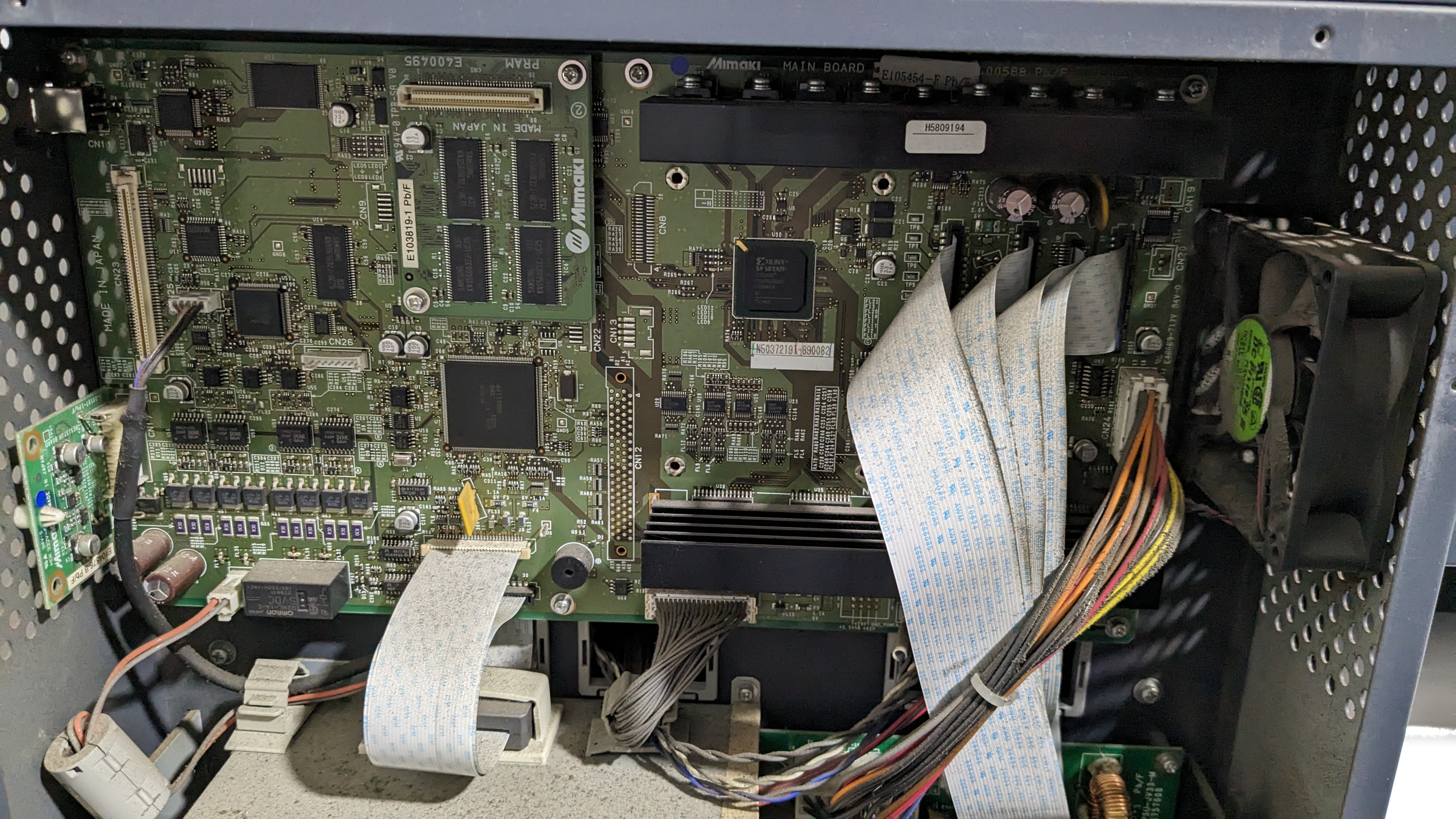

And here's the board from the JV33-160 BS
SO good thing is it doesn't require the colour coded jumper block located next to the relay (bottom right).
There's no harness there.
Step 2.... order Xgecu.
