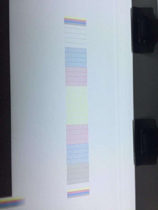

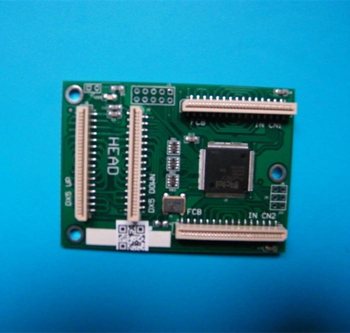

yesterday black started failing.. printed a test and this is what I go. I have connected a dx5 decoder card for encrypted dx5 heads.
this is the decoder card
I changed the decoder card with another card I have, and prints fine again. so it seems the card fried. printed a few jobs and all good.

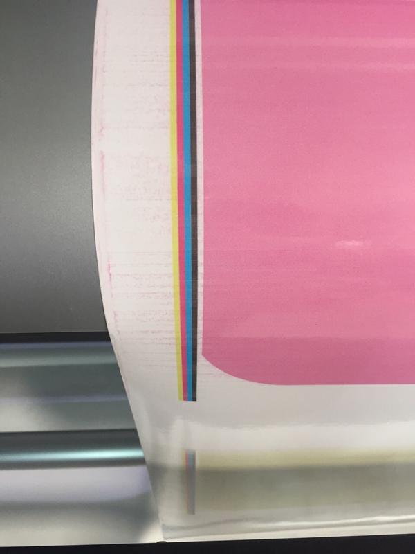

today I started to get again a overspray , see images attached.
I switched off machine to not further damage something.
What can be the problem???? How can I test if there is a electrical problem?

You are just plain lucky that you did not destroy the 2nd printhead. Usually if there are two machines, one machine is down, you don't take the other machine to try to make the 2nd machine run because now you will have both machines down. Down time = no food on the table.
There is a reason that the printhead went out. You want to pinpoint the problem, get it fixed before putting new/used printhead/parts or the same problem will most likely happen again. And sublimation printhead could go to solvent printer after good cleans because it is water based ink. Solvent printhead cannot go to sublimation printer because it is solvent based ink. It will create chaos due to its almost impossible to clean out solvent ink residual in the printhead which will later cause problem or react to sublimation ink. Sublimation ink does not like solvent based ink.
Pay really good attention to the sublimation printer which received the solvent printhead.
Just our 2 cents. Make changes at your own risk.
