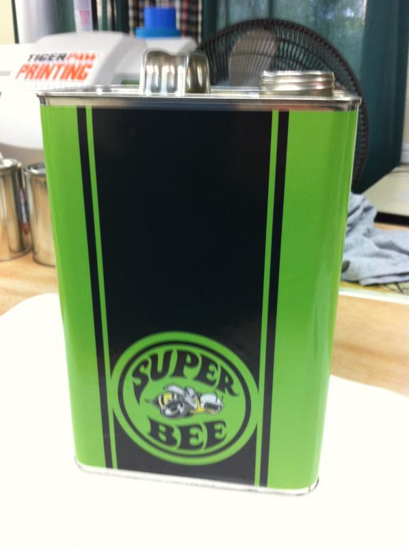

MotorCityMan
here is a sample pic

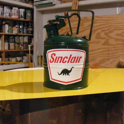

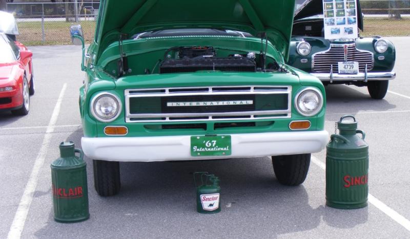

OldPaint
you alway could paint em, like these.
OldPaint
all 3 of em. all paint. cans when given to me, was old nasty some rust. sandblasted, primed, sanded primed, sanded and top coat(all automotive paint done with air/sprayer) lettering is all hand lettered. thanks.
