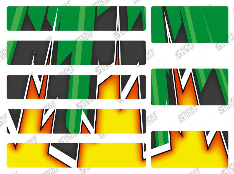

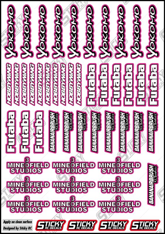

I've added a preview of how decals will most of the time look, and how skins look. You can see the decals are mostly white, black and then a certain outline color, wich I would like to be fluo or metallic too, but standard have to stay a possibility. The skins are mostly fades without to much special colors.
Any things I haven't said here that could be a plus for my task for one of the machines? Or just opinions?

Would it still be able to do the skin that I added in the attachments? What do you exactly mean with full colour is the only downfall?

I would set the files you have in the attachments to print on either colored vinyl, or to include overprints in order to ensure a nice print with no white edges.
Full Color = Process Printing.
The Edge allows you to print in both full color and spot colors. Personally I prefer to use spot colors because they're not comprised of dots. They're a solid print.

Yes I understand, but I mostly mean the first pic. The on with the green orange and grey, it has shadows and fades, is that possible to print?

It will print using process colors and you will need to work with the halftone and LPI settings to get the best results. It would be very hard to do with spot colors. You will see a very noticeable difference between 300 DPi and 600 DPI depending on print size and viewing distance with process colors.

I was looking at it and again, I'm a spot color person, so I'd probably end up layering this to create the best possible look for the customer. But if that's not an option, yes, it can be done. The orange fill would need to be a B/W jpg (at least with composer because it can't do fills like that) set to print Orange Spot and with an overprint turned on. The rest would be spot colors. That's how I'd run it.
What software are you going to be running with it?

I run an original Edge and I'd be able to do the first print. It would just take a little bit of set up time and creating the file the right way. And having the experience with Composer to do so.
