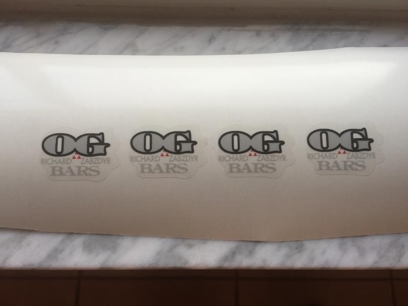

Finally got down to using my plotter, but I don't know if its me but it seems to be cutting off to the right a bit.
Now for starters instead of printing this in the usual horizontal position, I printed these vertically and ran them thru the plotter.
I wonder if this may have something to do with it?
Am running Omega 5.0 Gerber Edge, with an Older GSX 15" Plotter.
In the picture below the artwork and the lettering below is to left where it should be more centered to the right.
Check the drum on the plotter and make sure it doesn't have any side to side play in it. There is a collar on the right side that you can loosen and slide over to tighten it up if it does.
