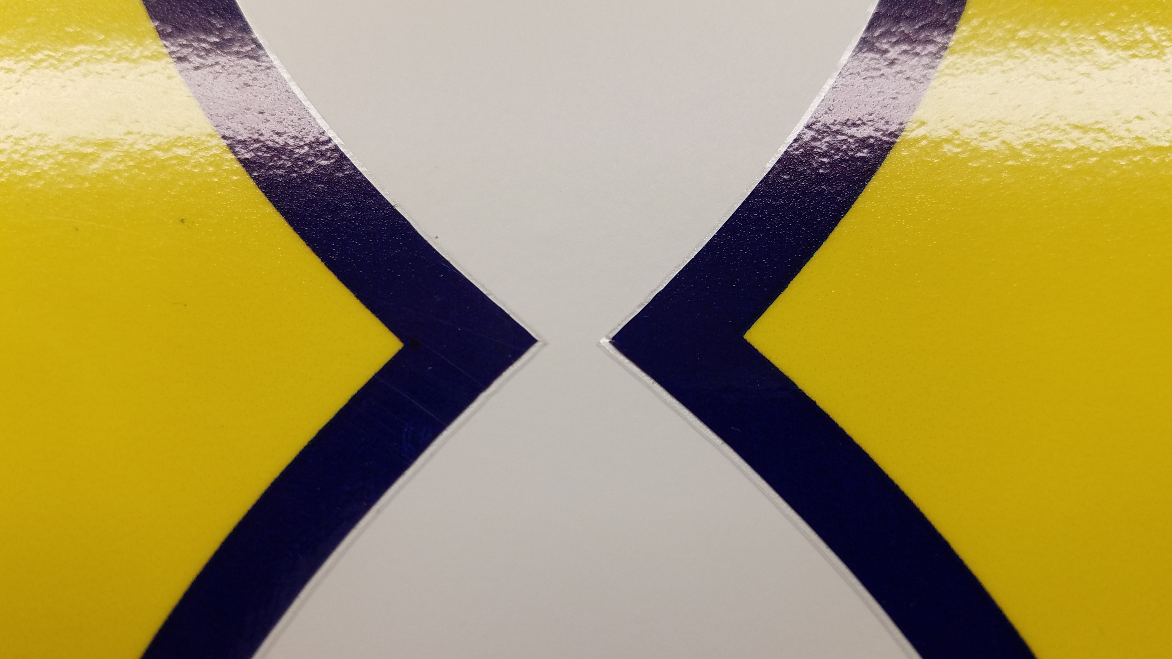

I'm not sure about OL331 but here's Briteline Duration X IM3203X with Briteline Shield OLUV. As you can see in the attached photo, the vinly shrinks way more than the laminate does. That's not a white border, that's the laminate overhanging the vinyl a few days after it was contour cut. I'm going back to IJ35C.

We dont use duration x at all. Avery 2923 or 2921 & IJ35. The Briteline shield lam is fine.
