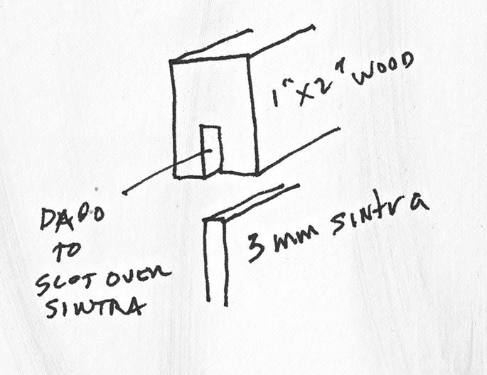

I would have dadoed a slot for the wood frame for the Sintra. and put lexel in the slot and brad nailed it together.

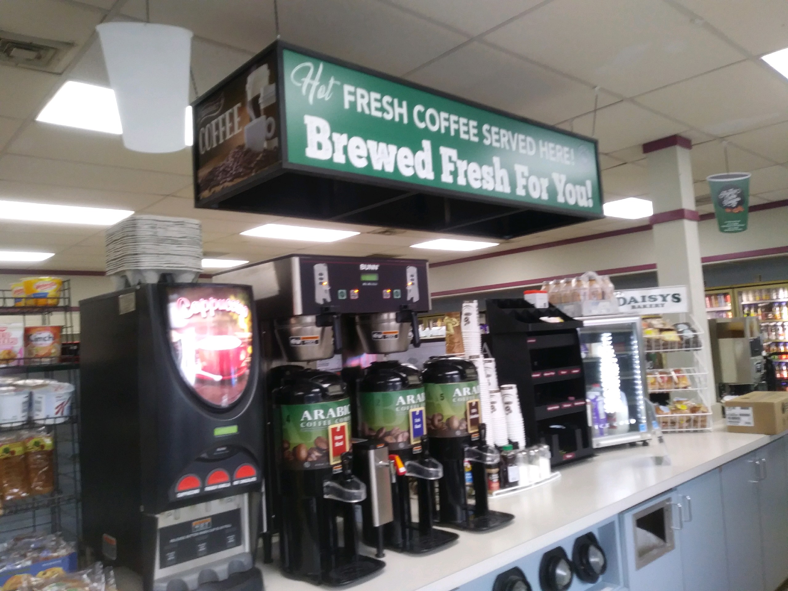

we are doing a bunch of these, for a large, long time client (of my consulting business, not my sign business, which is relatively new to me) however, many of the client locations are barely bigger than a phone booth, and have no room for a 2 ft x 6 ft suspended sign. we are resizing and redesigning the POS we are providing.
just for the record, we had our first meeting regarding this august 26, and i tried at the time to tell the people involved we would need multiple sizes.
we want something that can hang flat on a wall, not interfering with the view of security cameras. this will work for smaller locations.

You might wanna entertain the idea of gatorboard instead of sintra. Instead of a wooden frame, the sign itself would act as the frame and you could reinforce the corners with a bit larger piece. At the top, perhaps just a piece of wood around the perimeter and attach your eye hooks or whatever into that. However, the eye hooks could easily go directly into the corner braces. Now you'd have all compatible components.
It remains 100% flat and needs very little bracing. You can either use hot glue or double sided tape and/or any wood glue you'd like.
