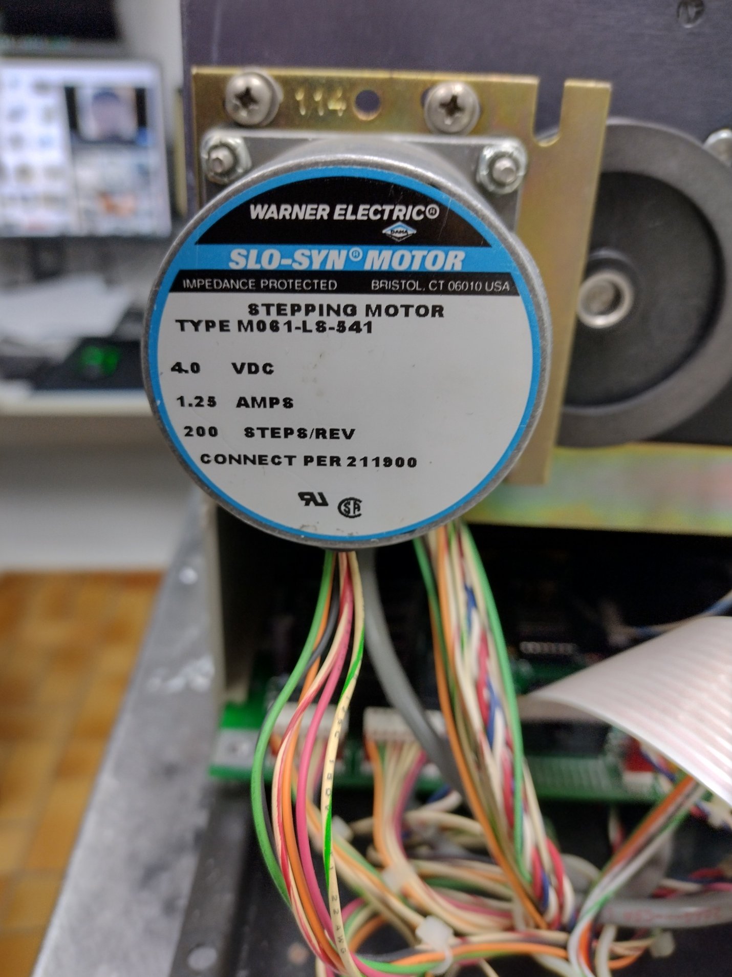

@ Vassago, is it possible to check a stepper if it gets enough power?

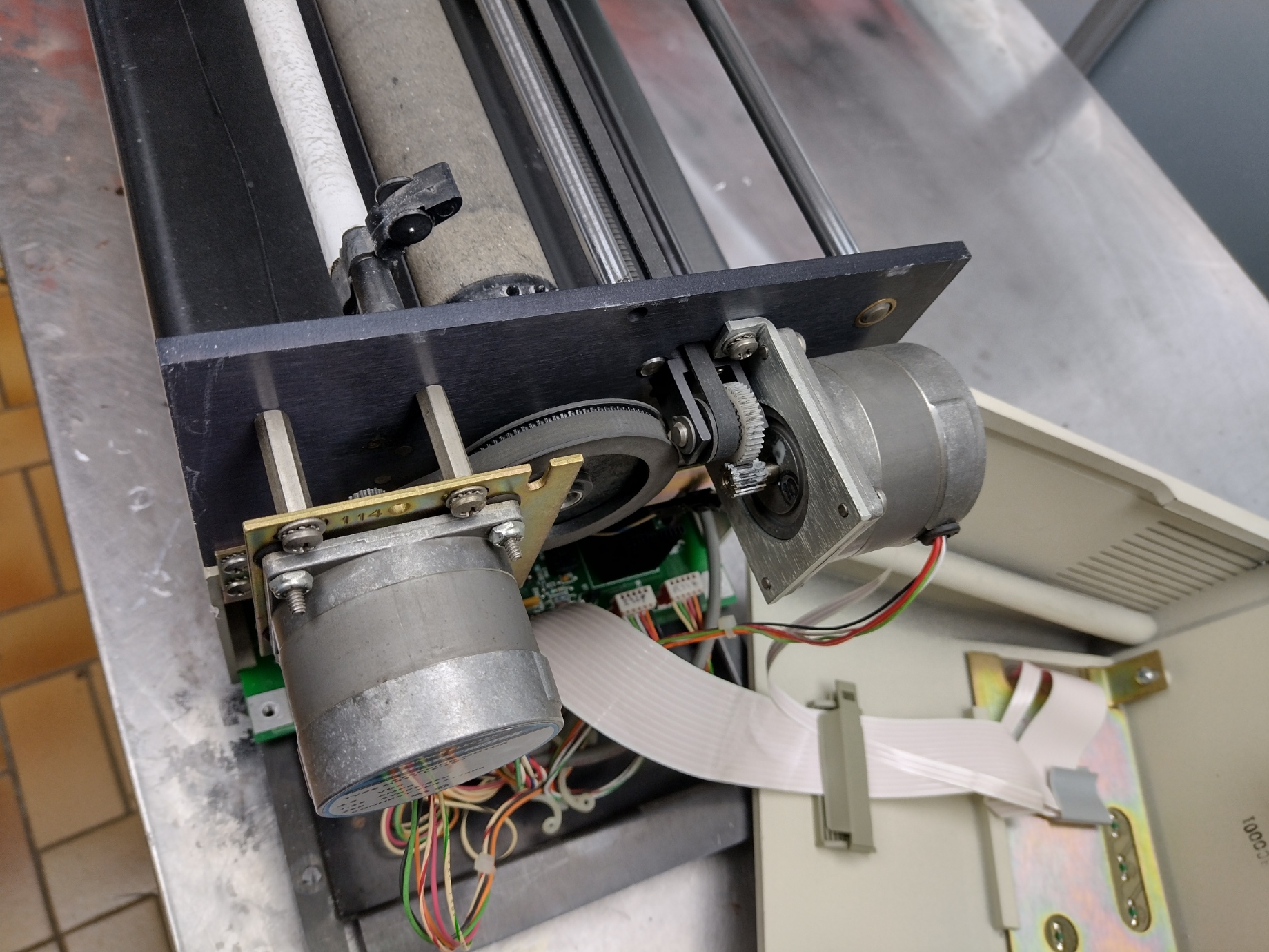

Just judging based on all the comments here and the photos I can see, it looks like it is only taking a crap on the one axis.
It looks like it is trying to complete the shape on the X axis (linear through the machine) but it looks like it is in the wrong position across the machine.
I'd look into trying a different motor for that Y(?) axis, we had ours crap out a couple years ago. Definitely look in that area, maybe even a cracked gear.
I've used these machines for quite a long time and never had to do electrical stuff like capacitors, but I've replaced many motors, sensors, and gears.

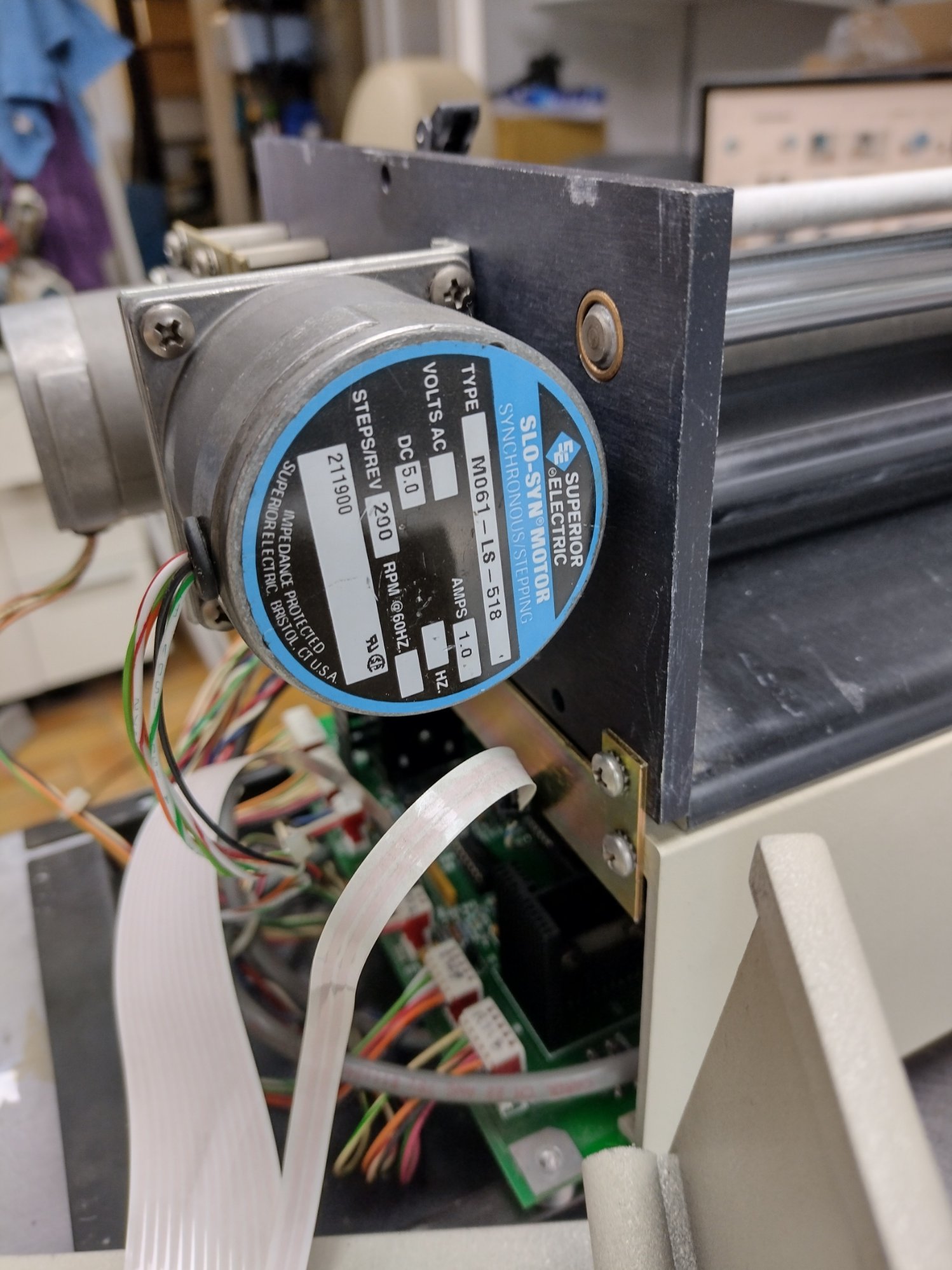

jfiscus thank you for your reply, i took the covers off again, i checked all the belts and gear teath, these are ok. Is there a way to check the stepper motor or is it only possible to swap it out for a new one? I have no clue of how to check its function.
Is a cracked gear on the inside of the stepper motor? Or do you mean all the gears where the belts are running around?
The part number on the motors are M061-LS-541 (for turning the roll through) and M061-LS-518 (for moving the head) and are from Warner Electric, it says SLO-SYN MOTOR. I am looking to find a replacement motor now. I am not sure if it is the one that moves the head or spools the roll through the machine.
