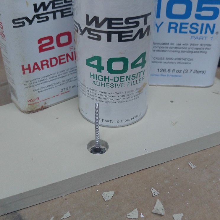

I'm sorry. I should have realized not everyone uses West epoxy. 404 is the adhesive filler you add to the epoxy when bonding fastners. Fangs up.

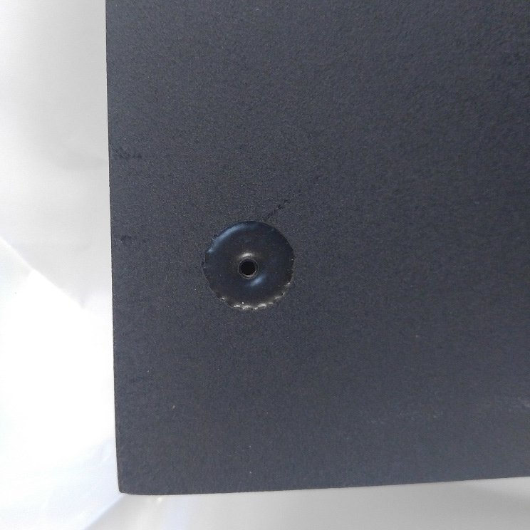

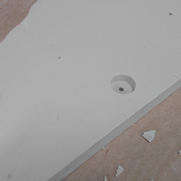

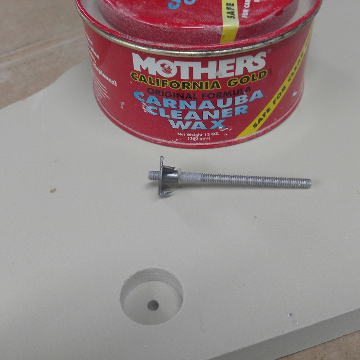

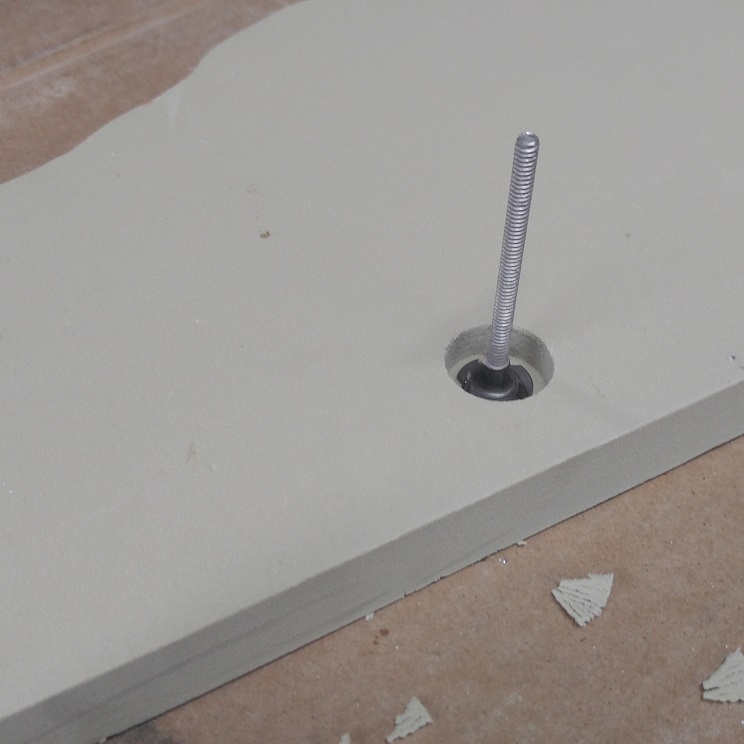

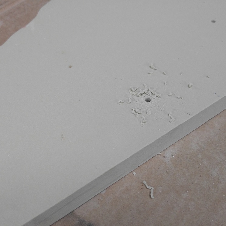

I'll try to make this quick.
I make a pattern for my hole layout then drill(in this case 3/16'' hole for 10-24 t-nut) a pilot hole.
Then I drill a 1'' hole.
Then I coat the stud with wax leaving a little stick out for alignment.
Then I place into the pilot hole so it lines up to my pattern.
Then I fill with West epoxy with a little 404 added.
When dry you can remove the studs for transport.
These pics are from the back of a 1'' thick signfoam address sign that will be blind mounted to brick columns. I just hang my template up on column, drill, attach studs and glue and done.
Works for me.
