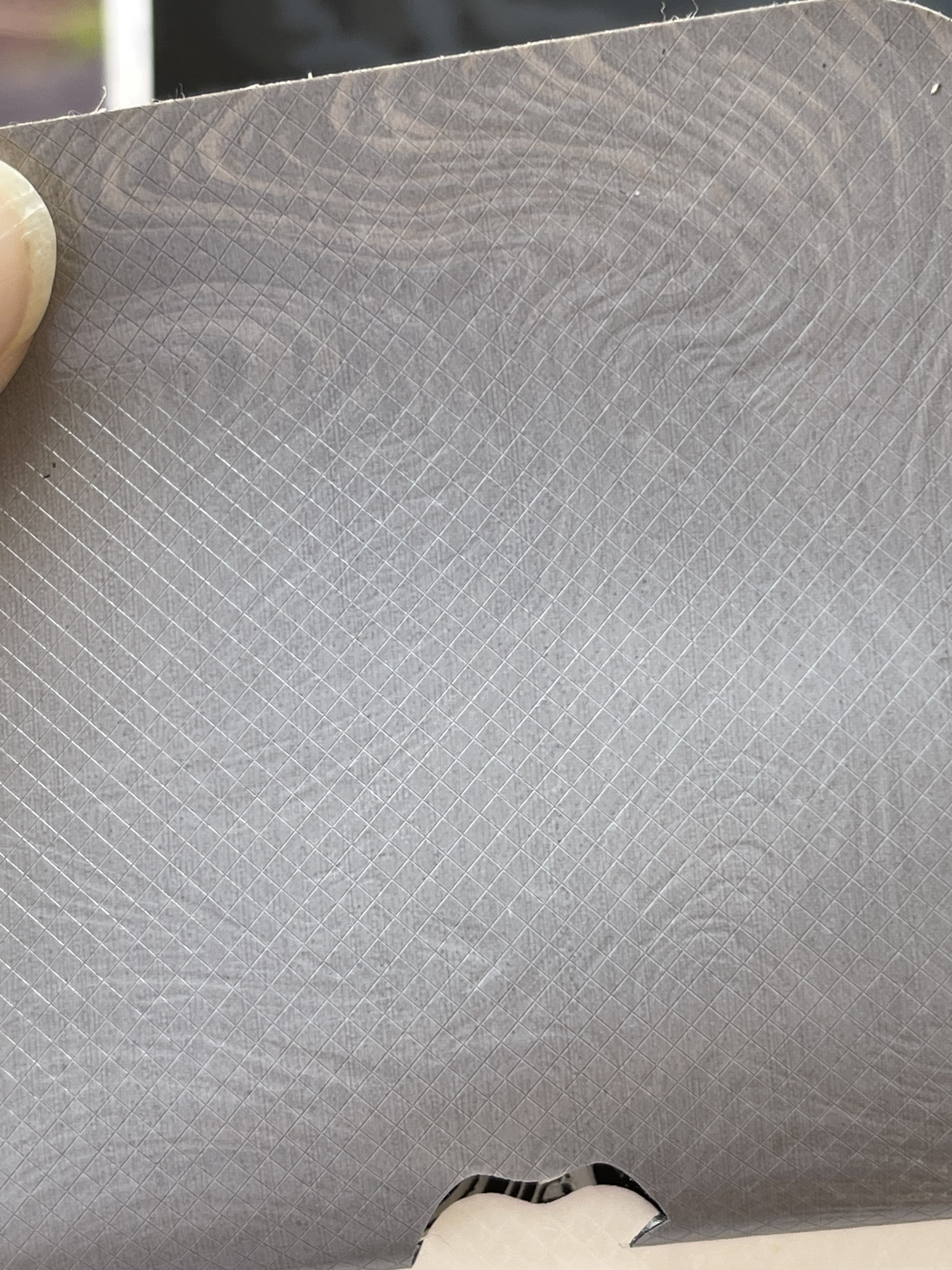

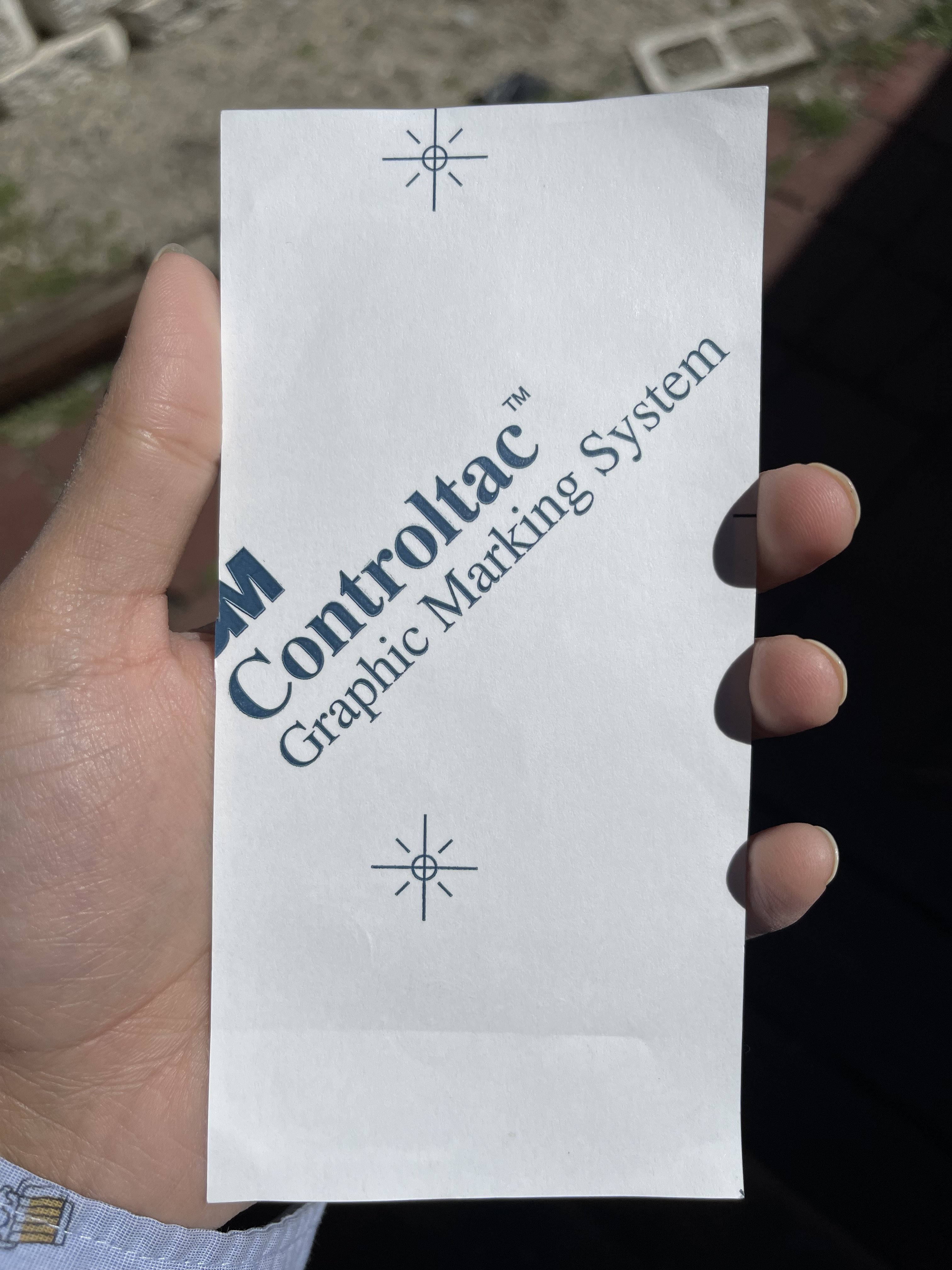

We started a phone and laptop wrap business few months ago. At first, we used 40C gloss white for UV printing. But customers complained it didn't stick well, especially at the edges and with thin vinyl cuts. We tried a different material from a similar business and it worked great. It sticks well, is thicker than 40C, and has grey adhesive with bigger controltac gaps. We're trying to figure out what 3M material this is. Any help would be appreciated.

+1 to above stated IJ180c-10. slightly annoying how that pattern shows through the surface after application, but its good stuff.
ij35/40c is cheap and reliable, but will not conform. we only use it on flat stuff.

You should try using IJ35C, it's a lot stickier than 40C and way cheaper than IJ180.
It looks like a permanent adhesive. I don't think our competitor's uses a permanent adhesive as the skins (decals) goes on to your back of the phone, using a permanent adhesive might leave residues.

I checked out the IJ180C, the IJ180C is very thin in compared to the one I shared into the image. Not IJ180C, we are still looking lmao.

I have a feeling it might be IJ160C but not sure. What are your thoughts on IJ160C? Have you used them?

Usually for phones and stuff people use 40c or 180. It's not ij35 as that's a different backer.... To me it looks like 40c, or 180cv3.

No, we are not laminating, or so are they. I have tried 40c, and its adhesive is not good. It's not 40c or 180cv3, as they have micro air channels. The one in the photo has wide air channels. So, most probably it is either 180C or 160C. What do you think about 35C? Can you explain it to me a bit? Thanks

That adhesive pattern is not very even at all, I'm not sure that is legit 3M vinyl with it looking all swirly like that.
If it is thicker and has the large cross hatches I'd say IJ160c also, but I haven't had a roll here in about 4 years.

Cv3 isn't micro, it's wide channels but it's thin. 180 Mc is micro channel.
Ij35 is a permanent... That said, depends on what you using on. We use IJ 35c on anything plastic or glass, and it peels off pretty easy

Those swirls are the design on the front. It looks like that because of light

What do you say about ij35c on back of a phone or laptop. they are usually flat surfaces. Will it leave any residue after few months of peeling of. How would you rate the peeling experience of ij35c in compared to 40c. Also their adhesive. 40C adhesive is really bad if I'm being honest.
