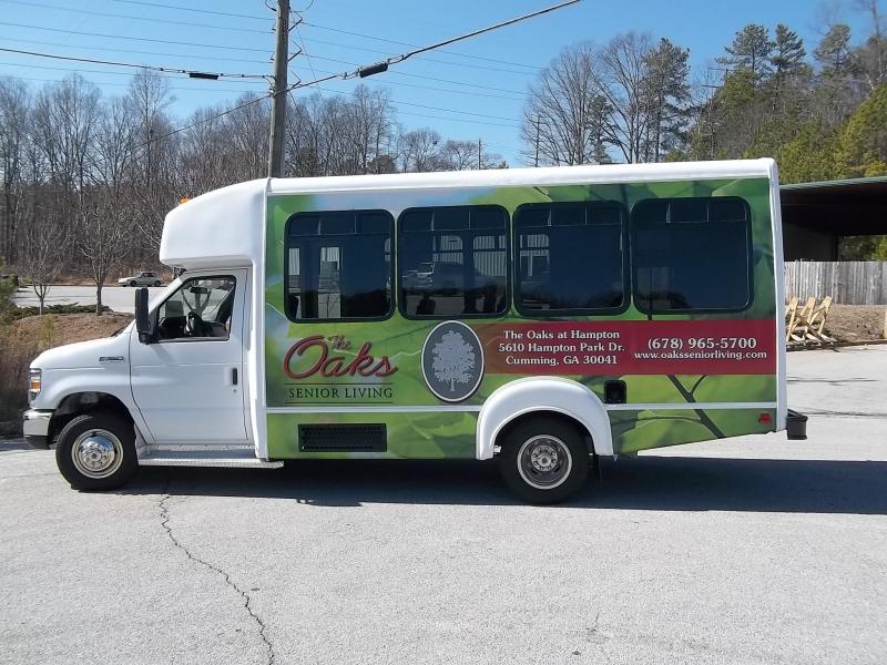

To the issue at hand, though, I was quite impressed with General Formulations' AutoMark material. It's a calendared vinyl designed for printing, with the air egress channels. It gives a very nice print and, when paired with the appropriate gloss overlaminate, is great. We used it recently on this bus and it worked like a charm. It does say, though, that it's not meant for complex curves- so I wouldn't try to wrap a PT Cruiser or a Beetle with it.

I once wrapped a buddy's autocross car with a calendared Arlon. Five or so years later, they're still on the car, even though he's since sold it. The person who bought it asked me once about taking them off. I told her she needed a heat gun and a lot of time. And probably new paint afterwards. But, it was/is a race car. We figured it would be wrecked anyway.

We had a new customer come in wanting us to remove a wrap they had done by another shop. They pulled their original invoice - the other fly by night place sold them the wrap on Automark. The wrap had only been on 2 years. I told them we have never worked with Automark material before and I'd need to test remove a small 6 inch or so section on the back of the van first. It left 100% of the adhesive behind and was a pain just to remove that bit and then even straight xylol could barely cut through the nasty adhesive. I told them it would be $1200 to strip the entire van, I then told them that if it was printed on 3M their up front cost would have been a few hundred more but the removal would only have been about $200 on the removal after 2 years.
