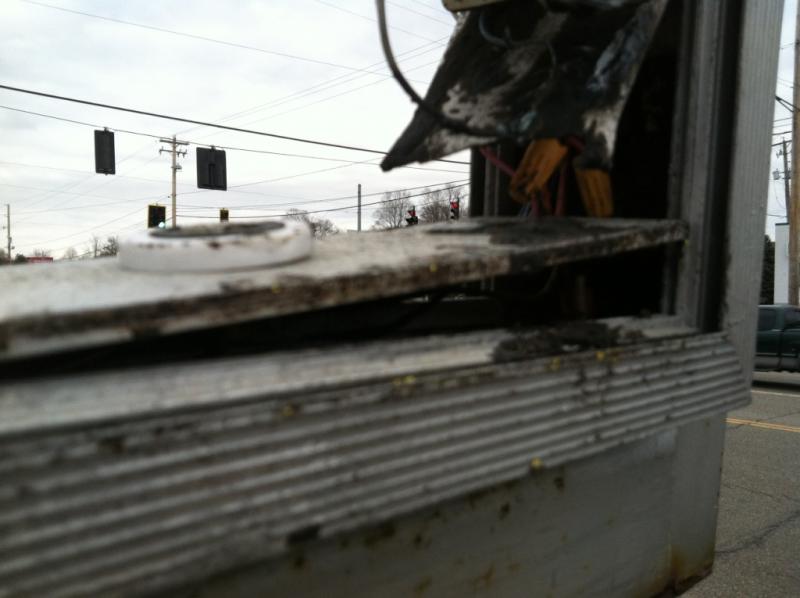

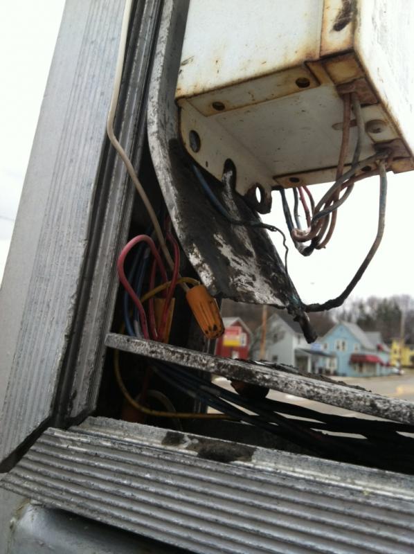

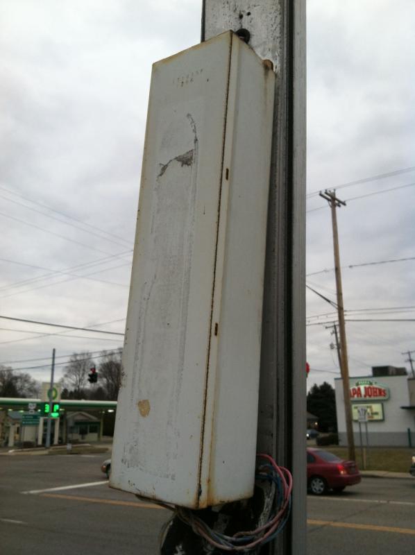

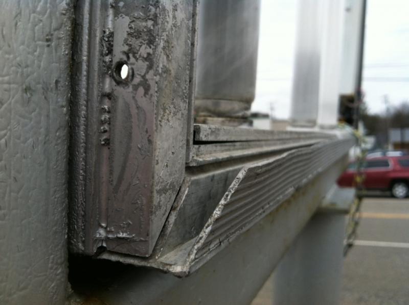

I have the oppty to quote some new faces for a new customer. They are to go into an existing old backlit box. It needs refurbed or replaced (customer prefers fixing). I haven't had much experience and normally wouldn't mess with this part but if I want the job I need to do it all.
Any advice on where you would start? Power is going to box but other than that nothing works. Posting pics.

Well unless youre an electrician I wouldnt touch it. You fix it and then it catches fire and the building goes up in flames. Guess whos in trouble?
Ive been asked to fix a sign in that condition before, or worse. I told them i wouldnt touch it with a 10 foot pole. I wont even put a face it in because the frame was sagging off the pole and twisted.

Replace the ballast and sockets and socket raceway if needed.Oh yeah your going to need a pan face for that cabinet.
petrosgraphics
it looks to me to be an old excellart sign cabinet....
you will need: pan faces, cabinet not wide enough for flat faces..
new ballast, new fixtures (582 & 583 kulka sockets)
size of ballast? number of lamps and length..
sockets? pr. for each lamp..
make sure all components to cabinet are there.
make sure you look hard and long at the way the cabinet is set up..
sockets snap into place, w/spring loaded on top..wire diagram will
be on new ballast....
if you think you can handle the project, great.. if you need an electrician
to be on the safe side, have him wire the sign and up charge a little
for his time....
MikePro
can o' worms for sure.
you've got steel upright and power-connection, so not complete loss. i'm sure a new cabinet will definitely be less$$$ than re-vamping the existing, and WAY less than a new sign altogether.
