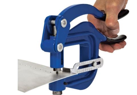

Got the tool. It didn't even grommet a piece of paper. Don't waste your money on one.

No problem....... no problem at all. You tried to help and when I saw it, I thought, this can't do it, but I tired. I ended up ordering a much heftier one and it should be in by Friday or Saturday. It will do 3/8" holes and go through the banner material. The one from harbor, I wouldn't've been able to put a piece of string through it, let alone a wire cable.
