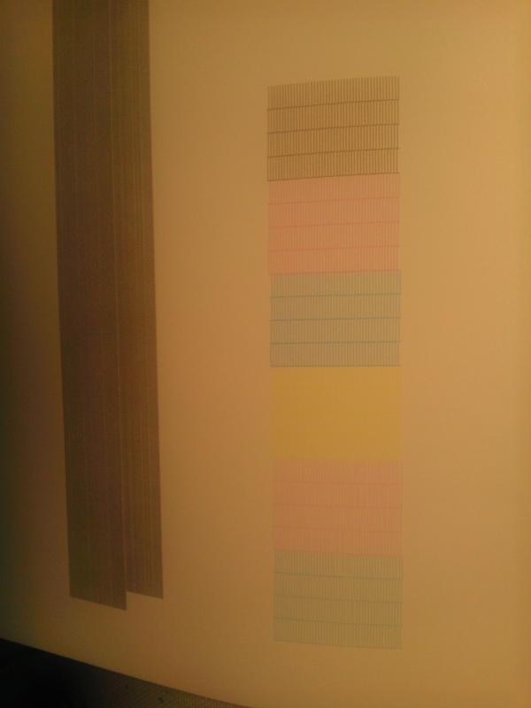

ChicagoGraphics
I have a Mimaki JV3 160SP and it uses the DX4 heads I bought it in 06 and the original heads are still perfect, plus I do a lot of printing with it. So knock on wood they are still running strong.
