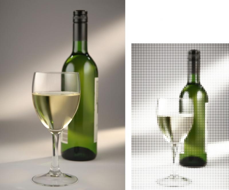

Cyw
I'm a big Rasterbator fan as well. Because they're vector 'circles', there's tons of possibilities
