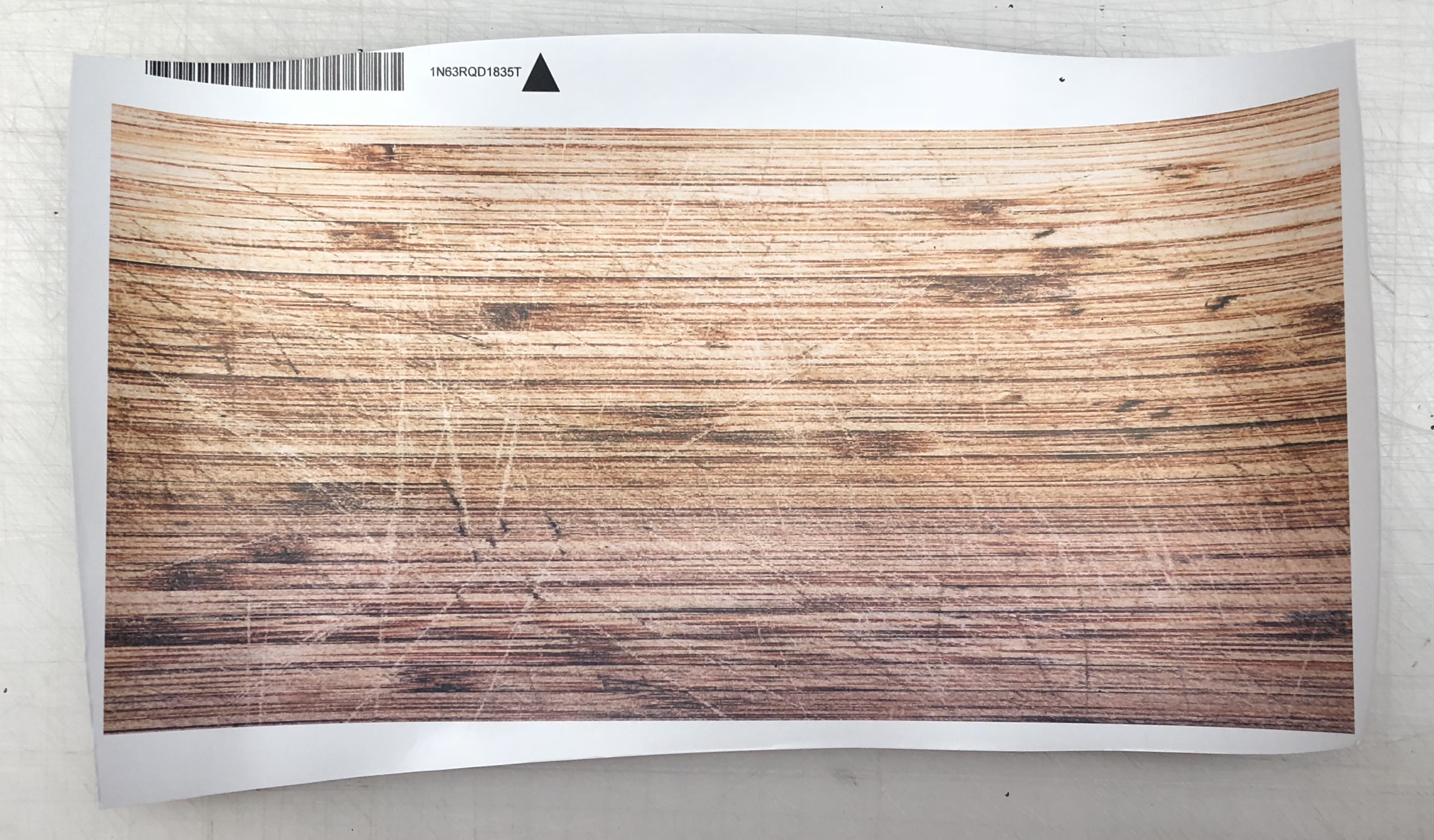

Hi all. So my L 25500 just started dropping color mid way through prints. I’ve replaced yellow/ black and light mag/mag but still getting the problem. I ran 1 printheads clean cycle on yellow and black and it got better for but didn’t cure it. Any ideas guys?

It sounds like one or more of your print heads may be overheating and turning off. The HP 260 (nearly the same printer just a newer name and firmware) actually warns you when stuff like this happens or is about to happen, but I've heard of other 25500 owners not getting notifications about this.
Since there are two of each print heads you may have replaced the wrong head(s). My suggestion is to run color boars on the far left of your print and watch for which color is dropping out. You can tell which head it is by the position of the dropout. If it looks forward or back you during a single pass then you can look at the position of the print head that corresponds to the lost color.
Ultimately you need to identify and replace the bad print head to cure the problem but there are things you can do to extend the lifespan of your heads and or extend the use of a marginal head.
