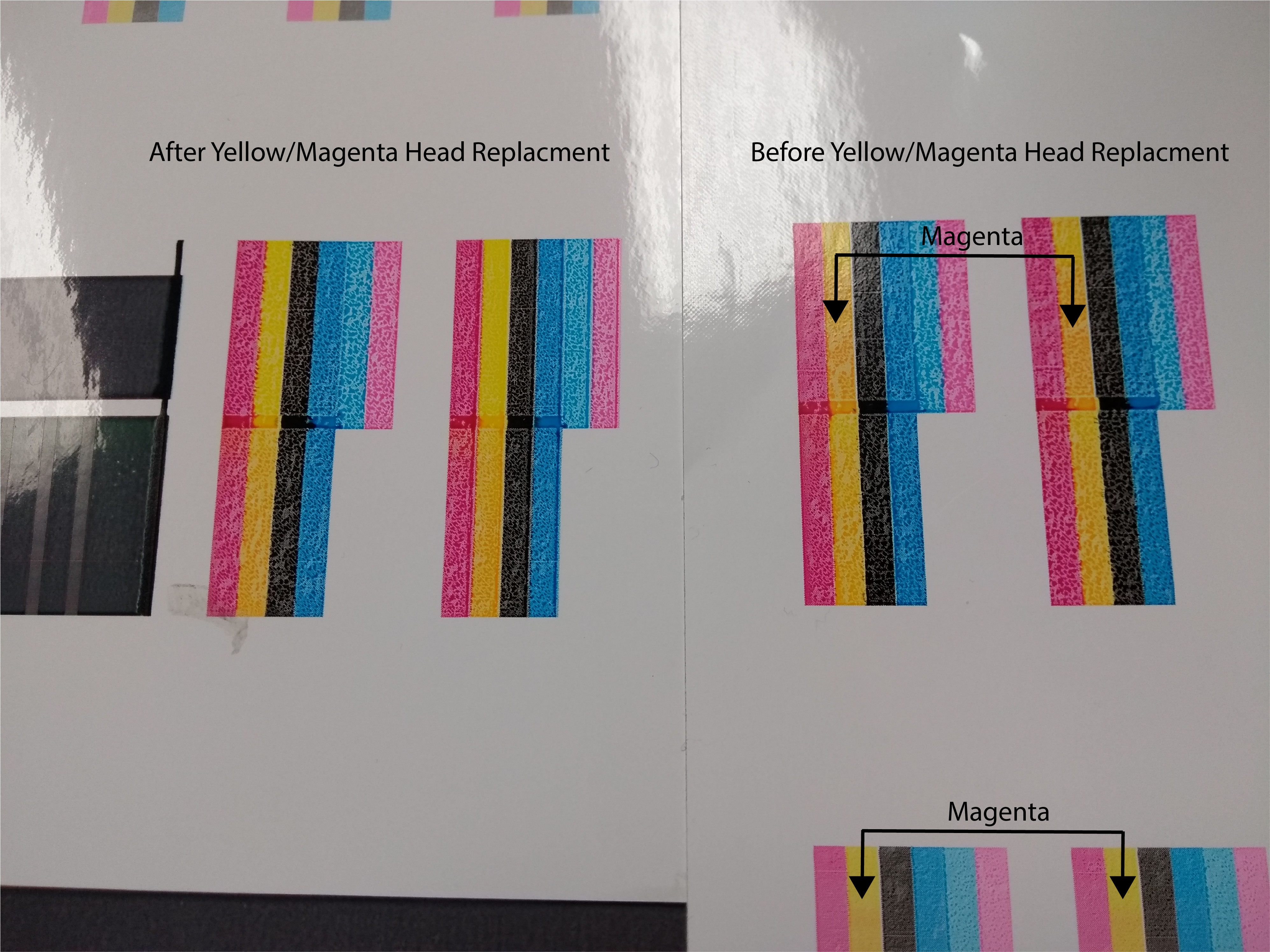

We have some issues wit our HP Latex 335 printer. It's prompting with error code 98:03.
After printing all test plots we changed Optimizer head(it was showing several nozzles out detected in optimizer print head(error code 27.1:00).
It helped for few days and then we had 98:03 error code again. In printed test plot we noticed that yellow ink is mixed with magenta. Replaced both magenta/yellow heads but it didn't help for long(It's doing same thing now but with less magenta in yellow).
When you calibrating colour, yellow is orangish(not always thought).
The other thing is that printer is preparing to print for 5 - 10 min now, it purging a lot even when there is no error message. But sometimes works fine for couple hours.
