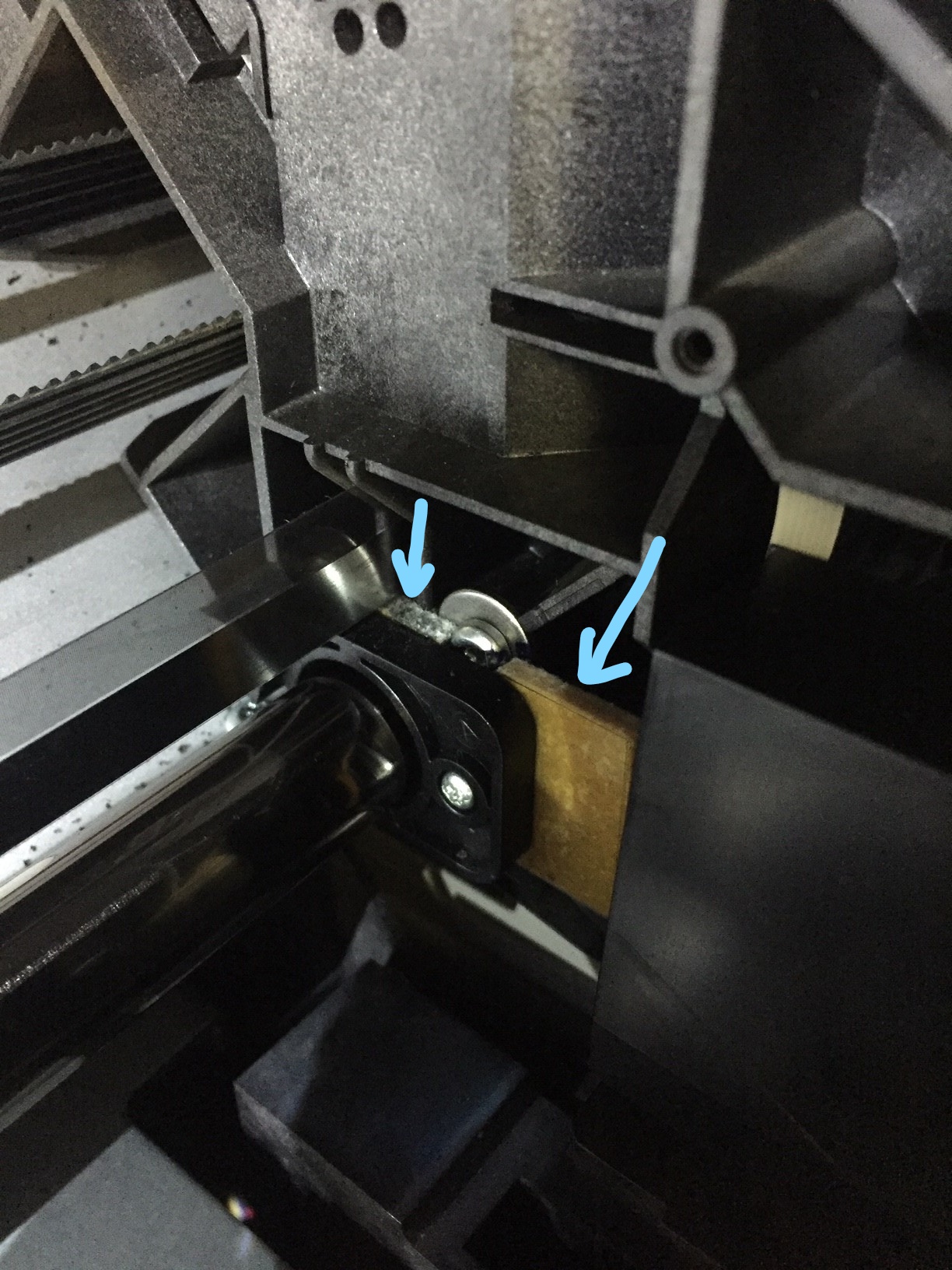

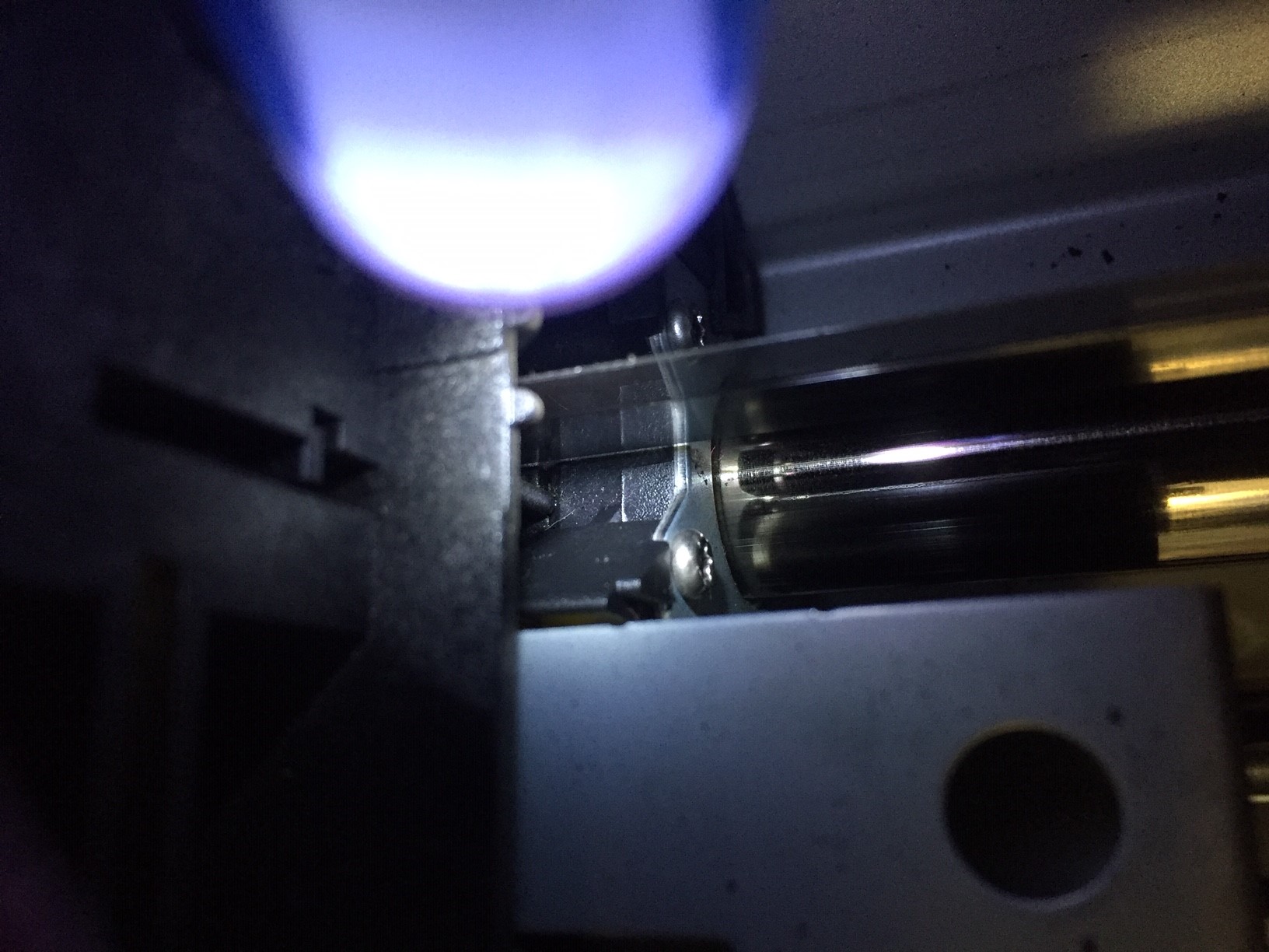

Hey Guys I'm getting a horrific squeaking coming from my Latex 360 despite multiple carriage rod lubrications. I had mentioned it to a tech when he was out here and he mentioned something about some foam or felt wells located in a hard to reach area on the carriage that can act as a sort of wick to keep the rod lubricated. I'm having trouble locating them and was wondering if anyone else knew about these? I can't find anything in the users manual.
I've taken a pic of what I think it is on the left side and drew arrows. On the right side I have no idea.

That's the one on the left and the one on the right is called Oiler. Its that big piece that's hold with three little screws. Whole bottom part of the picture. Best reached if you disassemble the right end of printer.
Your left one is looking quite oily.
What is your service maintenance status? Both of those are replaced in the SMK 3.
There is one on the top as well, but that is difficult to get to. You have to take out the carriage half way.
