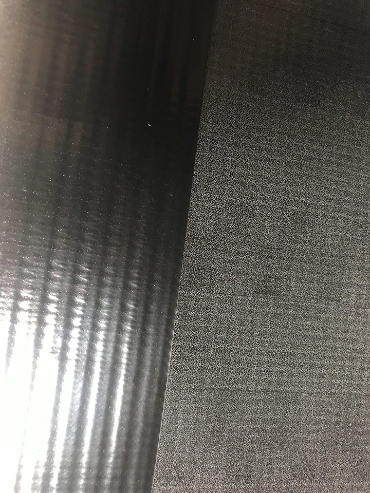

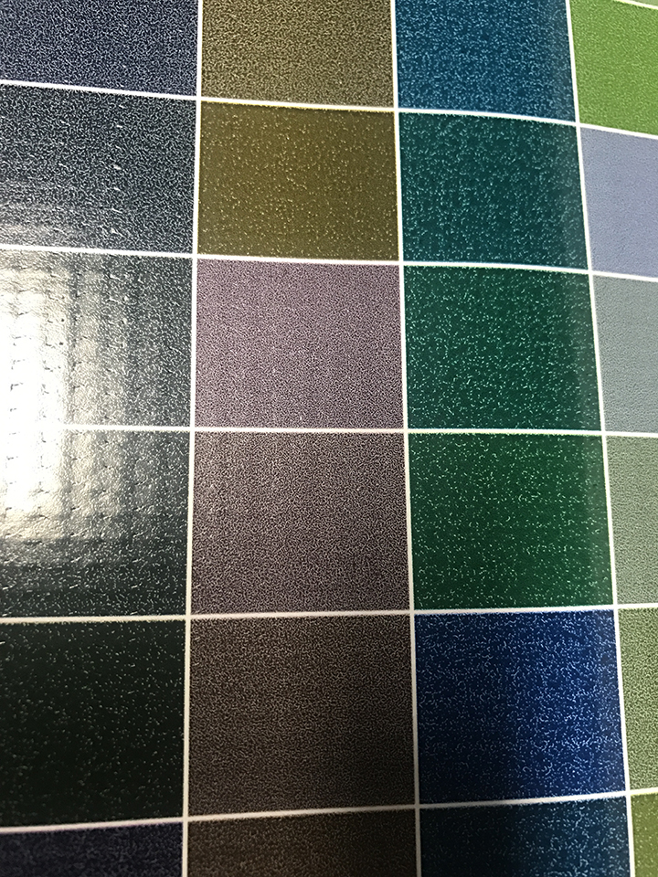

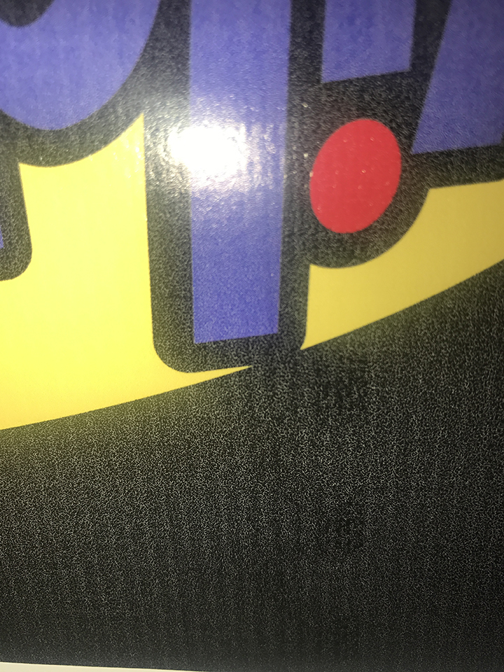

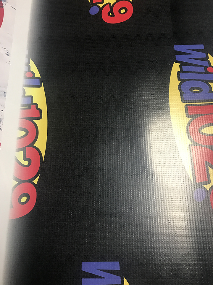

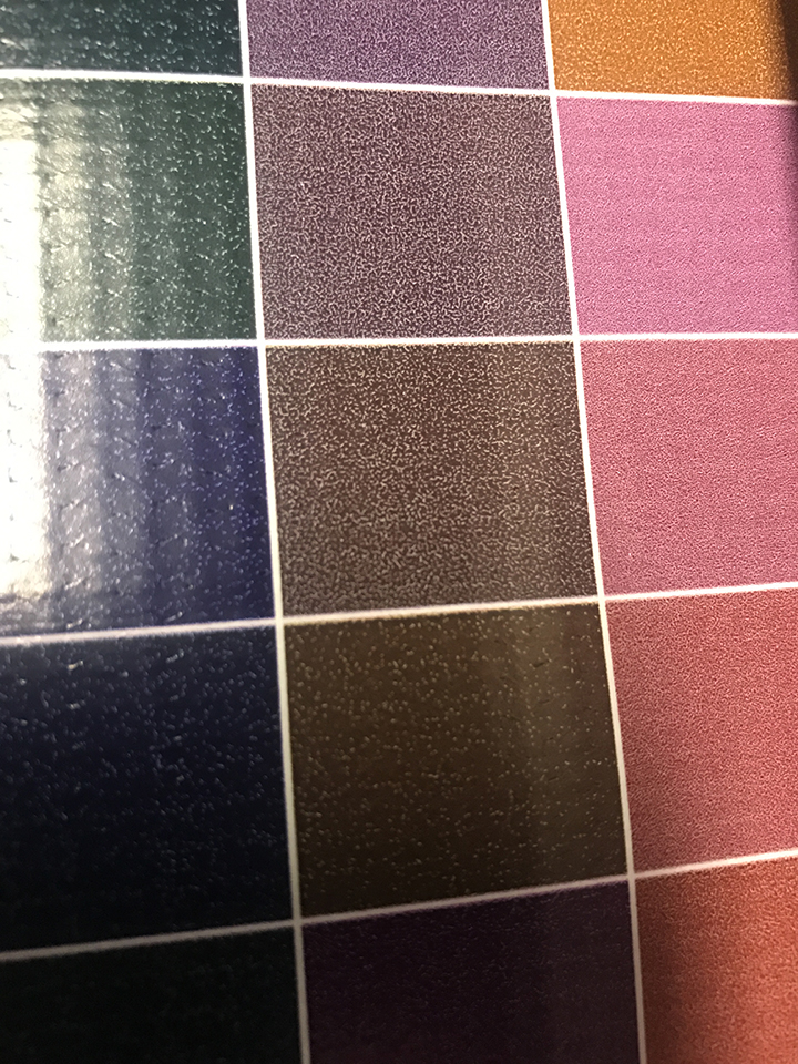

So I have ran into an issue with my Latex 360. My company purchased this printer in late July of last year. We bought various size 13oz vinyl substrates (38", 54", & 63") around that same time. Since then I've mainly used the 38" and have re-purchased several rolls. The 54" has been used but still have the initial roll. Two days ago was the first time I've needed to used the 63" roll and I tried printing on it however I get a very grainy image on it. Printing the same image on the 38" and 54" I do not have this issue. What could be causing this problem and what can I do to fix this? Does vinyl substrate expire?

Vinyl banner material does, yes. From what I've read it's the plasticizers coming to the surface of the film and interfering with the ink adhesion. You can clean the material off with isopropyl alcohol before you print, but that's a huge pain and you'll probably have spots that you miss and have bad image quality in those areas..

So the issue is the banner material that your using. Like Xtreme said about the plasticizers coming to the surface will cause this. HP actually makes a roller that goes on their machines that fixes this issue. It's basically a foam covered bar that pushes the plasticizers back down before it goes through the printer. It might be available for your model.
