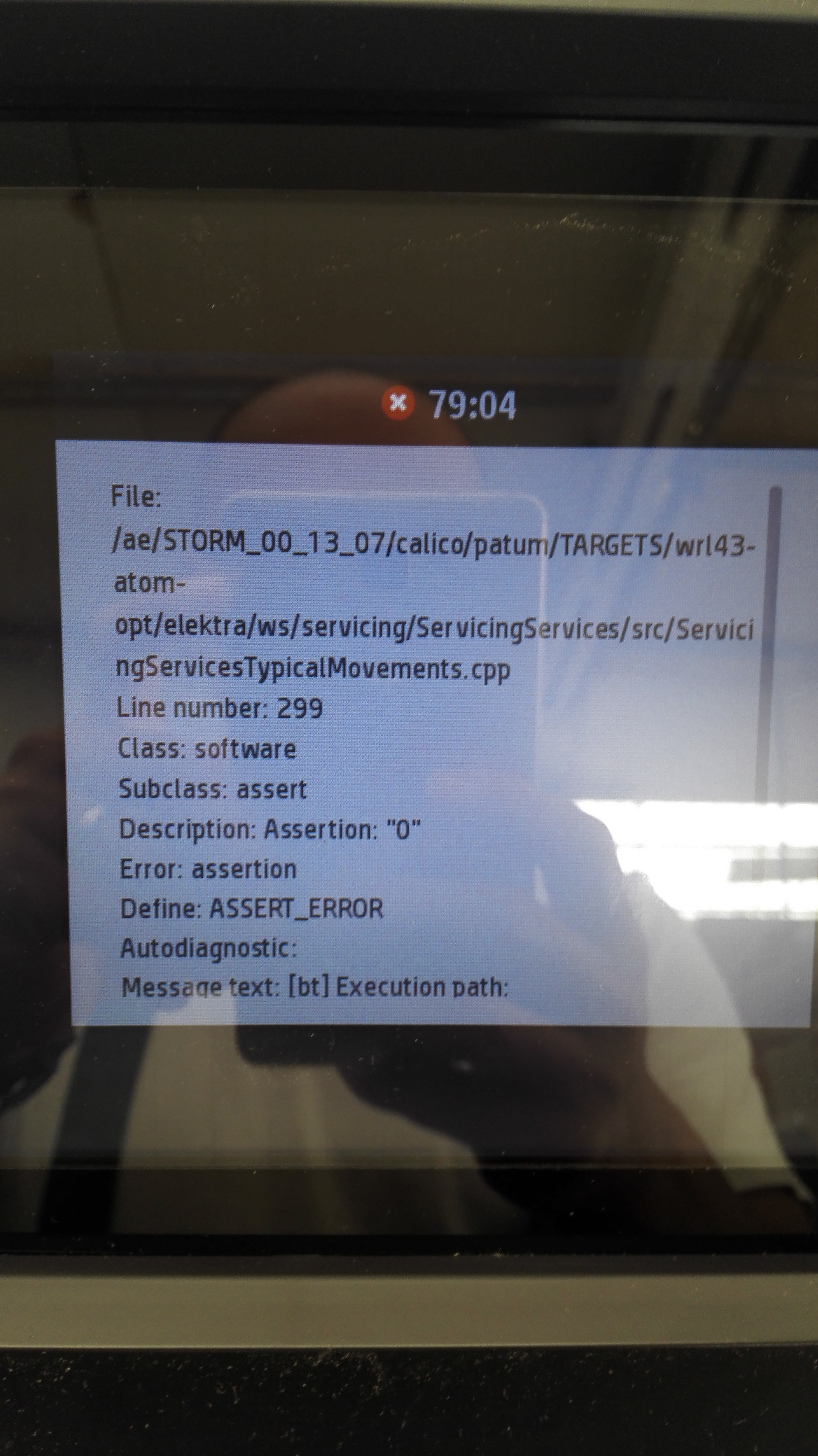

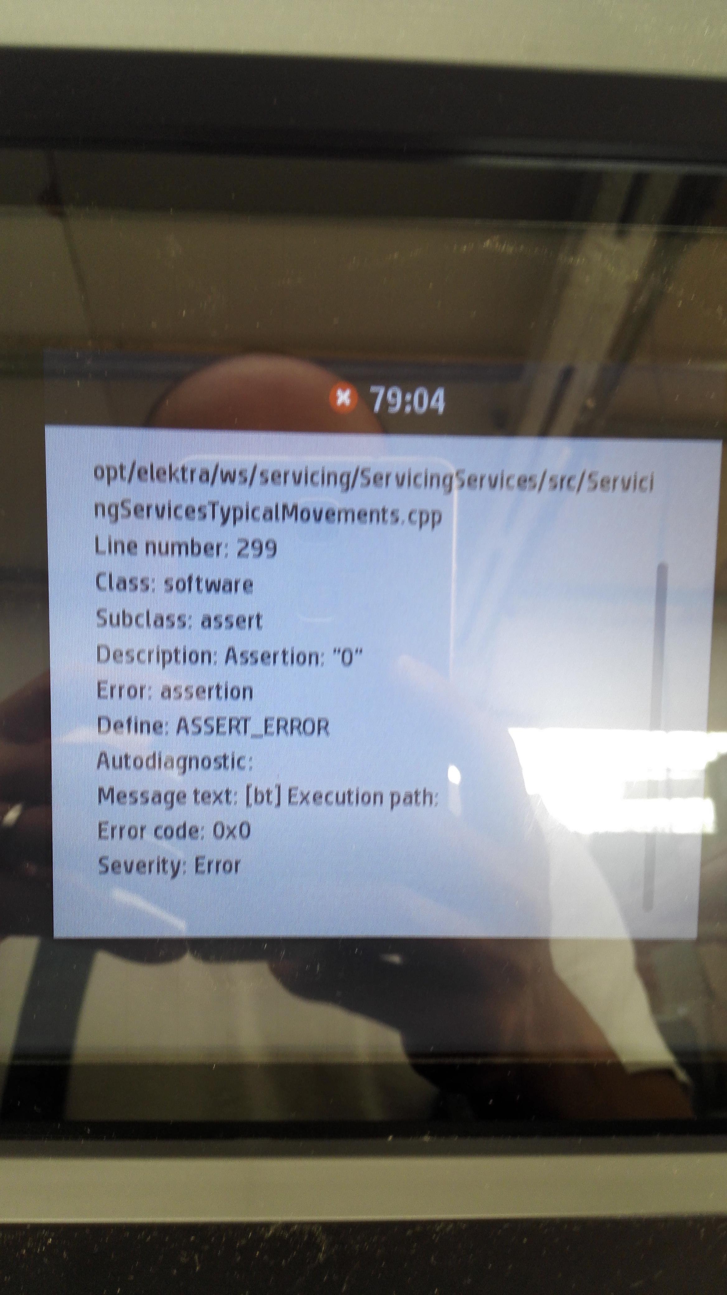

I have a lot of 79:04 errors since last month, it sounds like something wrong with the maintenance tank, something is stretching the printhead carriage during the printing, then printer stop and error reports. I have tried to replace new maintenance tank, no luck.
The printing is ok when it works, just I don't know when it will stop during the job.
one post @ HP Latex Knowledge Center suggests to replace the SSD.
Any suggestion please.
Thanks in advance.

The error happened when the carriage moved back to right, and the maintenance wiped the printhead, there was a loud sound from the right part of the printer, like a paper jam, but I didn't find any debris in the way of carriage.
The firmware STORM_00_13_07.1 was installed 12-2021, it worked well until last month.
The only error is 79:04.
