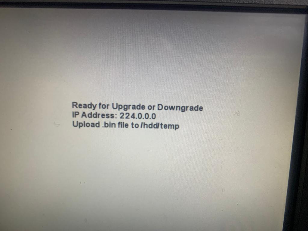

Update: Technicians thought they had it figured, installed the components and the machine booted up until this message. HP feedback then said we need firmware v4.07
