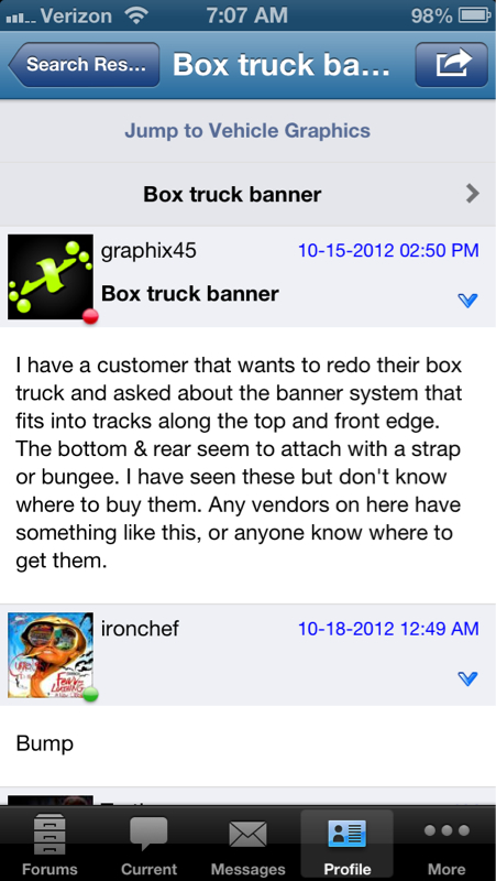

Ironchef...Do you know what the heading would be on your posts? I looked at a list of all the posts you have started and did not see anything.
ironchef
Sorry i didnt start the post i bumped it so i could find it later, lol

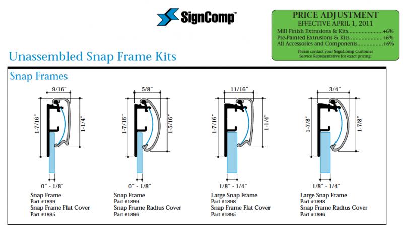

I like the sign comp extrusions for sliding panels in/out, like jill posted.
also a cool idea, is sign comp's "snap frame" that can be used for banners as well.
edited: buuuut I like Lightning's video post, suggesting the sign comp wall mount tension frame that we use for our oversized illuminated pylon signage... as it will most likely resist the elements, while driving on the road, better than my suggested snap frame kit.
