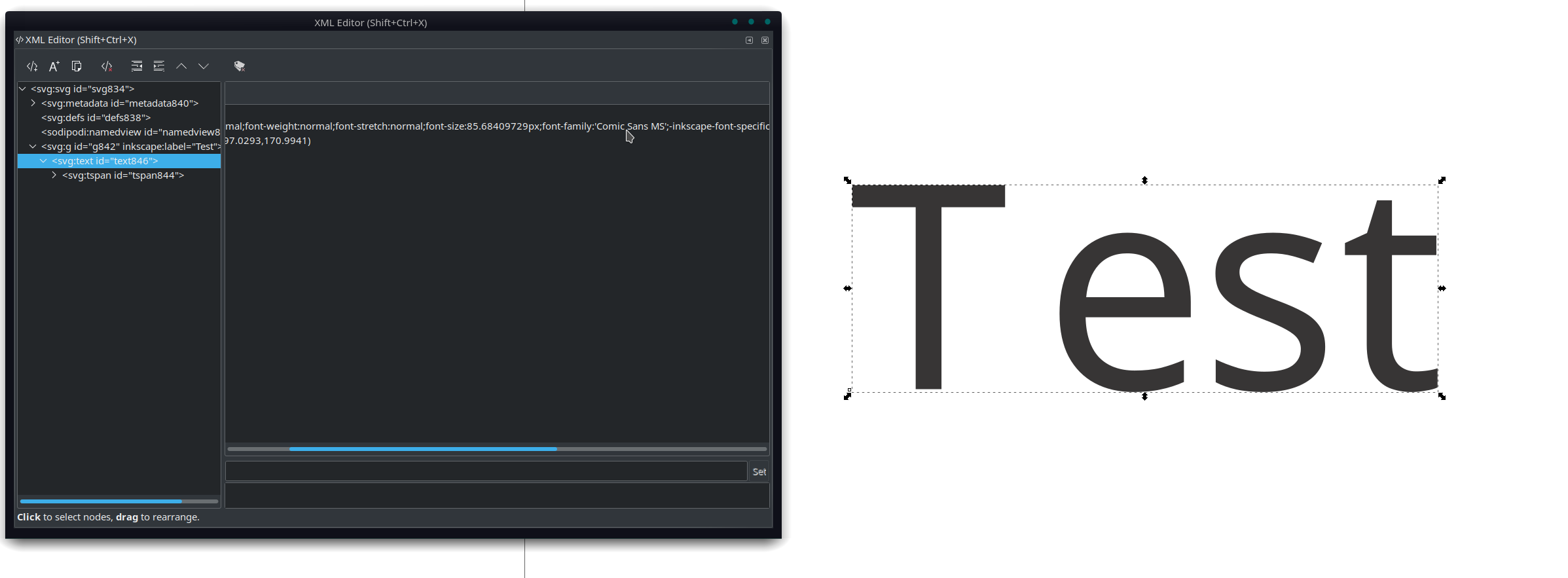

Interesting thing about the XML Editor, even if there is a font substitution that goes on. It still shows the original font family in the editor itself. Now it doesn't show the font on the canvas itself as the legitimate font. You'll see it in the PDF preview on import (although there is no warning about font substitution going to happen, just an option to tick if you want substitution to happen when it is necessary), but it won't bring it in on the canvas after import. But Inkscape should be able to "see" the font.
Now, with it not being able to bring it to the canvas even with PDF compatibility (which I always have to on, never really changed the default), I would say is a limitation of the software.
I used Comic Sans (I thought all y'all would like that) in an Ai file in my Windows VM. Inkscape on Linux was used to open it up(I used a font that I know wouldn't be on my Linux box) and as you can tell, the text that appears on the canvas is not the font family name listed in the XML editor (I have the cursor in the screen shot over the appropriate area). Now, I don't know if that will work on the CC specific fonts as I don't have Adobe CC to try that out.
The XML Editor is a powerful feature. Use it or don't, that's up to you.
Of course, could always see about copying the file. Renaming the copy as whateverFilename.txt and then opening it up in a text editor and search for Font and should be able to see that info just as well, but a little longer of a process.
